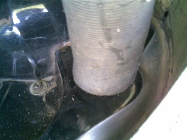

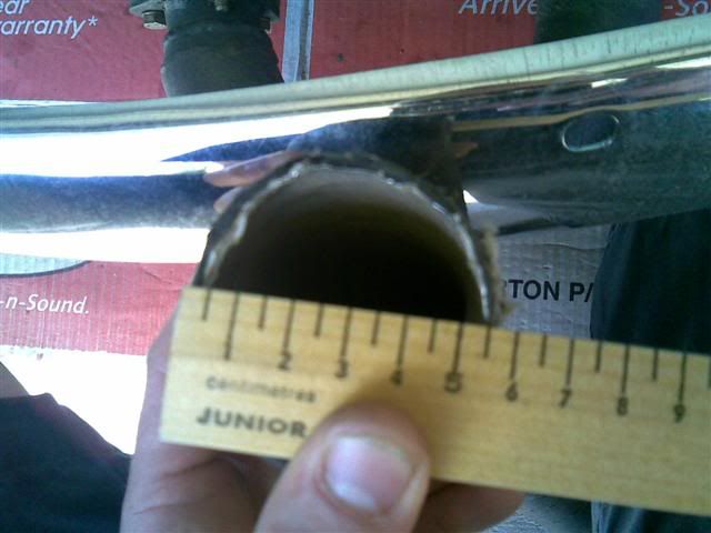

oorkay, od of factory heater tube ducting is 55mm (but was there a rubber seal too??), ya got at least 88mm (if not up to 92mm ish)of area to work with on the tinwear before interference or fouling from edge lip, curves etc.........
not terribly accurate measurements, but sounds like your ready to get on with the task at hand, depending wgat you have access to at your stash location, might be able to grind it down on location........

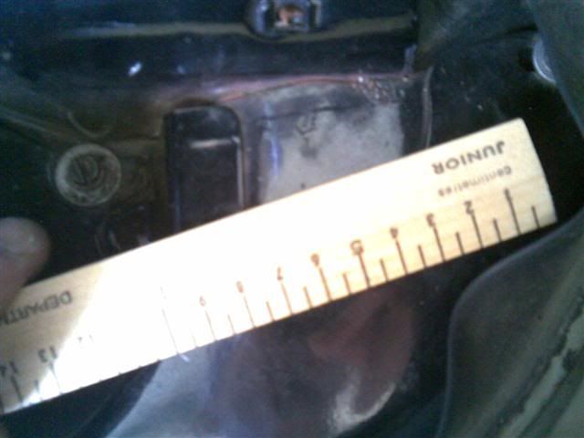

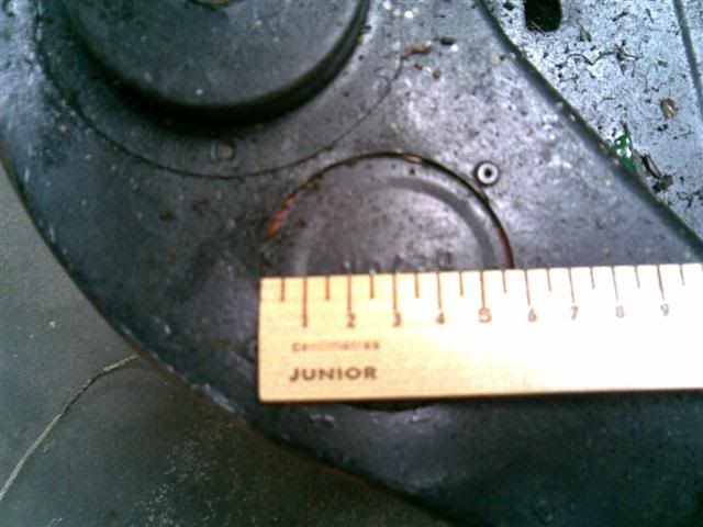

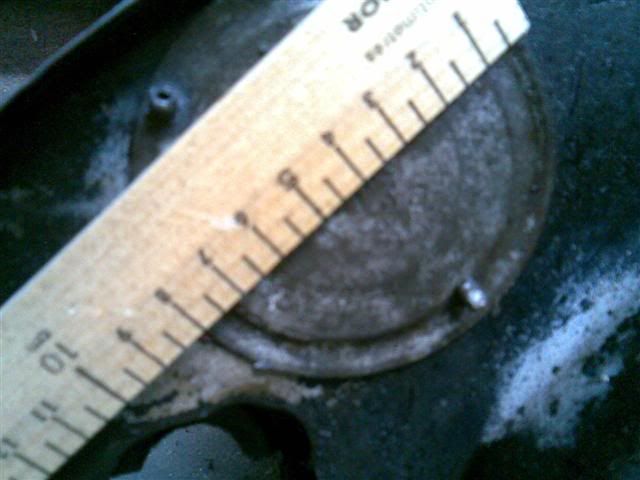

too funny, mission complete...........yeah holes 60mm, clearence for up to 90mm will get em covered, but not foul........

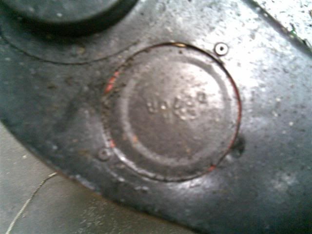

yeah, always nice to mingle with VW peoples..........be nice to shove "bugsmoney" in fifth gear and sit back for a few hours..............maybe Luke in the EFI dual cab split and Uncle with 2L hotty bay kombi........if i come, i'll be changing venturies and jets to the biggens and shooting for over 100HP, could probably live with the bigger ones daily now with the close ratios of the five speed anyhows
at home, guessing........
http://i31.photobucket.com/albums/c365/dumone/20012009001Small.jpg
http://i31.photobucket.com/albums/c365/dumone/20012009Small.jpg
http://i31.photobucket.com/albums/c365/dumone/20012009002Small.jpg
on a mission!!!.......she loves being able to see straight out the front at the oncoming traffic........go the beetle!
http://i31.photobucket.com/albums/c365/dumone/20012009003Small.jpg

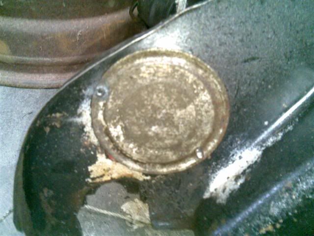

sexy tin lids, spwein i musta decided to paint over them at some stage........i would like to reccomend SPC 425g pineapple thins for this job:dork:
http://i31.photobucket.com/albums/c365/dumone/20012009004Small.jpg
http://i31.photobucket.com/albums/c365/dumone/20012009007Small.jpg
http://i31.photobucket.com/albums/c365/dumone/20012009005Small.jpg
http://i31.photobucket.com/albums/c365/dumone/20012009006Small.jpg

haha, thats funny - i like the way you can see the print.

yeah, i was always dissapointed i didn't turn that one around so the print was lined up better..........must have done that side first because the other side was turned:lol:..........i had made an effort to line up the rivets the same on both sides tho.......oh dear, always in a hurry when i was young!:rolleyes:
