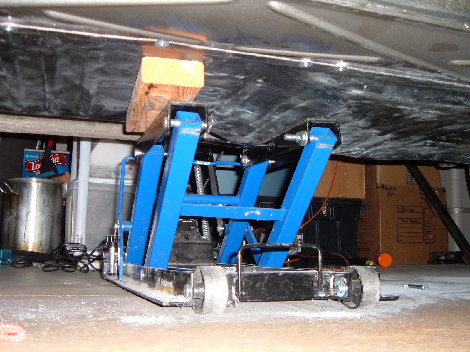

sgetty 路
Something like this would be nice for moving it around the shed
http://1.bp.blogspot.com/_jAB6tEsYpl0/TTTfrZzX2sI/AAAAAAAAAE0/znws_PEW9uE/s1600/DSCF1661.JPG
