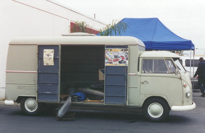

HotRodMatt ·
How about getting one of these?
jenz58 ·
Can u get me one??😉
