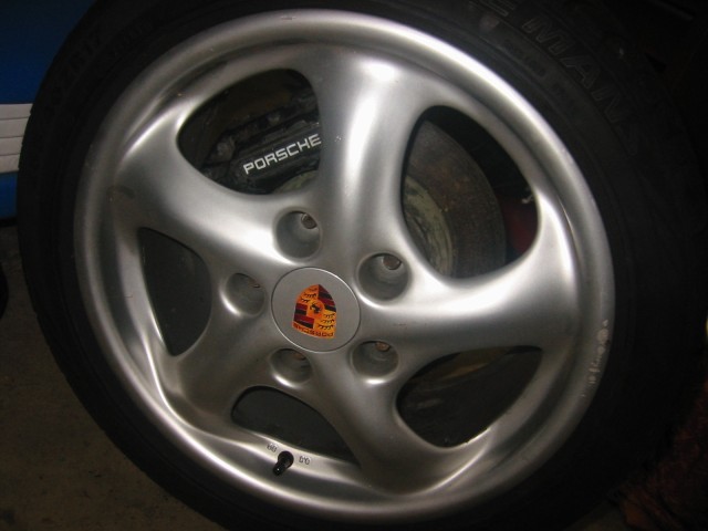

I just put some Porsche turbo brembo calipers and Porsche wheels on my 61 Karmann beetle cabrio. They are the biz!
[Edited on 17-5-2005 by matara]
57kombi ·
That does look NICE.
Dave
