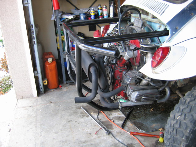

droopz ·
Well here are some pics of the cage at the meoment. Like I said, the top of it goes out further than I really wanted. So im going to cut and shorten the top horizontal bar so its much closer to the top of the engine and then angle the vertical bars forward to meet it.
Anyway, here what it looks like ATM without the engine cover...

Well after a bit more dicussion and pointing and measuring, we've decided it just sticks out too far. 🙁 Another member here (Secoh) also pointed out that the departure angle is wrong and that its gonna scrape a fair bit.
So tonight im cutting the extractors off so i can shorten the whole cage and bring it all back in towards the motor. Then ill eventually make up some side-mounted exhausts.
helterskelter400 ·
great idea.
cannons have headers that go around the side of the head, not under and you can bring the barwork right in tight so you have a great departure angle. my barwork could have been tighter still if i didnt have to clear the external oil filter.
do a search, theres been heaps of talk and pics on cannons, 4-1 exhausts and rear barwork..
Anthiron ·
yeah man that departure angle is terrible.
some people bag cannons but u can get such a better angle without anything hanging over the back.
droopz ·
Well the new and improved cage is mostly done. A few more tweaks here and there and i still need to add some mounts for lights and mudflaps and fit the mesh to cover the hot bits, skit plate etc... but its definatly better than the old setup. Sorry about the blurry pics.
I would have liked to go even tighter again, ut then the ends of the extractors would be exposed.
The best part is the whole setup comes off in 30secs and weights bugger all.
