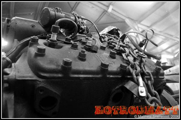

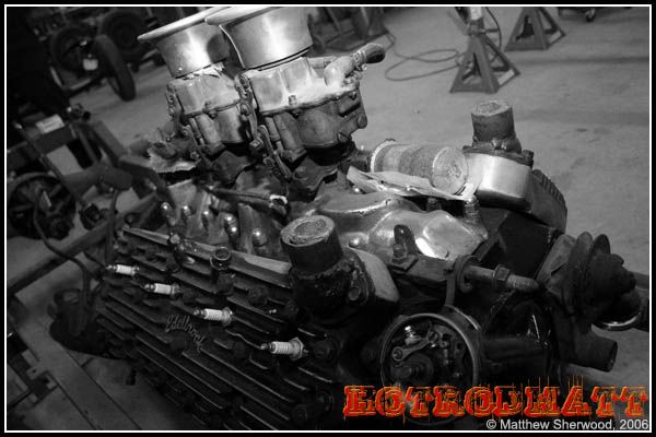

Test firing engines on the floor!
Surely that isn't Ezio Cacciotti forgoing a bowtie for a blue oval?
Both Ezio and Nick's engines proved to be runners (even if Nick's required half a dozen fingers covering manifold leaks)
Joe's engine will need a bit more work...

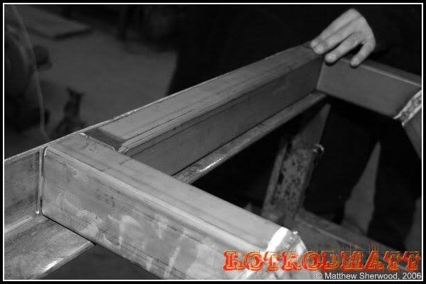

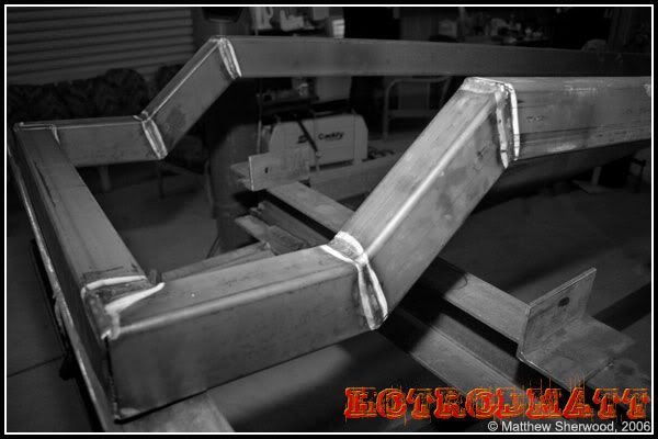

It doesn't look like much has been done (other than emptying Jim Beam cans) but all the rails have been stitched together and the front and rear ends are nearing final mounting.

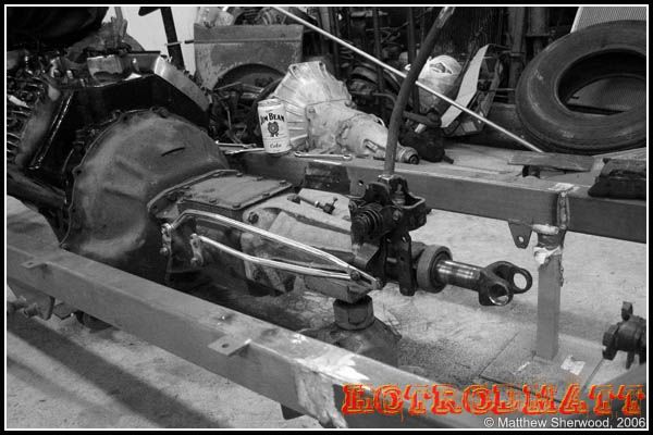

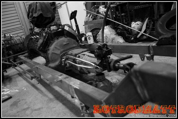

Adapting the top loader for the early flathead.
The concession on non-period diffs is appreciated...

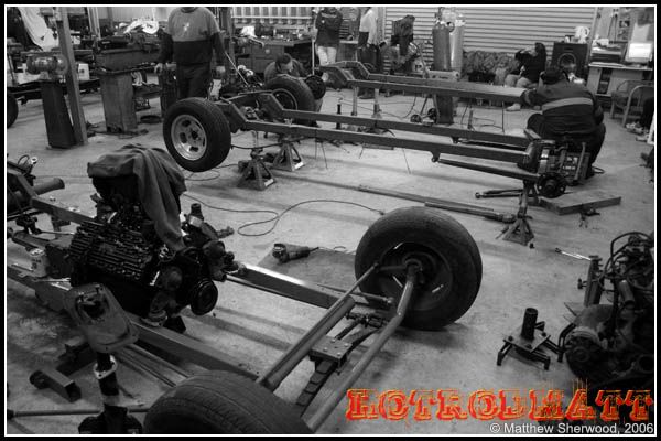

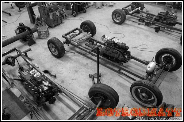

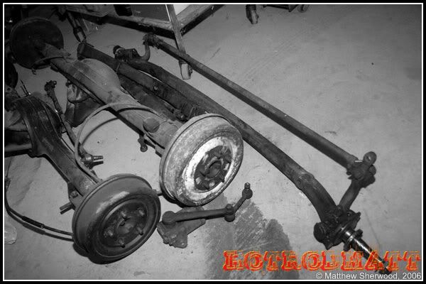

Well there's some advancement now. Axles and diffs in place, even a couple of wheels on.
Three will roll out to make room for another two to get rolling in the next couple of weeks.
Of course, Mr Beam's finest yet again makes an appearance.

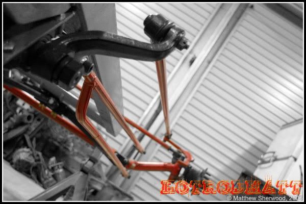

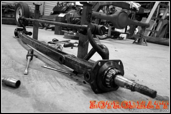

You just gotta love the castor adjustment!

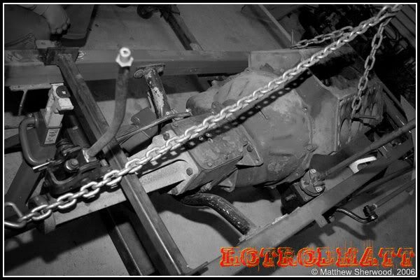

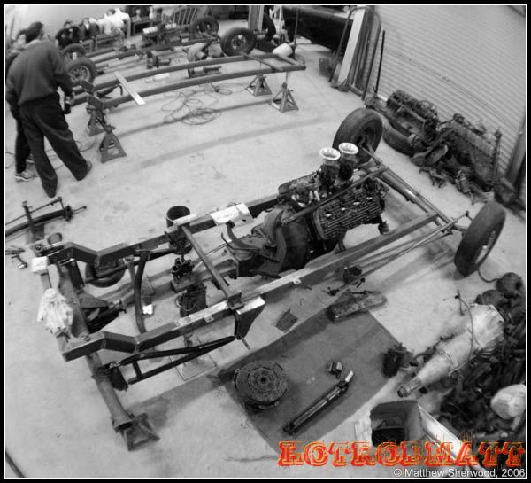

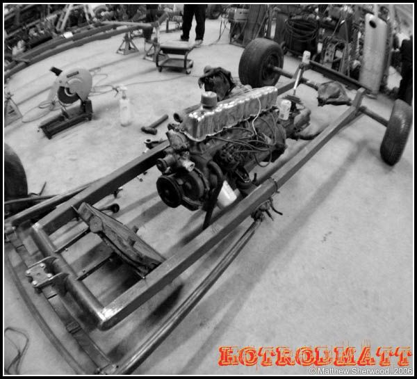

The production line now sees 3 cars rolling, with engines and gearboxes mounted.
A few shifters are attached and a few other trinkets are beginning to appear
on those not long ago bare bones.
Naturally a few JBs were sunk...
Followed by some precision work
James instructed Jack on the use of the Mr Gasket shifter on the toploader

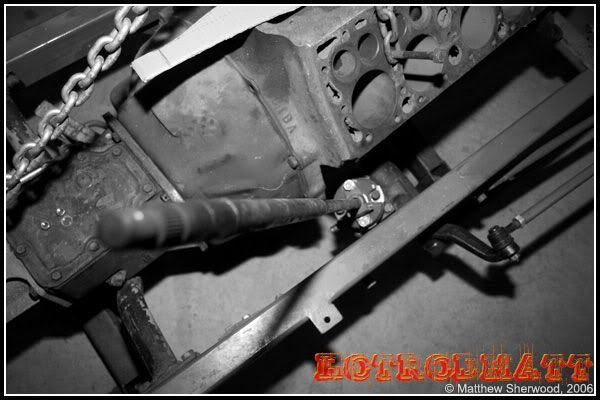

The HAMBsters continue to progress. Driveshafts and driveshaft containment systems are being developed.
Another front end is about to be mounted to the chassis. Engine and transmission placement are largely complete in the rollers.
Another set split...
Isn't this the essence of hotrodding? If what you have doesn't fit use what everelse you having lying around?
May not hold up to much abuse, even with the Corona balancing...

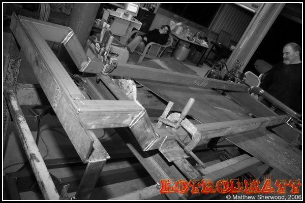

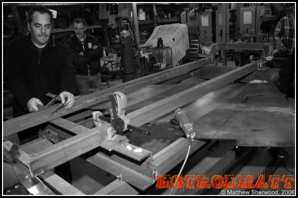

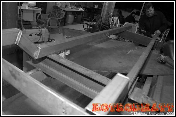

Can you believe it? The chassis jig is in use again. That makes 10!
Add to that the 2 promised from Canberra and there's a field of 12 already.

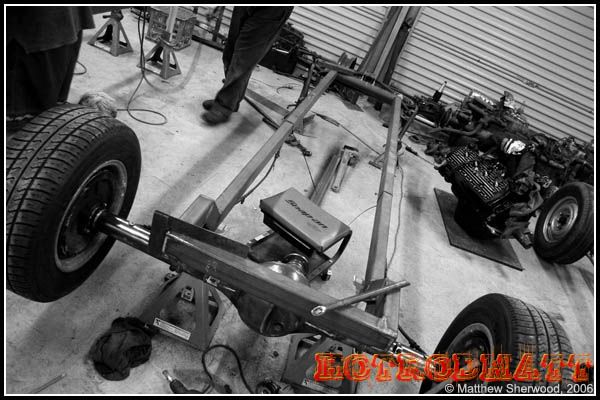

With Nick's engine and box in the rails it's time to fabricate the suspended
rear end.

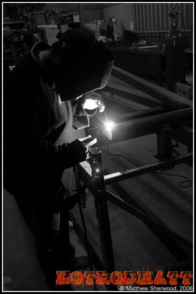

The ladies are always helpful, not only do they cook, crochet and knit you would
have recognised Debbie above TIG welding a chassis!
What is it they say about 90% inspiration and 10% perspiration...

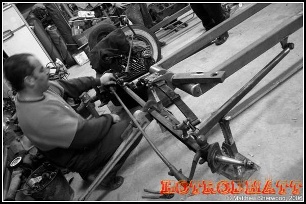

Continuation on the suspension for Nick's car.
Joseph has the shift and noise pedals sorted... what about a brake pedal? We don't need no stinkin' brakes.
Of course the kids had some fun too.
Jack supervising the installation and positioning of Nick's ladder bars.
