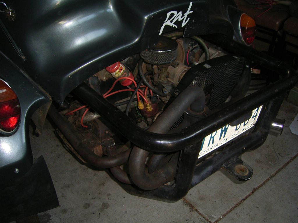

beetle from hell ·
Mine is as such...
Welded to the lower bar

thanks beetle
sorry to be a pain you dont have a closer view of it
neil

beetle from hell ·
This is the closest i have got on hand. If you want closer i can take a pic this weekend

beetle from hell ·
Thats a pretty nice setup. Might have to consider a change over.
Personallythe only thing i have towed is a 6x4 with sides and a few bits and peices in it. Only a few km.
It came with the car so not sure how much towing the PO did. And i dont believe the cage is anchored enough to support towing much weight.
