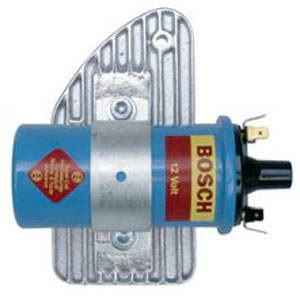

I use the one in the lower pic, puts the coil out of the way between the fuel pump and fan housing on top of the engine case, very secure and the stock wiring and plug leads all work. Cleans up the engine bay as you hardly notice it's there.

From the top mount to the engine block mount, I changed to a higher output ignition system using a T coil and module, but you get the idea.
