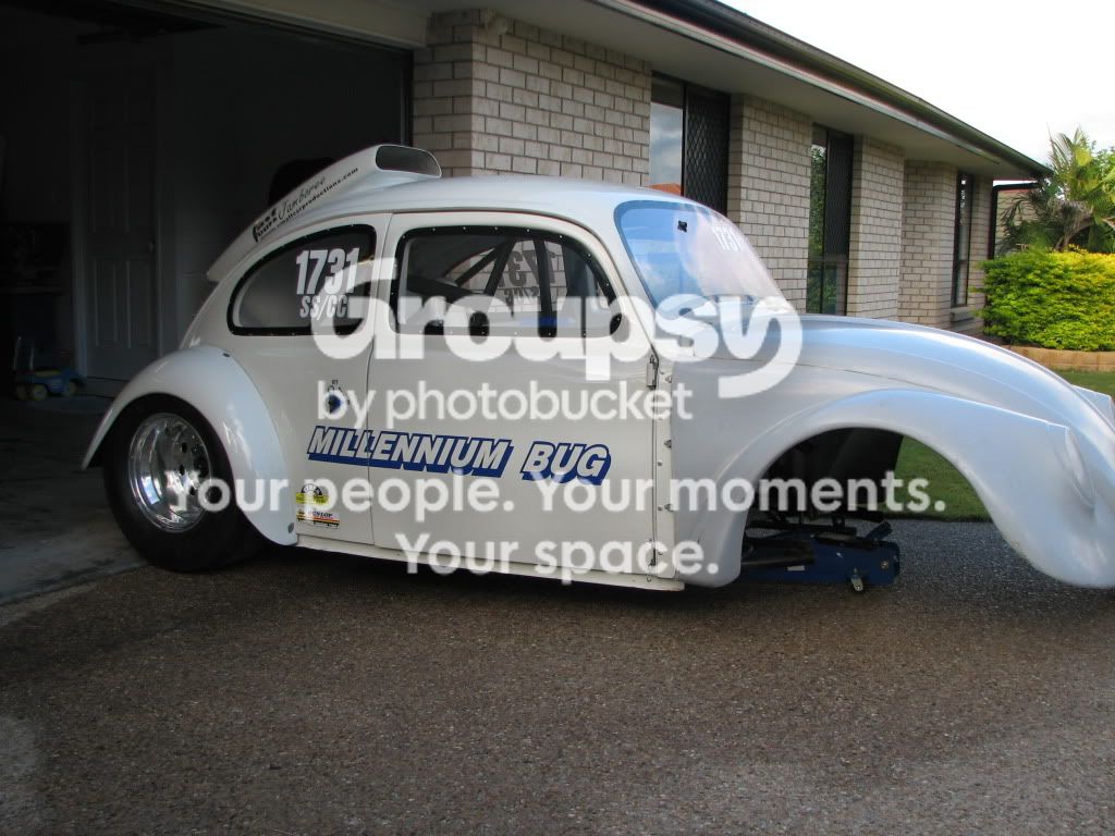

here are some pics of my new project [IMG]
typethreeking ·
this was dave bultlers old car which i purchased from rod richardson
typethreeking ·
ket.com/albums/uu310/type3king/IMG_3119.jpg[/IMG]
typethreeking ·
typethreeking ·
now i need to start the job of rebuilding the front of the car and get it back on its wheels.

WOW!
Scrubs up pretty good dude.
No more toad skeletons found in there?
typethreeking ·
i think i will get brennden to hit it with the buff, heaps of crap and over spray on there but should come off. The tin work inside cleans up well, just need some longer self tappers to fix that rear panel in place. i did fine a few hornets nest in there !!!

Wow that looks cool. I think you should change those rear boots though for some wider ones just to make sure you have enough traction!!!
Doesn't look like there is too much to finish it off, will be awesome when its on the track.
You would be well into the tens with this wouldn't you?
dangerous ·
Those tyres are 11.5" tread by 28" tall.
13" across the side wall on 10" rims.

and were trimmed🤪 out to clear a 28" x 10" slick that I used
when the engine was supercharged.
"tested to 147mph!"😂
Sounds good to me, they look like you widened them again from original?
well at least i can say i have fast lights now 😂
on a more thread specifi note, why is the rear of the interior boxed in so much? what needs/needed THAT much space?

typethreeking ·
typethreeking ·
typethreeking ·

typethreeking ·
typethreeking ·
typethreeking ·
the above pics are of the beginning of the lower bar work now i have the front wheels and can work out the height to fit the front beam in the car, the other pic is of the front beam clamps that peter page and i made over the weekend, even though we arent quite finished all 4 of them yet, thanks for the help pete.
typethreeking ·
typethreeking ·
typethreeking ·

dangerous ·
Found these from 2002!!
dangerous ·
Here are some links to is past:
http://forums.aussieveedubbers.com/viewtopic.php?tid=47146
http://forums.aussieveedubbers.com/viewtopic.php?tid=46915&page=1

Well it's time to finally finish my car, front end has all been rebuilt thanks to dangerous, just need to assembly it, and just waiting on parts now and put everything together and running for the dyno hopefully next month if possible

new windows fitted

rear scoop brackets getting finished, rear brake lines also done tonight

Well it finally lives, now for a few small jobs before the dyno
