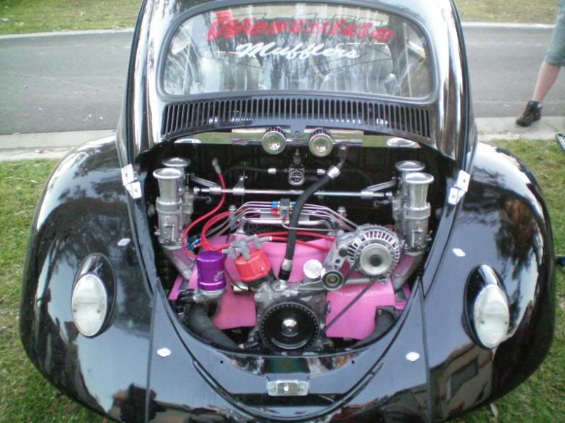

STOCK ·
HI MATE
GIVE BRAD (WESTI) A CALL
HE CAN SELL YOU A KIT LIKE THIS WE USED TO RUN ON THE JUNKA BEFORE GOING TO METHANOL

bugzla ·
dont those fan setups like westies suck alot of juice for a street car and how do the motors run on the electric fan pretty hot id say
whathaveidone ·
got one of westies setups on my car, having trouble getting up to temp. i dont run an alternator and the thermo dosent draw to much, with a decent alt or gen you should have no probs
