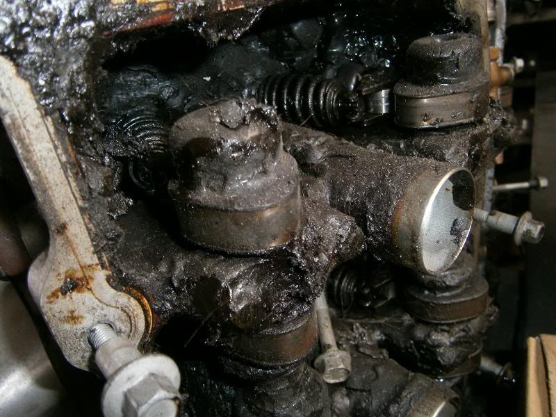

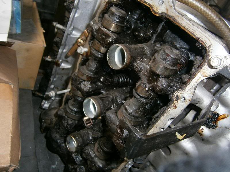

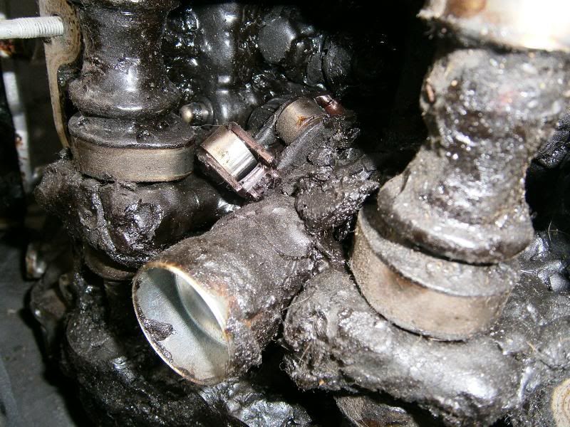

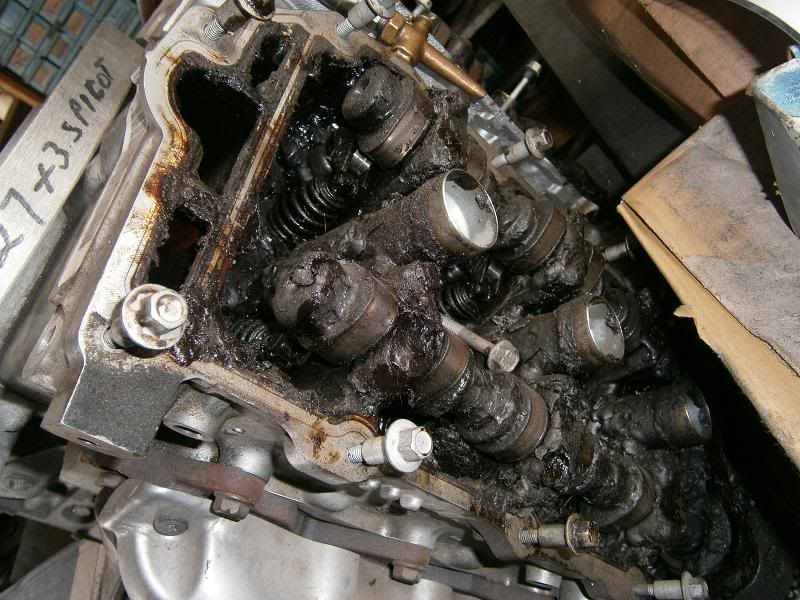

Naturally he needed a engine to mock it up with and the one he's got is a classic example of the dumbass oblivious modern driver with more dollars than sense.
It's out of a 2007 VE Commodore and the guy that owned the car bought it and never once changed the oil!
Just drove it till it died.
By the looks the timing chain let go.
I've seen some pretty neglected engines before including that E46 BMW driven for 100,000kms with no oil change -
http://forums.bimmerforums.com/forum/showthread.php?s=a280632a5fe4d905e6834fdb8c77cdd5&t=1281659
But this one was something else.
It doesn't look so bad from the bottom with the sump off, just little bit sludgy.
But it's under the rocker covers you can really see the carnage.
Bear in mind this is only a 4 year old engine, exact KMs unknown but apparently it wasn't high.
Looking closely it's like someone took a container of grease, added a few cups of dirt and went to town.
Oil is cheap, much cheaper than engines, I don't get some peoples logic.
