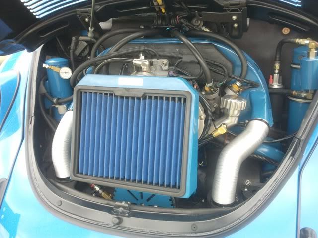

Is this the one?
I don't know the guy's name but I think he was from Toowoomba and I think he is using Camira injectors.

Saw this when David came around to my place and he lives in the same suburb.
It's an amazing car with what he has done!
It has every known electrical device installed known to man in it!🤪

Thanks Gracey thats the one, i wanted to know the injectors he used as experimenting with Megasquirt on a single port with asperations of putting onto a dual later. just want to make some easy housings out of single port end castings. the dual will be using CB IDA intakes with injectors.
Any idea of Camira model just to save me a little searching????

Ampdub61 wrote:Thanks Gracey thats the one, i wanted to know the injectors he used as experimenting with Megasquirt on a single port with asperations of putting onto a dual later. just want to make some easy housings out of single port end castings. the dual will be using CB IDA intakes with injectors.
'The injectors were from the 1.8 Camira or Nissan Pulsar (but any injected Camira will do - 1.8 or 2.0). Holden supplied engines to Nissan back in the late 80's early 90's. They only flow around180cc or 16.4lbs so are only good for around 90-100hp (with 4 injectors). They are around 16 ohm and are the pig-tail hose style. "
If you want more info, David can send you pics etc.
