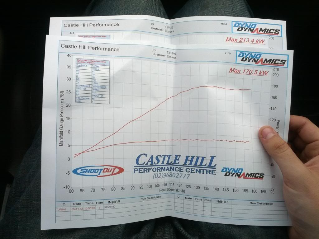

Update, finally got the my sons Skyline running after many issues. Just got it back from the dyno but it lifted the head, this is a high comp 300,000 k + motor with a worked head and lumpy NA cam.
Westy did an excellent job of the exhaust and intercooling pipework
So we just fitted Permaseal MLS-R and ARP Head studs and now hes off to run a drift called Matsuri at Wakefield this weekend.
It did 2 runs on the dyno, one at 7 psi and one at 12 psi.
