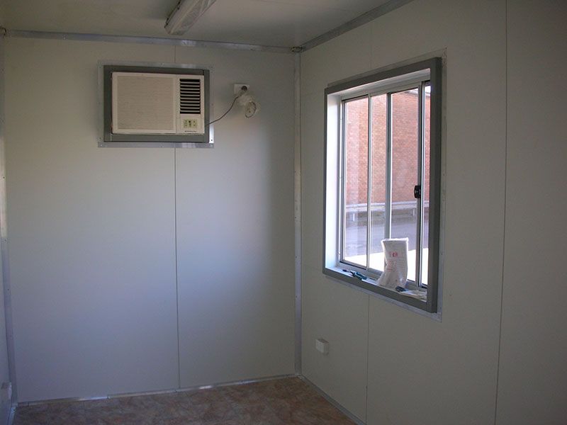

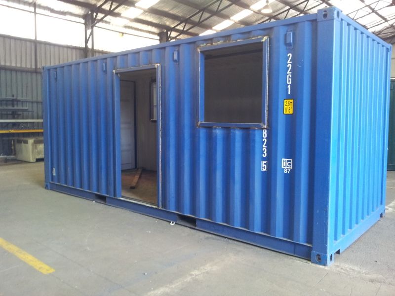

refrigeration panels..
i do container offices etc with them.. nothing comes close! 🙂

esevwbits wrote:refrigeration panels..
thats awesome, me wants
