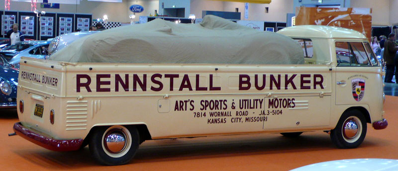

r0880 - November 1st, 2013 at 11:57 PM
How about carrying on the back?
http://www.classiccult.com/images/bug-show-spa-2013-08-03-080844-788x525.jpg
http://1.bp.blogspot.com/_i_AovfzNXgQ/TRv3HrttvZI/AAAAAAABZ-U/B8Ppkuow-oc/s1600/3067903669_e225b8d6d5_o.jpg
pfillery - November 2nd, 2013 at 06:40 AM
Not enough length or width is the main reason.
Can't carry a kombi on the back of a kombi. Plus still need 5 seats. Nice idea though.
