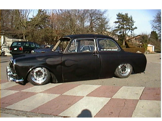

typ-fre - January 14th, 2004 at 10:22 AM
heres a pic of ABS on a bus
lol
dom
Unity-28 - January 14th, 2004 at 10:23 AM
Dom, you gotta learn a few things about bags first. I have a kit for the bug, type three is different set up at the front. the only guy that has made some is Bert in belgium (i think) Daniel, you would need a full custom front beam for the bus, as having all your weight on the shock mount is not advisable. Obviosly the rear of a type 3 and a bug are the same, so the bug erar kits will work, but the front is a totally different story. Sleds might be heavy, but the have A arm front suspension, so a little stronger, and also they are all rebuilt usually with the chassis z framed, and the like....Air Suspension is not as easy as it sounds....

Unity-28 - January 14th, 2004 at 10:26 AM
As for that pic, That there is not "bolt on". Firstly you would have to IRS your bus, and then make new Upper shock and Bag mounts. And that is just the start.

Unity-28 - January 14th, 2004 at 10:46 AM
total custom install. lots of modifying the front beam and a lot of money...
http://www.thesamba.com/vw/gallery/pix/132247.jpg
http://www.thesamba.com/vw/gallery/index.mv?photo+16369.jpg
That is a notch thats bagged. Maybe email the guy and ask what he did...

Unity-28 - January 14th, 2004 at 10:58 AM
Both are pics of bagged type 3's. http://www.thesamba.com
look in gallery, do a search for bags, and you will see these. the thumbnails have links to their email addresses..

Unity-28 - January 14th, 2004 at 11:34 AM
Thats a karmann ghia...same as bug front end.

Unity-28 - January 14th, 2004 at 11:59 AM
Cause My Name Is Nectar! And if youve got a type 3, the beams are totally different to a type 1 beam...
That there set up also isnt your bolt on type. That would cost you quite a bit in fabrication.
