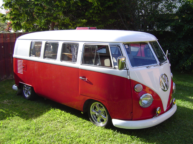

Hey guys, how low can you go with a kombi ?
We just did a few and most ended up ar around 250mm under the front. Down about 200 mm from where they started. Just wondering how much lower we can go before we get issues.

with my last bay that was lowered around the same or alittle less than yours ,i wanted it lower and was told i would need to modify the bump stops .
your bus looks like it almost needs tubing
Brad - November 28th, 2004 at 08:38 PM
to get to that height we cut the rear stop rubbers and used adjustable front stops and torsion adjusters from Kimm at Indian Automotive.

Dragbug, the floor below the front seats on a kombi is roughly level with the bottom of the door, gives you an idea how much (or how little) travel that one has!

It gets bumpier the lower you go, but a good set of shortened shocks does wonders for the ride quality. And if you play with the adjusters you can smooth out the ride a bit.

Do you mind mentioning how much the hardware was you needed for that 3 inch or so drop?
Cheers,
Wezley
bigbaja - November 30th, 2004 at 02:36 PM
Harwdware ? Do you mean the adjusters and 8 hours of labour ? If so the adjusters are like $330 retail. Labour is free if you do it your self.
