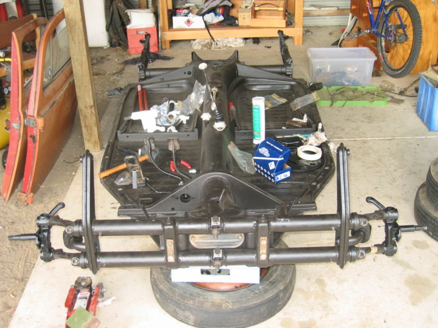

Heres mine anyway.. they're the thingys in the centre of the tubes.
They look crooked but thats just the crap people who made them didnt weld the adjuster bolt plates on straight. They work fine but.
