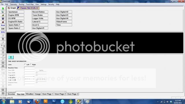

Ben This pic shows the basic channels available in the sportsman Logger Shane has been running and i have just put into mine.
http://i797.photobucket.com/albums/yy257/letterartsigns/RacePakSportsmanDataloggerlayout_zpsf08a232c.jpg
They come with 2 free channels to log things like fuel pressure.
Just make sure you dont install them near anything like a MSD. They get interupted and stop logging when they are too close.
We will be using the Driveshaft censor to monitor clutch slip.
They are very expandable to add chanels down the track. Let us know if you need any other info.
I believe Racepack do a fiber optic cable option to eliminate interference.
Michael Nash has one in his car, (racepack with fiber optic cables)
and despite being 10 year old technology it is an excellent unit,
just a little pricey in comparison these days.
