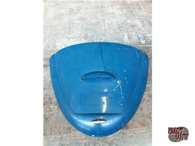

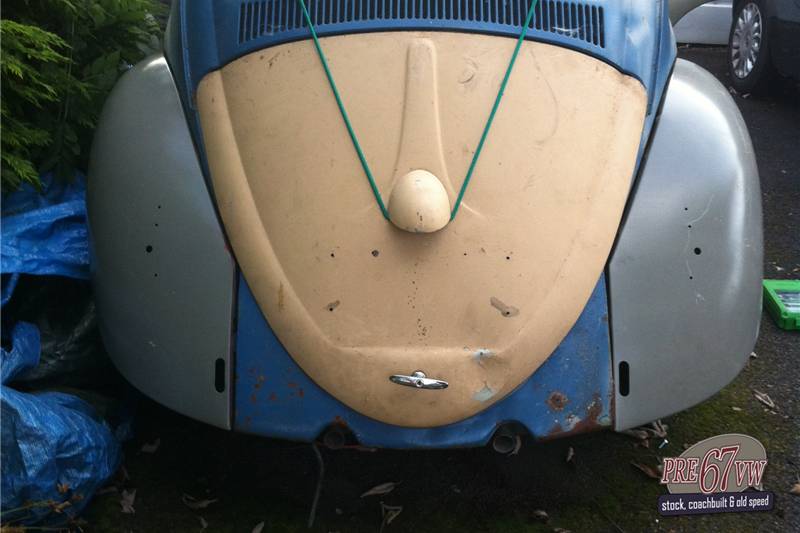

ok, its been playing on my mind the past few days. wondering if anyone has an input to the years from when they first used the engine lid as shown in image 1, i beleive this engine lid was used with the pope nose number plate light only. then the image 2 deck lid i beleive this was first used with the pope nose number plate light then they changed to the wider light but kept the same engine lid like in image 3.
would like to know the years this took place in Australia

I believe the pope nose should have always been fitted to the pic 1 decklid with the fluting/swage line going either side of the nose, semi W.
The letterbox style light housing had the lines stop just above it and hence the second pic has used a later decklid with the holes welded up to use the pope nose. I should know as have done this to mine due to PO fitting a later lid. Probably sold the early lid and nose on :no:
As for years, I think 58 the W lid was redesigned to the semi W. The letterbox light housing came in 64. As to whether the decklid had an 'in between' period from semi-W to the later style but with pope nose I'm unsure.

firstly the blue car has the wrong deck lid..
its from about a 1958 > on
[from 1st august 1957 German factory date]
its wrong for an oval beetle..
the number plate lamp was correct for an oval as it had one piece of flat plastic across the bottom..
for the light lens..
I'll have to check out the middle photo again..
OK the white car looks to be the German 1967 [one year only] beetle as it has the large glass windows which didn't appear in Australia until the 1968 model..
[but were introduced in German beetles from August 1964 [1965 year model] [but the door glass isn't the same as 1968 models.. plus it had round pushbutton door handles]
it has the push button deck lid handle..
Australia 1967 beetles were mostly the same as the 1962 German beetles...
the white deck lid is for a 1964> on beetle with the wide number plate housing
[oddly enough it used the same light underneath as the late narrow housing
[about 1958-63] the tee handle was replaced with the push button one about 1st aug 1966 [1967 year model]

It's really not, just both those cars are bastardized and are not good examples to use.
The decklid on the oval is not an oval one, that is the semi-W decklid used in Aus from when big windows started in late 57 up to early 64.
The white decklid in the bottom pic is what mid 64 to 67 Aussie bugs had except the 66 and 67 had 1300 badges on them and Deluxe or Custom below if that's what they were.
The very last batch of Aus 67s had the T handle replaced with the push button latch like the white car has.
Problem with the white bugs decklid is that originally had a wider light housing and someone has fitted a small popes nose to it.
The whole bug is a late car made to look early.
It's a 69 1200 pov pak model according to the forsale ad

Yes, we'll I have a 63 and it had a wide number plate light, I welded up the holes and put a pope nose on it thinking this was the correct one. I also welded in some cooling vents for my 1600 (1776) that will be going in it.
Not changing it now.... Maybe one day I will.
Pope nose looks better anyway....

Ok top pic (blue oval ) has the incorrect lid it should be a "W"deck lid.
W's would have stopped in April 57 when ovals ceased
57- early 60's will have a popes nose
mid 60>67 had a slightly different (wider license plate light)
68 - 69 12v lid smooth
70-71 12 v lid 2 lots of vents horizontal
and the later the years the more vents...
the early 6volt lids that has the vents were fitted to factory cabrios.
