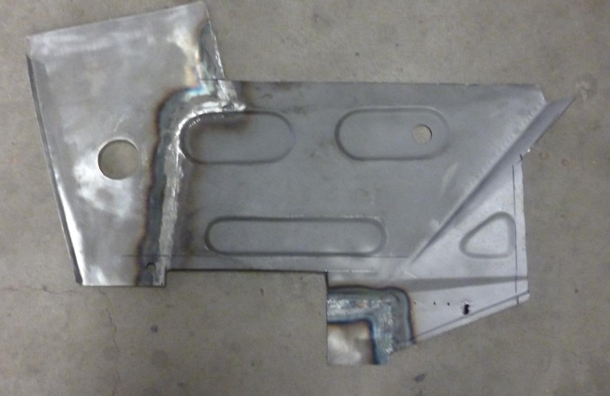

So they cut up T34-3 to use its engine bay, but its rusty, so some hand forming of new metal is required.

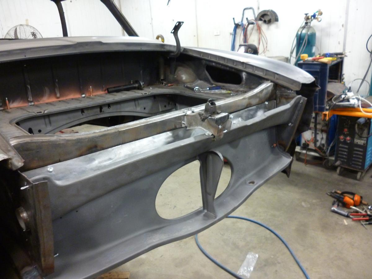

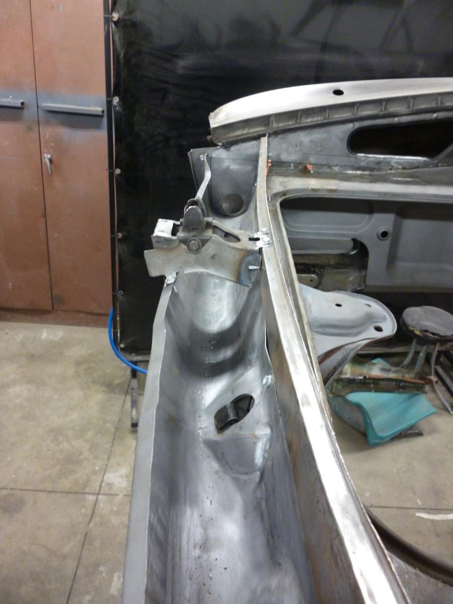

So inner engine bay panels fit, now let's sort out the rear apron / beaver. Unfortunately the rear apron from T34-3 was also in a bad accident and was full of nicky/bog/filler/bondo whatever you ant to call it. So we use a NOS apron I bought and repair the quarter panels.
The quarter panels are repaired by oxy welding in new metal, so it an be dressed up with a hammer and dolly. No MIG welding.
Trial fit, still need to do some more work to the quarter panels.

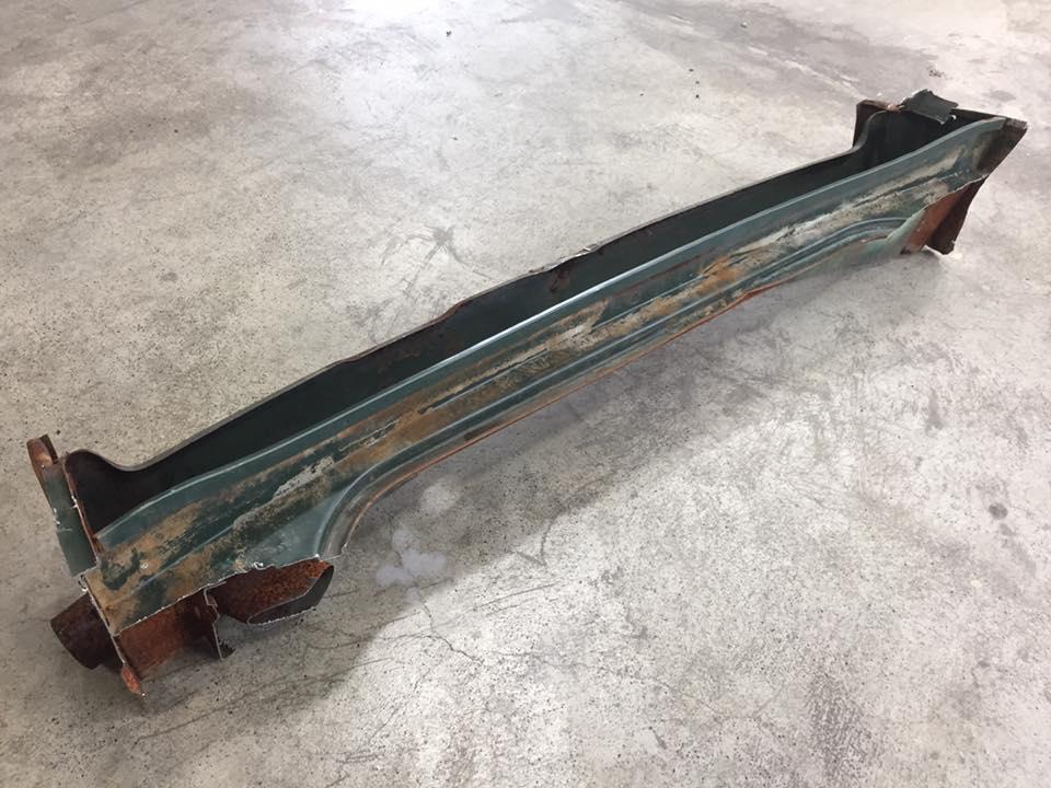

To continue with the fitting of the rear apron I need this rear engine piece, it was removed from the T34-2 body, the one in T34-3 was rusted away, I didn't want to chop up the body of T34-1. So I put the feelers out.

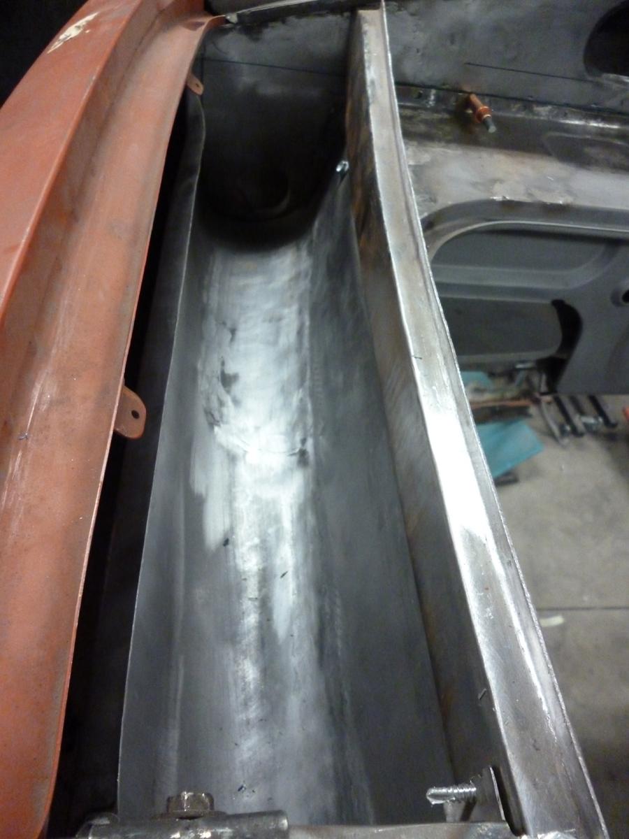

However it still needs some rust repairs and needs to be joined together. So it's all sandblasted, nicely oxy welded together and the rusty area cut out and replaced.

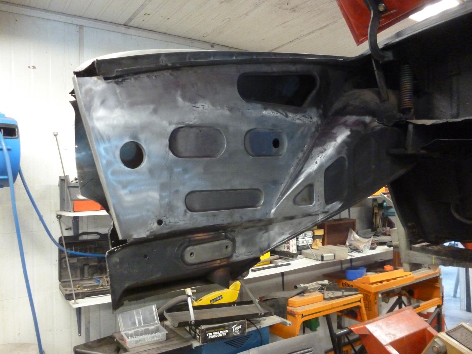

The arse end is finally coming along. All metal, no rust.
