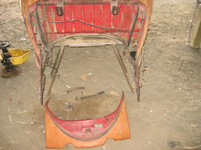

rear apron is off, gonna make it removable for easy engine changes.
http://www.thesamba.com/vw/gallery/pix/202725.jpg

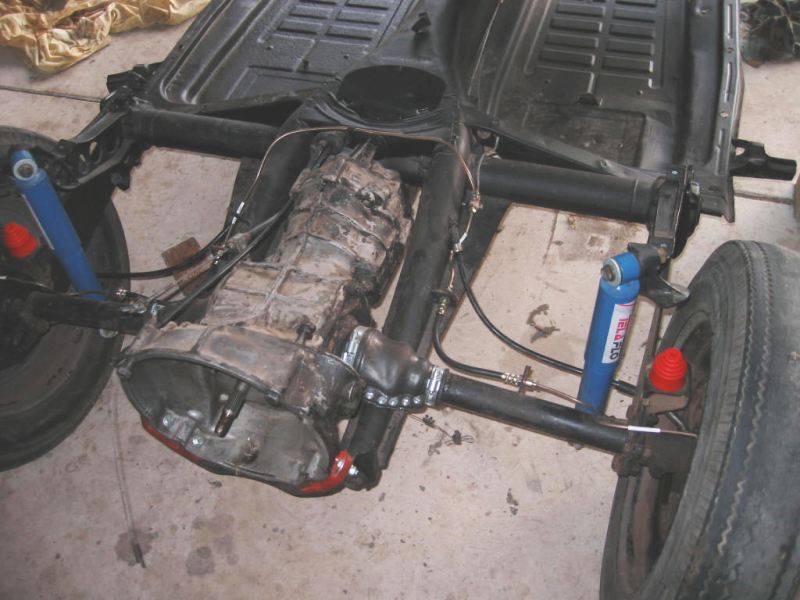

and the trannys in, used Empi urethane mounts which I am a bit suss on.
http://www.thesamba.com/vw/gallery/pix/202726.jpg
it feels so good to be able to change gears on it again.

With the mounts, the front one gets distorted when it is torqued up, also they seem like they may be a bit brittle, but this may or might not be the case, plus they are EMPI :duh
How are the heater boxes going??

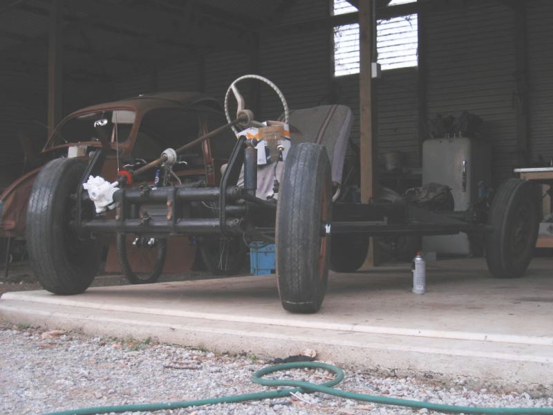

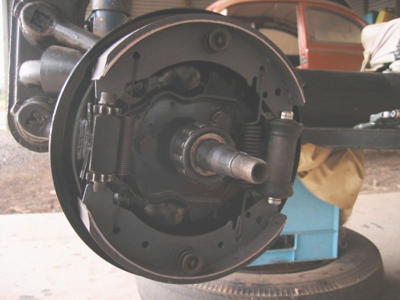

Some more pics, its back on its four legs!!!!!!!!
I've pretty much rebuilt the entire brakeing system (MC, wheel cyl, lines, pads, etc.)
Tranny has new seals all over
Urethane spring plate bushes
rear re-indexed one inner up and 1 outer down
new shift rod bushing
tie rod ends regreased
new steering damper
rebuilt K+L assemblys
new shocks on the back (will balljoint bus shocks off the front fit???)
fronts were fine so I left them for the time being
Custom urethane bump stops rear
thats all I can think of atm
some more piccies
http://www.thesamba.com/vw/gallery/pix/212900.jpg
ground clearence with stock size tyres and no neg travel
http://www.thesamba.com/vw/gallery/pix/212901.jpg
new brake lines and that
http://www.thesamba.com/vw/gallery/pix/212902.jpg
http://www.thesamba.com/vw/gallery/pix/212905.jpg
Cheers!
