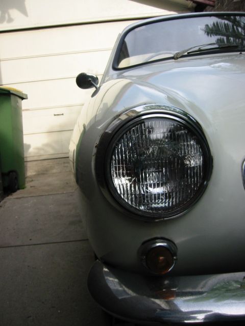

If your not hung up on originality or have been scared off by the price of original KG headlights, you can use Mini headlights with sealed beams. They look much better than a H4 Golf/beetle lense as they are curved and flat. Best of all they can be gotten new for very little. I had them on my old 61 Ghia whilst I was sourcing a RHD cracked original headlight lense.
http://www.matara.net/albums/ghia/IMG_2381.jpg
