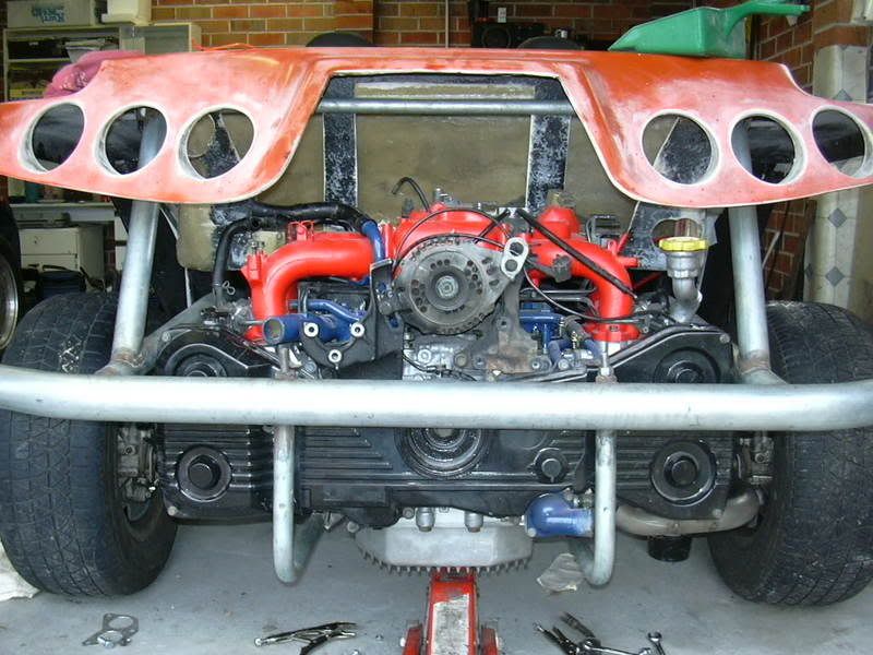

Here's by bug@5speed one.
http://i20.photobucket.com/albums/b213/toddy4281/New%20Buggy/DSCN0586.jpg
http://i20.photobucket.com/albums/b213/toddy4281/New%20Buggy/DSCN0642.jpg
http://i20.photobucket.com/albums/b213/toddy4281/New%20Buggy/DSCN0674.jpg
http://i20.photobucket.com/albums/b213/toddy4281/New%20Buggy/DSCN0759.jpg
Think that will do for pics... Last one is jacking the car up with the jack under the sump.

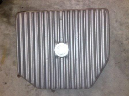

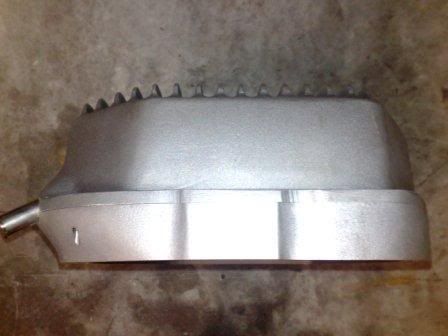

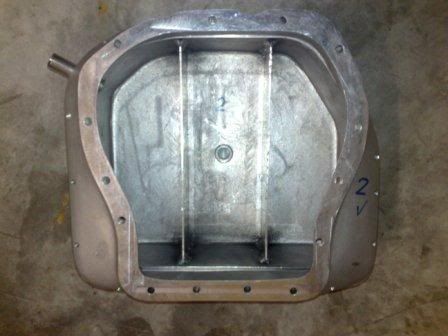

posted on July 24th, 2008 at 07:46 AM
If you're after a cast one, get the bug@5speed one mail order from Germany. It takes a couple of weeks to get here via DHL and it's at your door. The quality of the sump is 100% and yes it has baffles welded into it. If you think you need a windage tray (maybe you're planning on having the thing at 45 degrees angle all day) then tig one into it.
For my money this cast one is 450000% better looking and finished than any chopped up and rewelded original one.

dont want to sound rude! that sump does not hold enought oil....if i remember it only holds 3litres there abouts:no:
