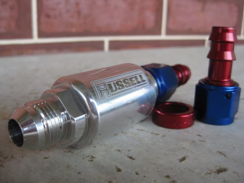

Got some new Speedflow fittings for the tank from Go-Gear.... Got the filter mounted with new 1/2" fittings, got new 1/2" solid fuel lines run, made a new mount for the Malpassi FPR, need to fit the new pump, get some more 1/2" soft line and some clamps and larger fittings for the carb, and some sort of line reducer for the FPR inlet and outlet....

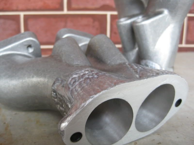

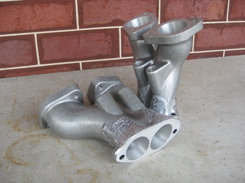

They've arrived!!!!
http://i27.photobucket.com/albums/c181/Humptydub/POS60T/IMG_1227.jpg
Look at the quality of the welds and the porting?... They've also been sleeved in the manifold stud area.... Shame I need to match them to my Wedgies!!!!
http://i27.photobucket.com/albums/c181/Humptydub/POS60T/IMG_1228.jpg

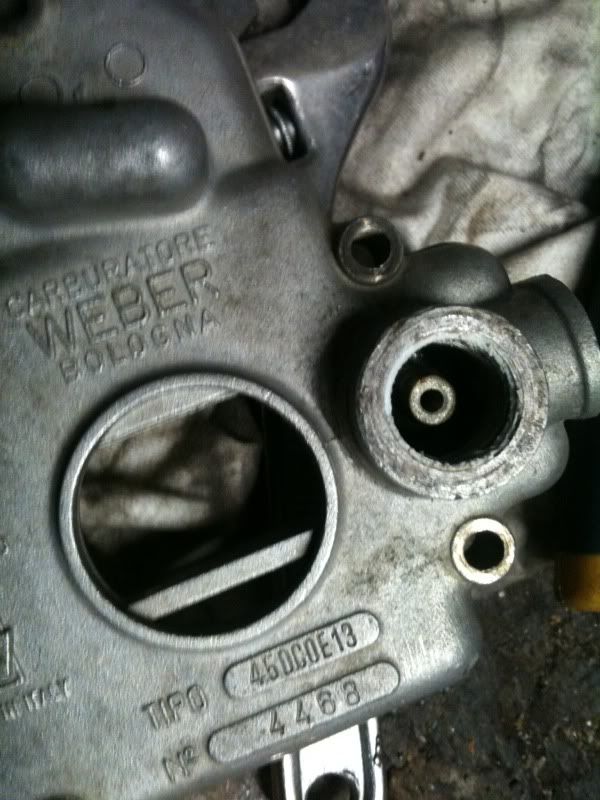

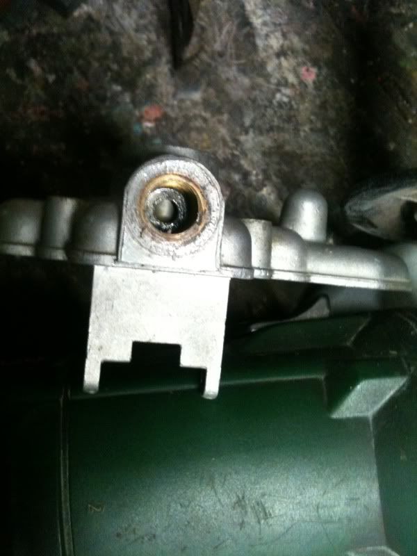

Also.... While I have your attention....
These are the inlet in the carb top.... Tiny lil' things aren't they?.... Can I drill them out at all?..... And do you think I should continue to run the small filter that is in there also?
http://i27.photobucket.com/albums/c181/Humptydub/POS60T/DCOE_fuelinlet.jpg

Anyway..... Drilled out the inlets on the carb (on advise from Shagg in the US), got the dremel in there and smoothed everything out... Nice smooth pathway for the fuel to travel now.... Pulled the filter screen also.
Couldn't figure out the problem with the fuel not getting in.... So I fitted a hose to the carby inlet whilst is was fitted to the carb body.... Attempted to blow into the carb.... Nothing doing.... The ball'n'seat was work perfectly..... A little too perfectly..... The problem is obvious.... The float level is wrong.... Maybe I've been setting it wrong all this time, but have just been right enough to work in the past..... So with the wonderful world wide web at hand, I found a reference to setting the float that said the top plate of the carb must be vertical.... With the ball'n'seat at the top most point and the floats hanging downward..... I had been checking it with the top cover upside down and horizontal.... Idiot!
Corrected the level and bolted it all back on.... Power up.... Right away I could hear the difference in the fuel pump and hear the fuel flooding into the float bowl.... Couple of twists of the butterflies and the squirters are working perfectly.... Turn the key and she fired right up... 2psi at idle.... Perfect.
Sorted.... Off for a spin around the block this arvo....
