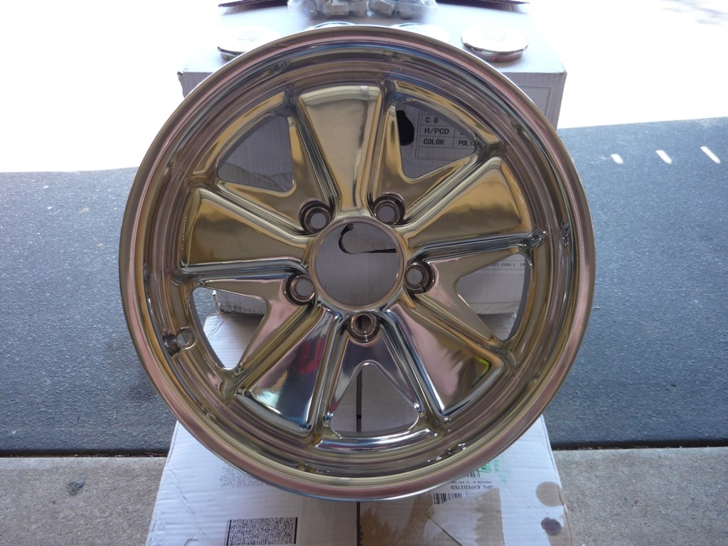

posted on November 6th, 2009 at 09:53 AM
now its time to upgrade to porsce wheels..... :)
http://img.auctiva.com/imgdata/1/2/6/7/7/7/7/webimg/294995508_o.jpg
Membertrickysimon
A.k.a.: Simon Azzopardi
Posts: 1473
Threads: 43
Location: Wagga Wagga
posted on November 6th, 2009 at 11:42 AM
Thats the plan...gotta take care of a bit of debt first though....:lol:
