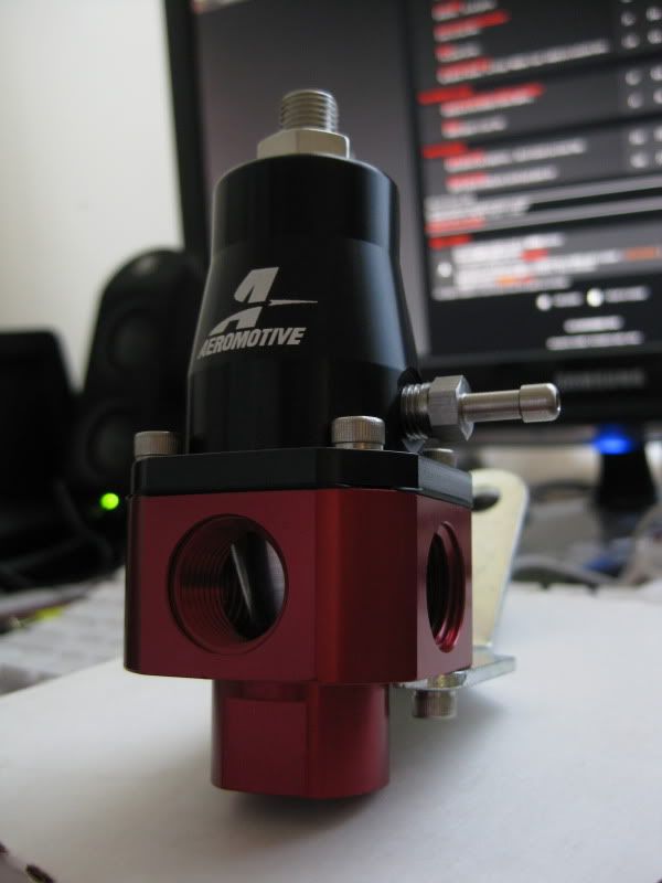

Finally gave up on the FPR from the US ever arriving.... The seller is attempting to get a refund sorted for me via the postal insurance.... I don't hold out much hope....
So I went down to my local V8 performance shop and ordered the 13301 FPR..... It took 2 days to arrive and only cost me 40 bux more than the US one..... But since I'm still out of pocket on the US one, I'm in the hole on this project in a major way.....
Racing aint cheap!
So here it is.....
http://i27.photobucket.com/albums/c181/Humptydub/POS60T/IMG_1245.jpg
Started fitting it up this arvo.... Just need to finish off the mount for it and she's good to go.... Will fire it up tomorrow.

Just finished fabing and fitting the FPR.... Turned the key, checked for pressure and leaks.... No leaks spotted and pressure turned down to 2.5psi with ease..... Then fired up the beast..... She goes!..... Pressure is rock solid, AFR's are a little erratic, jetting needs some work.... Still waiting on some more weber gear to arrive from Queensland.... Need to organise a permit to drive for next weekend, then its time for a little road tuning.... Only option I have really.... No one here in Perth knows anything about dyno tuning carb'ed engines let alone turbo'd VW's!
