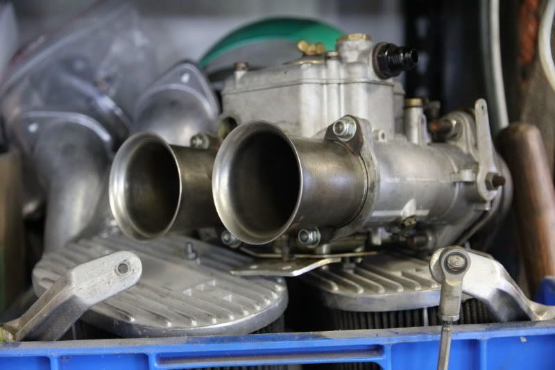

Howdy Simon
you didn't go for the AJ's carb setup any reason
Just waiting for Peter to finish some other motors before he gets to mine:). I hate waiting LOL

Have you given up on the 45?
AJ vids on youtube are not impressive.

Yep..... Just couldn't get it to work consistently.... With no local knowledge, rare and expensive parts and finicky tune, after two years fiddling with the thing I just got jack of it.... To be honest, I reckon the carb is just too big for my little engine and possibly too modified to boot!
So as an interim (before the stroker and efi go in the new body), I thought I give this a shot....

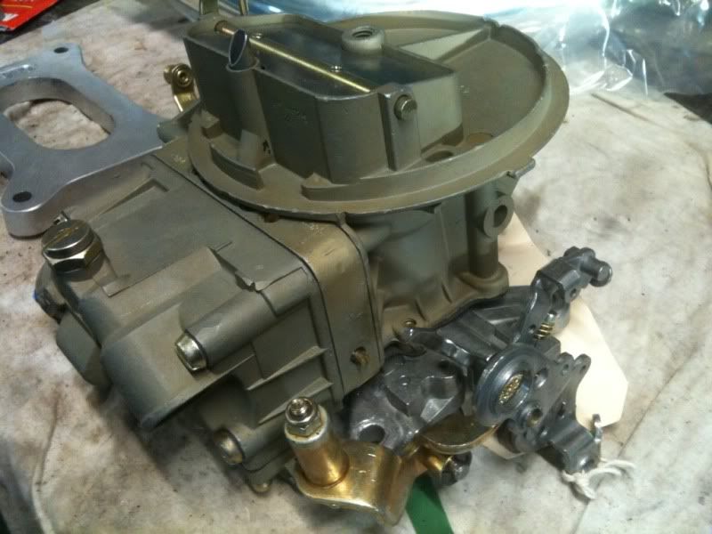

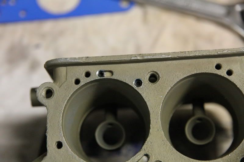

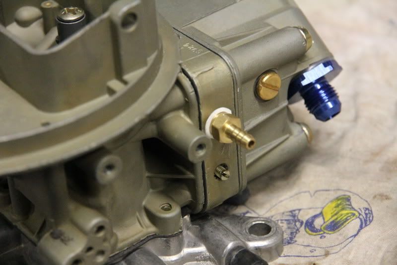

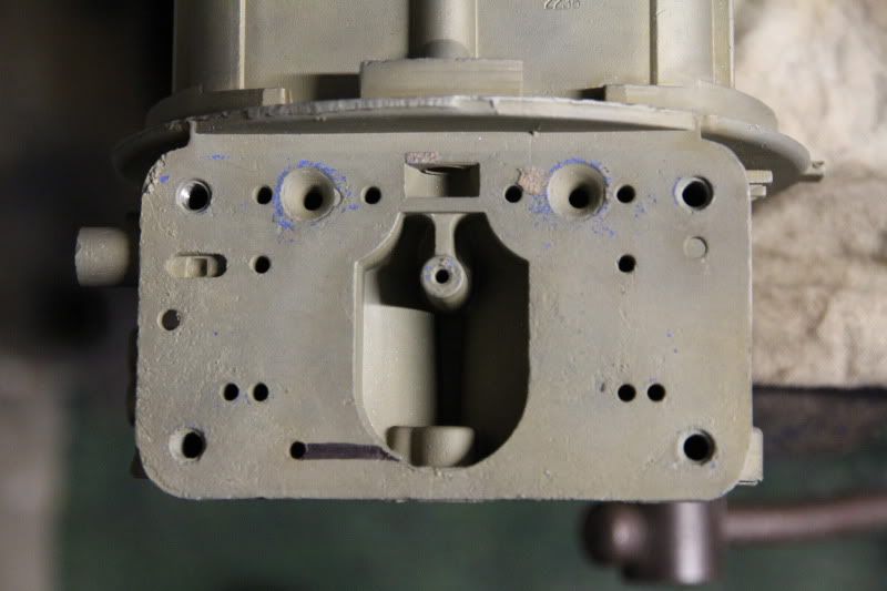

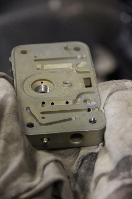

Ok.... So now I got my 500 Holley in bits.... Fitted the smallest PV I could find (3.5), the Adjust-a-jet is here now, and the boost referencing mods are about to happen, but still I have questions....
http://carburetorsandmore.com/holley5002v33.jpg
Can anyone tell me what all these ports (the large one at the top and the two smaller ones on the lower right) are for in the base plate are for?
FUCH your early!

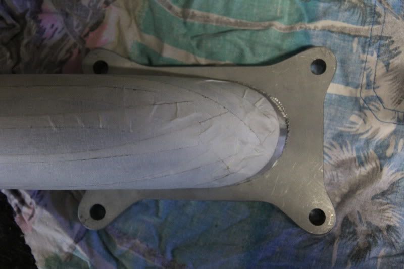

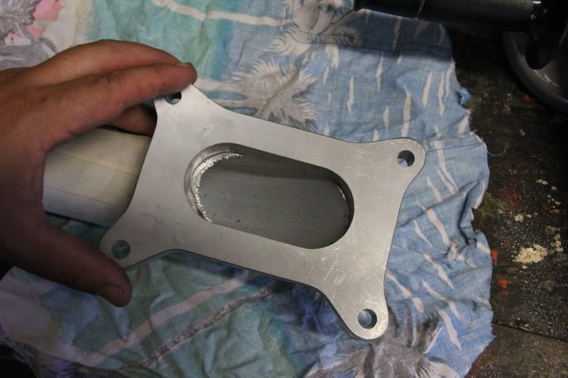

posted on September 25th, 2011 at 08:41 PM

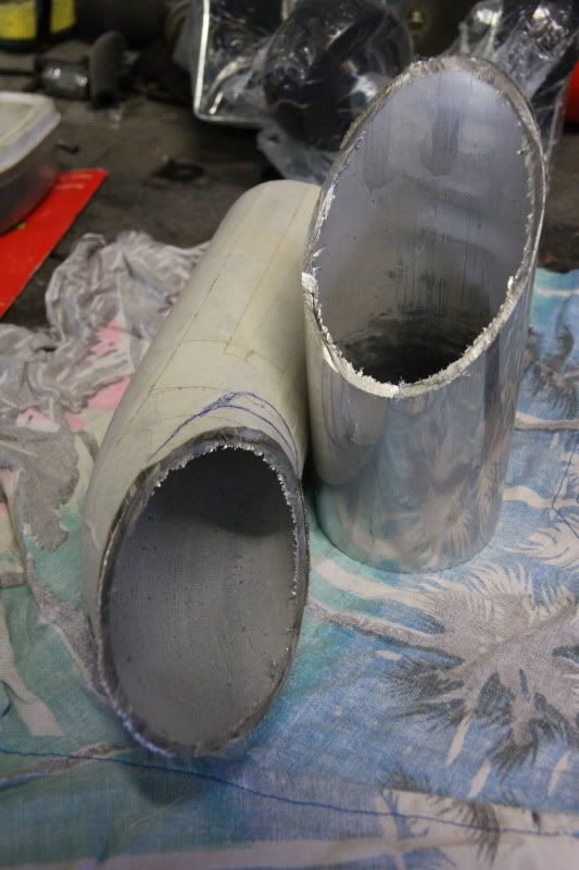

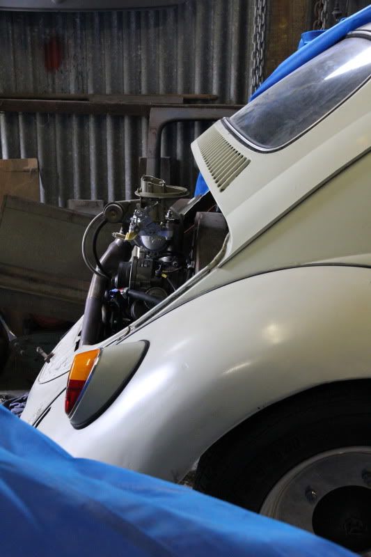

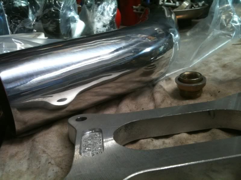

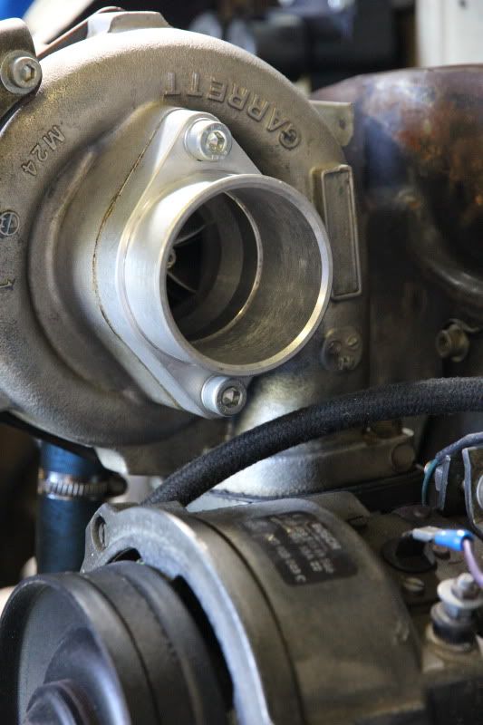

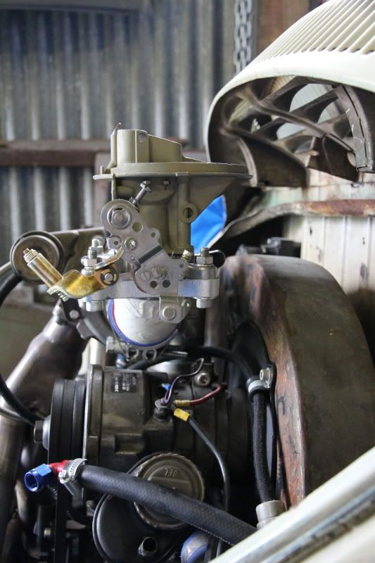

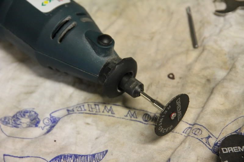

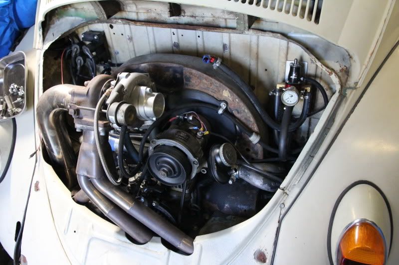

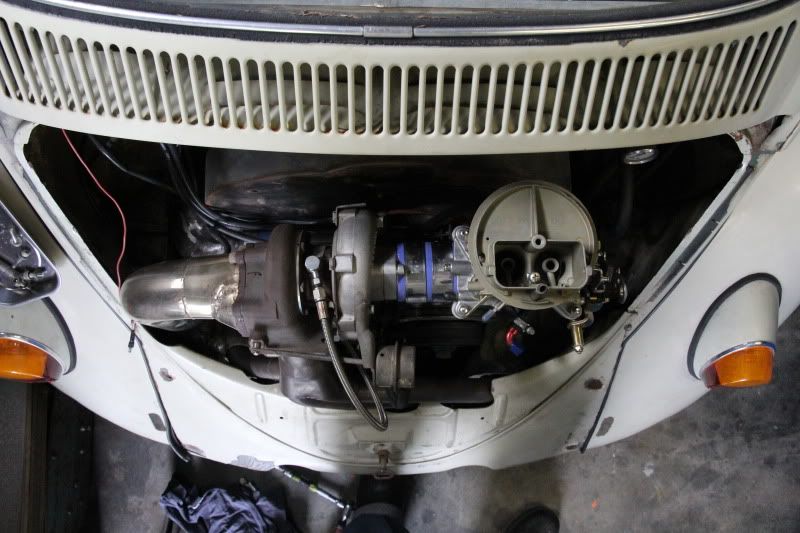

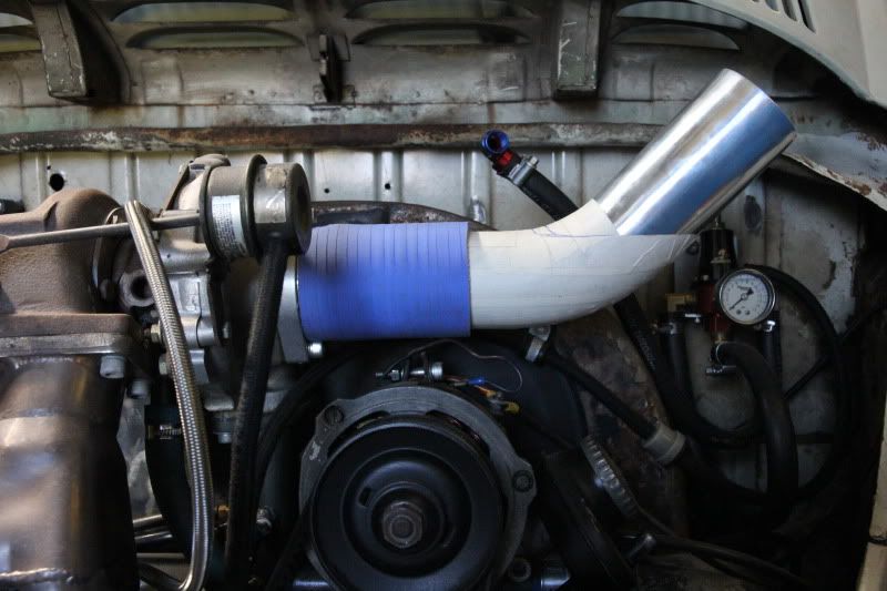

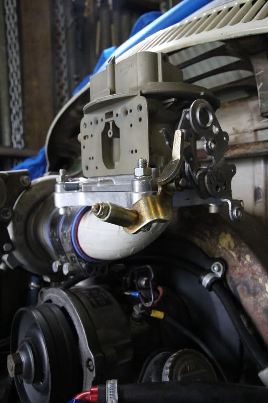

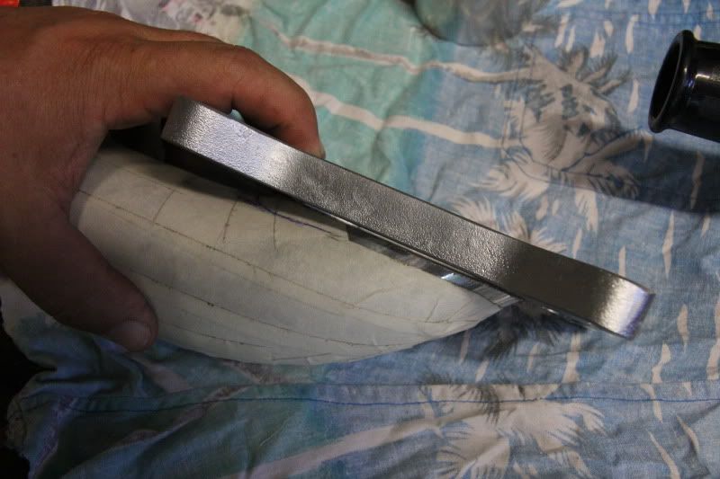

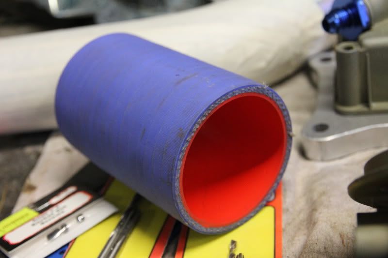

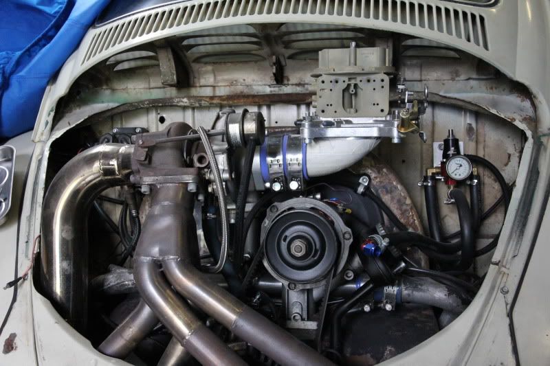

Got back in the shed this morning..... So started on the new intake for the Holley....
But first I needed to pull this....
http://i27.photobucket.com/albums/c181/Humptydub/POS60T/IMG_5327.jpg
Then I bolted this on in it's place....
http://i27.photobucket.com/albums/c181/Humptydub/POS60T/IMG_5326.jpg
http://i27.photobucket.com/albums/c181/Humptydub/POS60T/IMG_5321.jpg
Followed by this.....
http://i27.photobucket.com/albums/c181/Humptydub/POS60T/IMG_5334.jpg
And this...
http://i27.photobucket.com/albums/c181/Humptydub/POS60T/IMG_5336.jpg
Which needed some trimming.... And shortening...
http://i27.photobucket.com/albums/c181/Humptydub/POS60T/IMG_5338.jpg
http://i27.photobucket.com/albums/c181/Humptydub/POS60T/IMG_5339.jpg
http://i27.photobucket.com/albums/c181/Humptydub/POS60T/IMG_5344.jpg
http://i27.photobucket.com/albums/c181/Humptydub/POS60T/IMG_5340.jpg
Which got me to this....
http://i27.photobucket.com/albums/c181/Humptydub/POS60T/IMG_5360.jpg
http://i27.photobucket.com/albums/c181/Humptydub/POS60T/IMG_5359.jpg
http://i27.photobucket.com/albums/c181/Humptydub/POS60T/IMG_5361.jpg
http://i27.photobucket.com/albums/c181/Humptydub/POS60T/IMG_5348.jpg
http://i27.photobucket.com/albums/c181/Humptydub/POS60T/IMG_5345.jpg
Happy with that lot so it's off the TIG dude for a little fettle....
Then I started on the new breather/catchcan setup....
It's kinda cool and a little odd..... Just the way I like it! :D

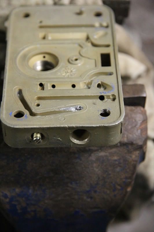

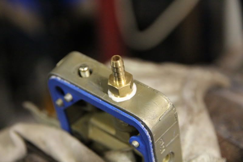

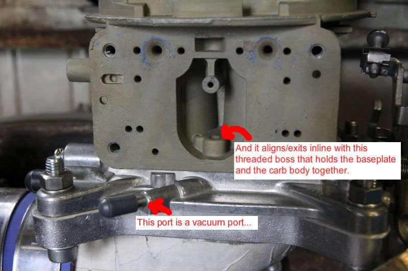

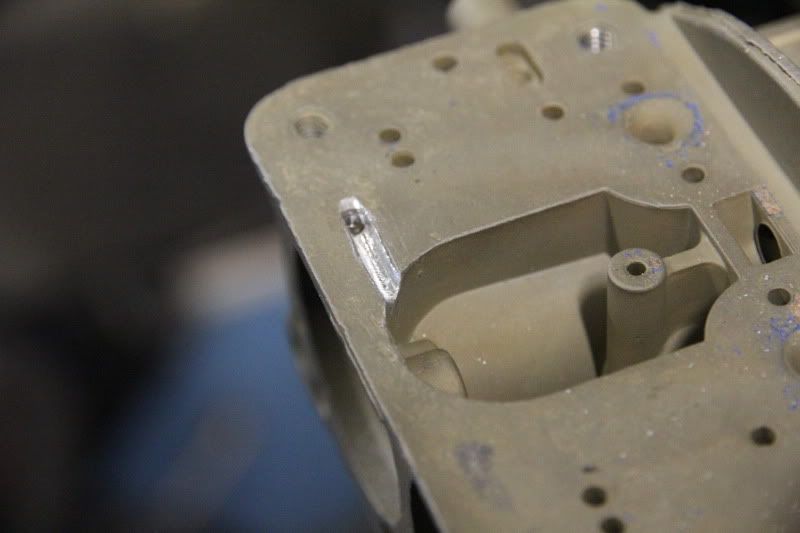

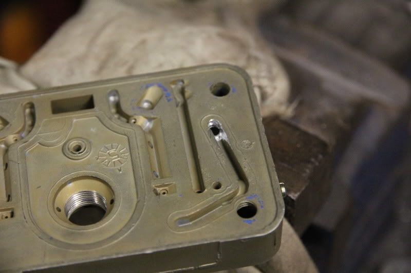

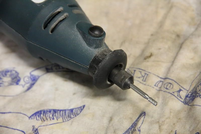

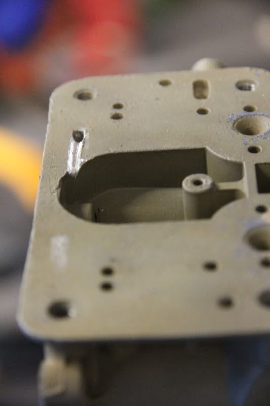

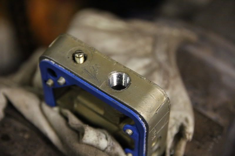

I just want to make this very clear to you all...... I know absolutely nothing about Holleys!.... Ask me about Dellortos and I can bore you to tears on those babys, but Holleys are a total unknown.....
Now for my questions.... Is there any reason why I can't use the stock vacuum port as the signal port for the Power Valve (PV) boost sensing mod?
http://i27.photobucket.com/albums/c181/Humptydub/POS60T/IMG_5362-1.jpg
http://i27.photobucket.com/albums/c181/Humptydub/POS60T/IMG_5364-1.jpg
I think I might be able to get in there and redirect the gallery into the PV chamber, but would this possibly have a disastrous effect on some other function within the carb?
As a side note for those that are better informed than I.... My carb is marked with a 4412-S model number.... Does that mean its suitable to be used on a blown engine, and this port I am contemplating using is in fact the OEM method for boost sensing?
FUCH your early!
http://www.noh2o.org/
MemberStanley
Posts: 4523
Threads: 270
Registered: March 13th, 2003
posted on September 26th, 2011 at 07:16 AM
Try this Simon
http://ultimateaircooled.com/simplemachinesforum/index.php/topic,7072.0.html
http://ultimateaircooled.com/simplemachinesforum/index.php?topic=5909.0

posted on September 27th, 2011 at 09:34 PM
Boost referenced the 500cfm Holley today....
Needed to machine a slot where that black line is....
http://i27.photobucket.com/albums/c181/Humptydub/POS60T/IMG_5378.jpg
Used this....
http://i27.photobucket.com/albums/c181/Humptydub/POS60T/IMG_5381.jpg
And this...
http://i27.photobucket.com/albums/c181/Humptydub/POS60T/IMG_5380.jpg
To make this....
http://i27.photobucket.com/albums/c181/Humptydub/POS60T/IMG_5387.jpg
http://i27.photobucket.com/albums/c181/Humptydub/POS60T/IMG_5385.jpg

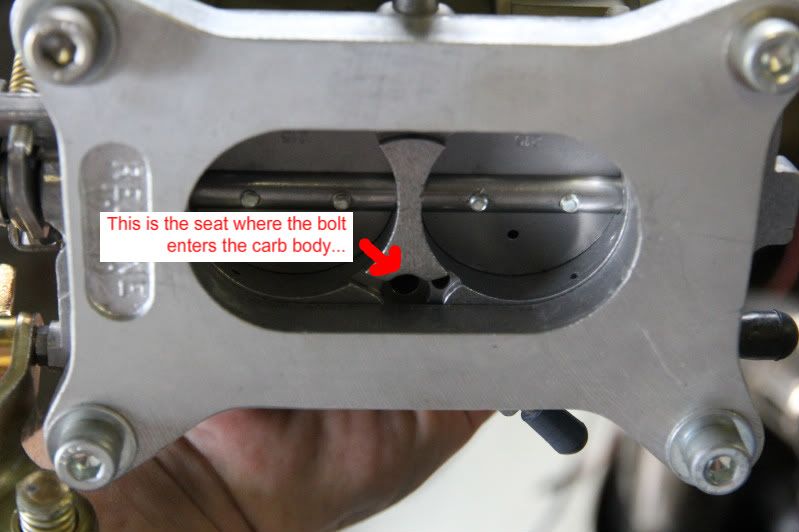

See that 'L' shaped gallery?
http://i27.photobucket.com/albums/c181/Humptydub/POS60T/IMG_5389.jpg
It lines up with the slot I cut in the carb body earlier...
Then I drilled a hole at the top most part of it....
http://i27.photobucket.com/albums/c181/Humptydub/POS60T/IMG_5391.jpg
Which lines up with the large hole that is cast in the side of the PV manifold...
http://i27.photobucket.com/albums/c181/Humptydub/POS60T/IMG_5392.jpg
Which was then tapped with 1/8 tapered tap....
http://i27.photobucket.com/albums/c181/Humptydub/POS60T/IMG_5393.jpg
So I could fit this....
http://i27.photobucket.com/albums/c181/Humptydub/POS60T/IMG_5394.jpg
Then I needed to drill, tap and seal these two galleries to reditrect the vacuum/boost signal....
http://i27.photobucket.com/albums/c181/Humptydub/POS60T/IMG_5397.jpg
Then I whacked it all back together....
http://i27.photobucket.com/albums/c181/Humptydub/POS60T/IMG_5399.jpg
Still need to fit the Adjust-a-jet and then we are done....
