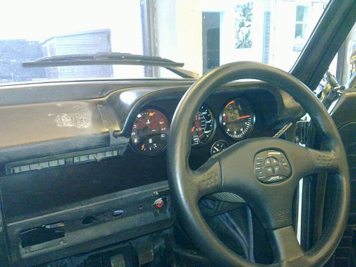

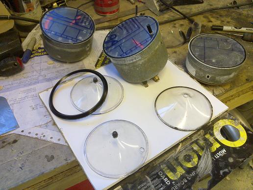

I really wasn't keen on the Porsche 'nipple' lenses so after carefully picking the surrounds off I was able to remove the lenses and make up some new flat ones from polycarbonate sheet. While they were apart I sandblasted and repainted the rims and they look brand new now.
http://www.ricola.co.uk/images/cabrio/gauges.jpg
All back in the car I'm happy with how it's all looking. I painted the dash binnacle as a temporary measure until it's re-trimmed in leather.
http://www.ricola.co.uk/images/cabrio/binnacle_5.jpg

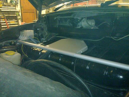

I also made up a strut brace. Coming off it are a brake reservoir bracket and also a cover to protect the fuel pump and fuel level sender.
http://www.ricola.co.uk/images/cabrio/strut_brace.jpg

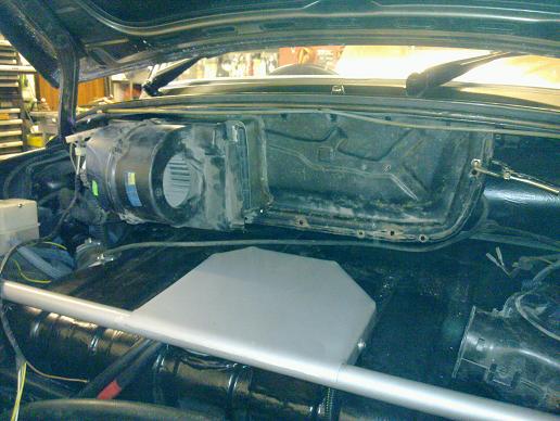

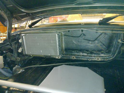

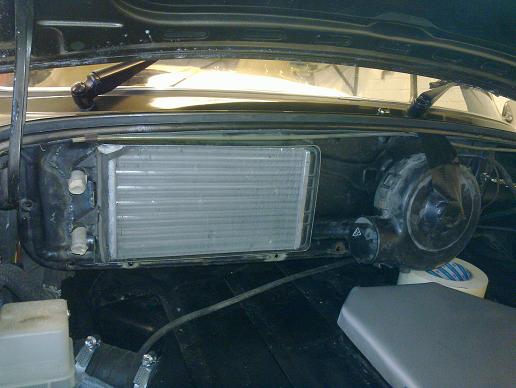

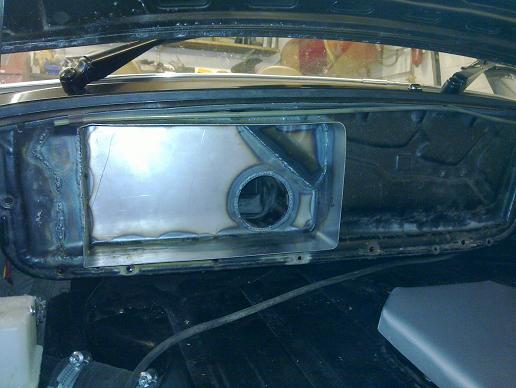

I've cut into the wiper box cover to build a housing for the heater matrix. The corner piece had to be clearanced for the wiper mechanism and the tube connects straight up to the stock air ducting so all the stock dash controls can still be used.
http://www.ricola.co.uk/images/cabrio/heater_1.jpg
Fiat cinquecento heater matrix in place, note the neat positions of the connections down the side of the car.
http://www.ricola.co.uk/images/cabrio/heater_2.jpg
I initially planned to fit the stock fresh air blower fan roughly in the position shown but when connecting it up to a spare battery it was more a breeze than a decent flow.
http://www.ricola.co.uk/images/cabrio/heater_3.jpg
This is the polo heater blower which gave much better flow and will also be easier to mount up to the matrix.
http://www.ricola.co.uk/images/cabrio/heater_4.jpg

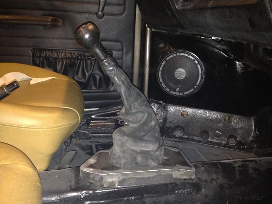

I made up this metal cover to cover the shifter base and allow trimming, still not sure how I will do it but it's a start.
http://www.ricola.co.uk/images/cabrio/gaiter_base.jpg

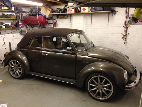

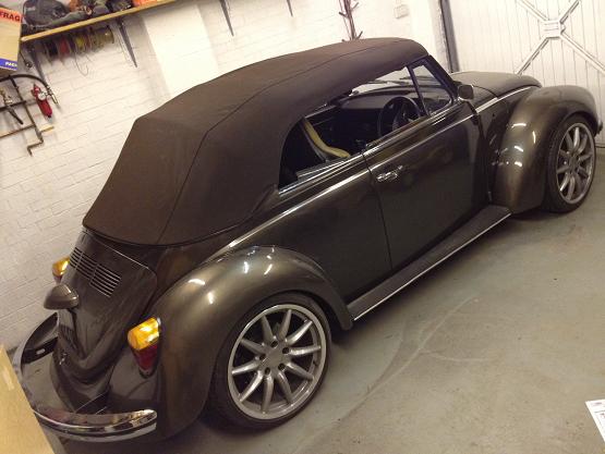

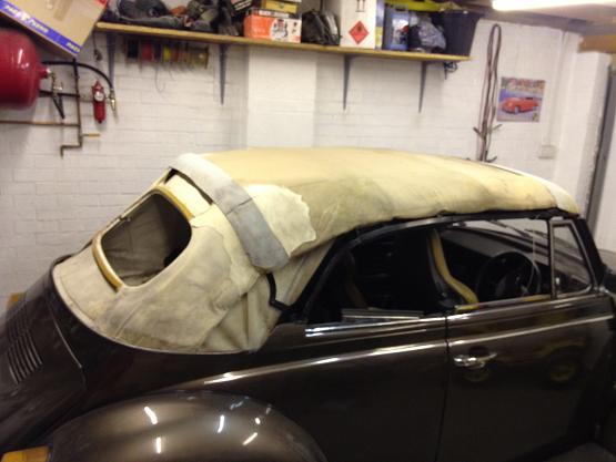

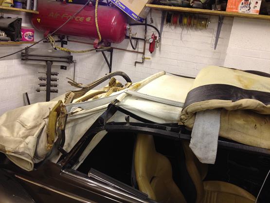

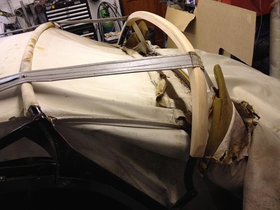

I've been putting this off for a while... The old vinyl roof shrunk whilst in storage folded up so when I came to close it on the car the stress broke the wooden bow over the rear window. This meant a new bow and roof!
http://www.ricola.co.uk/images/cabrio/broken_bow.jpg
Bow from the original tooling was sourced from Germany along with a new roof outer skin, in Sonnenland (similar to mohair) this time around and a change of colour. A fair amount of repair of sound deadening material as well as repainting sections of the roof frame were done at the same time.
http://www.ricola.co.uk/images/cabrio/new_bow.jpg
Here's the roof ready for it's new outer skin. The foam strip over the bow is to cover up the staples holding fabric to the bow and stop wear on the outer hood.
http://www.ricola.co.uk/images/cabrio/roof_repaired.jpg
Almost there! I'm letting it all settle for a few days now before I get the knife out and cut the rear window aperture out. All seals and wires are refitted in this picture, just a couple of screws to fit at the base of the C pillars to take up any final slack in the material.
http://www.ricola.co.uk/images/cabrio/roof_settling_2.jpg
http://www.ricola.co.uk/images/cabrio/roof_settling.jpg

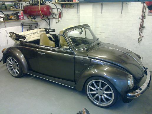

posted on December 15th, 2011 at 03:04 AM
Roof just about done now...
http://www.ricola.co.uk/images/cabrio/roof_screen.jpg
I'm going for the light tan colour leather on the right for the interior, I was originally going to go for a cocoa colour but having thought about it I think it would be too much of the same and some contrast is called for.
http://www.ricola.co.uk/images/cabrio/leather_choice.jpg

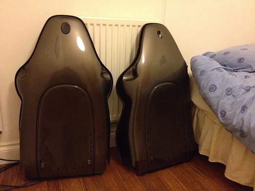

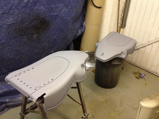

Seat backs are a bit marked and as the seats will soon be dismantled for trim now is the perfect time to colour-code the backs to body colour.
http://www.ricola.co.uk/images/cabrio/seat_backs.jpg

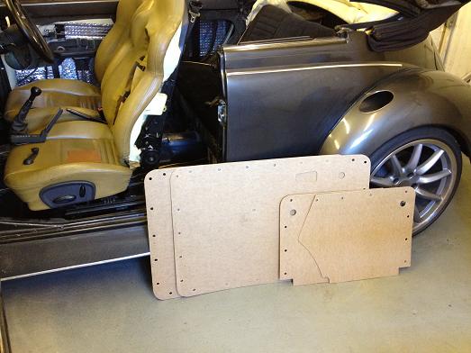

The old trim panels were moisture damaged so I've made up some new ones. I will also be making some new moisture barriers to keep these ones dry!! You can also see in the background I've put sound deadening in the door panels
http://www.ricola.co.uk/images/cabrio/new_trim_panels.jpg

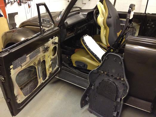

Seat backs after a lot of work with paint stripper, etch and high-build primer
http://www.ricola.co.uk/images/cabrio/seat_backs_2.jpg
before finally getting the body colour top coats..
http://www.ricola.co.uk/images/cabrio/seat_backs_3.jpg

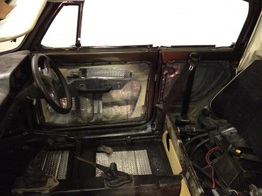

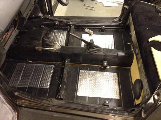

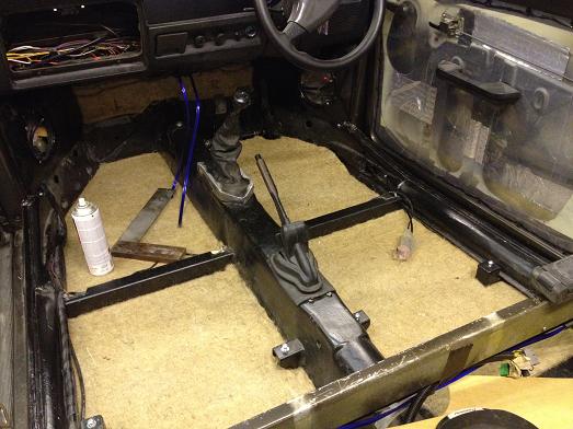

More sound deadening pads fitted to the floor panels and new MDF trim panels made up to fit speakers under the back seat
http://www.ricola.co.uk/images/cabrio/floor_deadening_1.jpg
Door membranes to stop the new door panels suffering from water damage (I've also painted them in yacht varnish before I give them to the trimmer)
http://www.ricola.co.uk/images/cabrio/door_membranes.jpg
Automotive underlay cut to shape for the floor, only lightly glued in case they need to be removed to dry out if I ever get caught out by rain!
http://www.ricola.co.uk/images/cabrio/floor_deadening_2.jpg

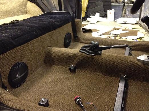

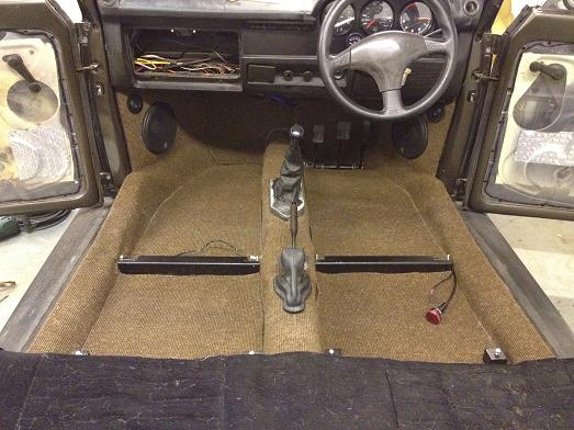

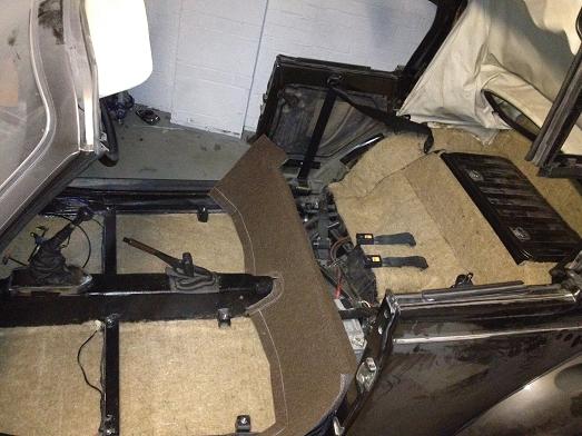

The first piece of carpet going in. I've spent far too much time planning the layout in my head to minimise joins and exposed edges to give it a more OEM look.
http://www.ricola.co.uk/images/cabrio/carpet_1.jpg
First panel finished...
http://www.ricola.co.uk/images/cabrio/carpet_2.jpg
Then on to the tunnel section. I bonded on a metal reinforcement to the handbrake hole, this means I can fit the standard type rubber which will hide the cut edge nicely and the hole won't get opened up. A bit of foam also stops any potential rattles.
http://www.ricola.co.uk/images/cabrio/carpet_3.jpg
Passenger bit now done, just behind the back seat to sort out. Still undecided what to do about under the bonnet
http://www.ricola.co.uk/images/cabrio/carpet_6.jpg
Front end done. The floor and bulkhead panels will go to the trimmer to have the edges bound.
http://www.ricola.co.uk/images/cabrio/carpet_5.jpg

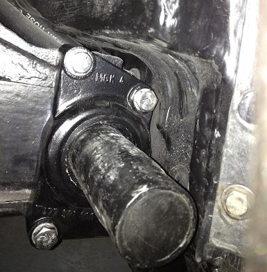

LSD as received with the gearbox when I bought it, bit of an unknown quantity!
http://www.ricola.co.uk/images/cabrio/lsd_1.jpg
http://www.ricola.co.uk/images/cabrio/lsd_2.jpg
http://www.ricola.co.uk/images/cabrio/lsd_3.jpg
The ramps show it is out of a 964 RS/turbo which means 20% lock on acceleration and 100% lock on overun. This has really helped the car feel much more predictable and also stable, especially after the suspension unloads after hard acceleration. I was going to have a go at fitting it myself but was unable to measure everything accurately enough. The trans had different brands of bearing either side of the differential so during the swap I had to replace: bearings, ring gear bolts (longer on LSDs), seals, oil, shims. With labour that lot added up to £580!!!

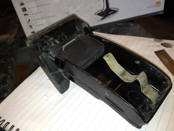

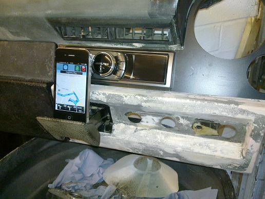

After being messed about by 'Car Audio Centre' for the best part of two months (avoid them at all costs!!) I bought a secondhand head unit from a friend. I wanted Alpine to go with my steering wheel controls. I ended up with an IDA-X001 which is a media head unit with graphic display and ipod/iphone controls. Rather than use a wire and screen mount I have hacked up a dock which fits snuggly into the ashtray with minimal mods.
http://www.ricola.co.uk/images/cabrio/ashtray_dock.jpg
Happy with how it looks! Lucky this head unit has the main control centrally so out of the way of the phone. I'll use it for satnav and music as well as keeping my phone charged.
http://www.ricola.co.uk/images/cabrio/ashtray_dock_i4s.jpg

I've been keen to see those wheels on a bug for a while and they look sooooo good!!
(not as badass as yours'll look Seb ;) )
Kabs rock

Originally posted by SebastienPeekThose seats,I think they could find there way into Zelda.
What did you have to do to the rails to get them in?
Didn't you notice that I don't have any of the original floors left?! :lol:
MemberSebastienPeek
Posts: 1657
Threads: 89
Registered: May 31st, 2011
posted on May 12th, 2012 at 05:57 PM
I did notice, was just wondering if you used the same rails or not?
But obviously not ;)
I'll see what I can do to get the seats into mine, will see if I can find anything on them :)

Memberricola
Posts: 437
Threads: 9
Location: UK
posted on May 12th, 2012 at 06:11 PM
Send me your email, I have an article on fitting them onto existing 3 point VW mounting if you like...
Rich

What year BMW E30 thermostat housing/thermostate did you use? I did a google search and it seems there were different styles used thru the years. I am all for not having to burp the cooling systems for hours to get the air out. Are you using the ECU to turn on your cooling fan?
Thanks...
Memberricola
Posts: 437
Threads: 9
Location: UK
posted on May 18th, 2012 at 04:39 AM
I think there was only one choice for the four cylinder engines, that's the one I'm using.. Yes, using the ECU to switch the fan, I was previously one for using the adjustable thermostat switches but they seem to end up failing and aren't particularly neat.
