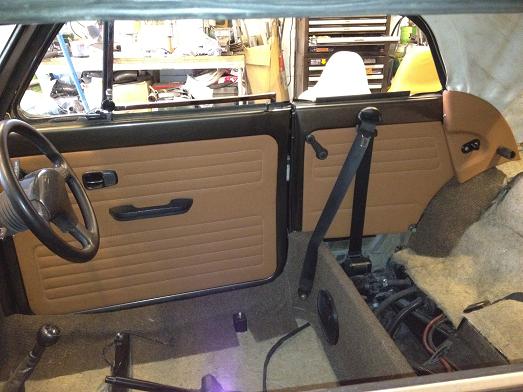

http://www.ricola.co.uk/images/cabrio/doors_trimmed.jpg
After 9 weeks of chasing, my second trimmer only managed to get the door panels and roof hinge covers done... I've now bitten the bullet and gone with a very good guy I've used before, just more expensive, but I know that he will do very good work and for my deadline which is the end of June.
I also had issues with the iphone dock, it seems the docks aren't straight through electrically and Alpine have a particular way of connecting together. I tried opening it up and making more connections but it still doesn't work... Any ideas?!?

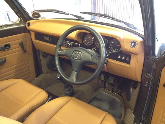

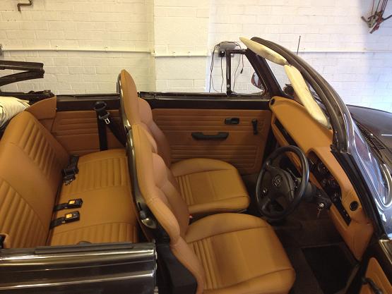

I finally got the call to say the interior was ready late yesterday afternoon... I left work early to pick it up and now it's in!!
http://www.ricola.co.uk/images/cabrio/finished_interior.jpg
under artificial light
http://www.ricola.co.uk/images/cabrio/finished_interior_2.jpg
Natural light
http://www.ricola.co.uk/images/cabrio/finished_interior_3.jpg

Hi Rich
That looks very nice.
Memberreub
VWRX is gone...
Posts: 2054
posted on August 10th, 2012 at 09:51 AM
Very nice indeed:tu:
Reub
posted on August 10th, 2012 at 10:59 AM
beyond awesome! as per usual. Love you work Rich. :yes:
MemberFlintstones
Posts: 1077
Threads: 69
posted on August 10th, 2012 at 11:03 AM
Rich, that looks sensational:tu:
but what about the visors?

Do they have sun over there, they can probably be deleted

posted on August 10th, 2012 at 07:13 PM
I know exactly what you mean, I'll either get some new identical ones or trim those with leather, just don't think they'd look right against the white headlining which is why I'm still wavering...

posted on August 10th, 2012 at 09:28 PM
Rich that looks awesome. great job!

ahh,i see your delema...damned if you do, and damned if you don't.
Headlining's been trimmed I gather? if not, trim it the same as the interior, then your visors will be right, otherwise tough decision.

the headlining in a cabrio is a bitch and I've already done it, you have to practically dismantle the roof to get access to it all and I think a headlining the same colour as the trim would be a bit oppressive....

posted on August 11th, 2012 at 06:28 AM
I think black sunvisors will look very good. And it's neutral.
posted on August 11th, 2012 at 11:02 AM
That dash is sensational :tu:

thumbup.gif posted on August 11th, 2012 at 09:03 PM
I agree but then, the whole car is just brilliant.

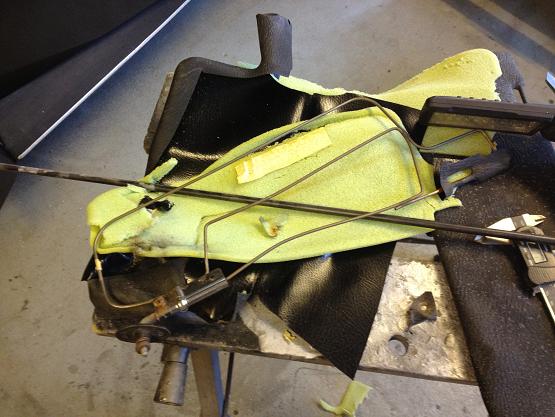

The pictures above drove me into coming up with a replacement set of sunvisors quickly! Although they matched the headlining I think they clashed badly with the roof down. I'd have the idea of making up some smoked plastic ones, in the style of early VWs, for a while so decided now was the time! Above is what a stripped sunvisor looks like, all this just to get the pivot.
http://www.ricola.co.uk/images/cabrio/sunvisor_1.jpg
I then made up a hinge assembly and cut some 5mm tinted perspex to shape and this is how they ended up, I'm very happy with this look.. At the same time I also painted the rear-view mirror base black to match.

I've tried flame polishing and a heat gun on scraps but it was distorting the edges slightly. I'll do a bit more wet sanding and polish at some point but they are pretty good as they are... I was impatient to see the effect!

Any chance of some close ups? I'd like to see how you attached the perspex to the frames if I could.

I'm probably going to make some more hinge bits better at some point. These are just thick sheet aluminium bent around the rod and bolts through the sheet and perspex sandwiching it. Tightening up the bolts gives more friction to the hinge. Really nothing complicated
