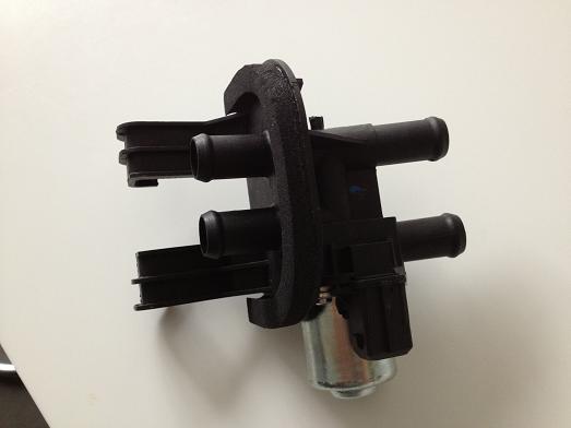

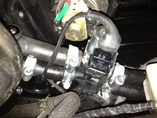

A problem I had on a previous kit car was that the heating system was ducted so efficiently with the intake in a high pressure zone that I would always get warm air coming through the system into the car. I couldn't have the fans on with ambiant temperature air as the heater matrix was part of the thermostat bypass flow. This was a particular problem during some heavy summer rain where I needed a good amount of air flow to keep the screens de-misted and my only option was hot heated air which turned the interior into a steam room! The solution is to fit a valve which can bypass the matrix but still enable constant flow, handily Ford fit one to many of their small cars so I bought one.
http://www.ricola.co.uk/images/cabrio/heater_controller_valve.jpg
The valve could be connected up to an on/off switch but a better solution (as well as how it is used in Fords) is to use a low frequency PWM controller, this gives proper temperature control by cycling the valve on and off depending on demand of a rotary switch which I have fitted in the glovebox. Mine came from ebay as a generic part but was modified by the seller to reduce the frequency to something more suitable. The valve connector was a generic mini timer type that was also from ebay.
http://www.ricola.co.uk/images/cabrio/heater_controller.jpg
Finally getting around to fitting the valve in the car after cutting off superfluous brackets, a quick test of the electrics to make sure it was fitted the correct way around and it's in!
http://www.ricola.co.uk/images/cabrio/heater_controller_valve_fitted.jpg
A test in the car and I'm extremely happy with how it works, the temperature is easily adjusted and changes surprisingly quickly.

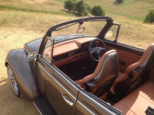

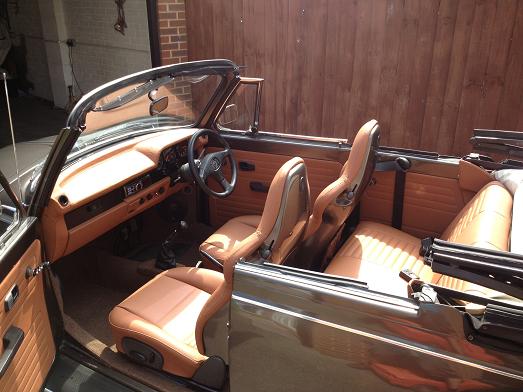

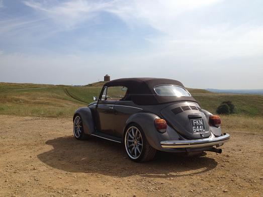

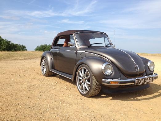

As the car is more or less done now I thought I'd post a bit of a summary of the final spec and some finished pictures (still waiting to get a proper photoshoot sorted!). In the mean time I've had it on the test track at work and got it up to an easy 150mph (GPS not speedo) and there was plenty more in it. Just need to give it a clean ready for a trip over to Spa next weekend..
[B]Body[/B]
oMain body restored with new heater channels, strengtheners, bulkhead, etc etc
oSpare wheel well modified to take main radiator and charge-cooler radiator
oFuel tank extended, baffled and fitted with internal up-rated fuel pump (HRC 310lpm)
oRear end removable on frame, VW bus inspection hatch above engine
oFront wings: 2” wider in fibreglass
oRear wings: 40mm wider in steel with forced cold air intake incorporated into left hand wing
oK&N panel air filter built in to inner wing, with water drain
oLengthened bumper irons with stock bumpers
oRepaint in original colour (Schwartz Metallic)
oGerman Sonnenland roof
[B]•Chassis[/B]
oCustom framehorns, torsion housing central section removed
oCustom perimeter frame rails with one-off bead-rolled floors, finished in epoxy mastic 121.
oOBP reverse mounted pedal box with twin brake master cylinders for adjustable bias and hydraulic clutch under false floor
oFront: Kerscher coil-over struts, heavy duty anti-roll bar
oRear: IRS with Protech coil-over dampers and swing axle length torsion bars, 944 anti-roll bar
o19” Porsche Carrera Sport wheels, 10j rear, 8,5j front
oVredestein Ultrac Sessenta tyres, 265/30R19 & 235/35R19
oPorsche 911 (996) brembo brakes front & rear
oBraided hoses, 911 fluid reservoir.
oSpacesaver 996 spare wheel
[B]•Powertrain[/B]
oRebuilt subaru EJ257 shortblock (2.5l STI), forged supertech pistons, rebuilt V4 sti heads, ARP 11mm head studs, external oil breather catch tank, shortened/extended sump with RCM baffle plate, Garrett SC46 turbo, ported headers with custom 2” crosspipe, 3” bellmouth from turbo back, magnaflow 3" muffler, Nismo 740cc injectors, ESL daughterboard mapped by Bob Rawle, Aeromotive FPR on reversed parallel fuel rails, new-age subaru coilpack conversion. Estimated 400-450bhp, 450ftlbs.
oCustom charge-cooler system with bosch water pump and Pace pre-rad, inlet manifold spacers/insulaters
oCooling system modified to external thermostat with Pace sierra cosworth radiator, fans controlled by ECU
o1989 Porsche 911 ‘G50 shortnose’ transaxle fitted with rebuilt 964 RS LSD (80/20). 930 CVs, aftermarket axles and drive flanges, KEP uprated Porsche stage 1 clutch (550ftlbs)
[B]•Interior[/B]
•Square weave carpets
•Heated Porsche 996 sports seats and seatbelts
•Rear seat modified to clear transmission tunnel
•Dashboard widened to fit early Porsche 924 gauges with additional Stack Oil pressure and turbo pressure gauges. Mini switches.
•Seats and dash re-trimmed in saddle tan leather by Auto-trim, Leicester
•Alpine CDA-X001 head unit, Rainbow component speakers up front in one-off fibreglass foot well enclosures, pioneer rear speakers in kick panels
•One-off heater system built into stock duct system, stock dash controls with t25 fan switch & electronic Ford heater valve
http://www.ricola.co.uk/images/cabrio/cab_out_1.jpg
http://www.ricola.co.uk/images/cabrio/cab_out_2.jpg
http://www.ricola.co.uk/images/cabrio/cab_out_3.jpg
http://www.ricola.co.uk/images/cabrio/cab_out_4.jpg
http://www.ricola.co.uk/images/cabrio/cab_out_5.jpg
http://www.ricola.co.uk/images/cabrio/cab_out_8.jpg
http://www.ricola.co.uk/images/cabrio/cab_eng.jpg
http://www.ricola.co.uk/images/cabrio/cab_under_bonnet.jpg

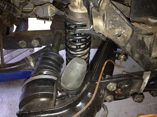

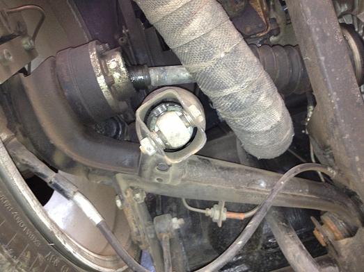

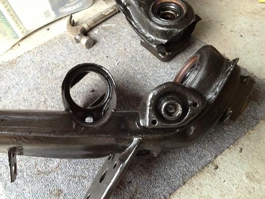

After the trip to Spa, the race style compact boots finally gave up with dealing with the CV angle. They are mainly designed for race cars and are basically an inverted cone with little give so not surprising really. They were necessary to clear the coil-over springs. This picture is from underneath with the car on a 2 post lift and the suspension at full rebound so definitely not the worst position, the damper swings closer to the axle at ride height.
http://www.ricola.co.uk/images/cabrio/broken_boot.jpg

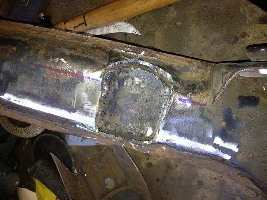

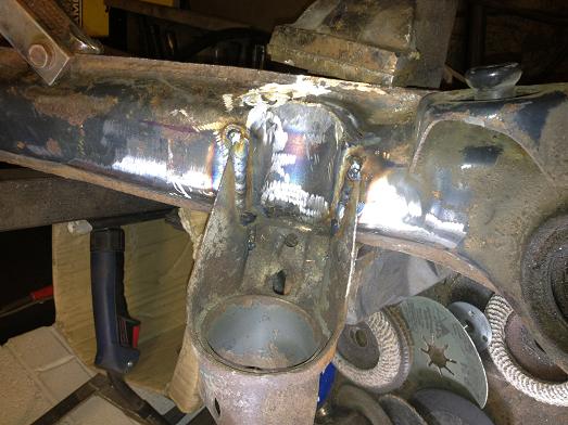

The long term fix was always to relocate the coil-over. I had a spare pair of trailing arms from a 944, these are identical to the beetle ones with the exception of some internal strengthening.
http://www.ricola.co.uk/images/cabrio/944_arm_internal.jpg
I made up new curved section to take a scallop out of the arm and also reweld the lower damper mount about 15mm further forwards.
http://www.ricola.co.uk/images/cabrio/944_arm_internal_2.jpg
All back together ready for clean up and paint.
http://www.ricola.co.uk/images/cabrio/944_arm_mod.jpg
Better view showing the additional clearance made.
http://www.ricola.co.uk/images/cabrio/944_arm_mod_2.jpg
As before this is with the suspension in full droop but now with a nice big silicone off road style CV boot that is designed for much more angularity than I will subject it to. At ride height I can get a finger between the spring and boot so clearance is no longer an issue. While I was at it I also fitted the 944 spring plates with the built in capability of a camber bolt anti-roll bar fitting to set the camber, it is also designed to take a toe adjustment tool. I had to lose the ride height adjustment due to clearance problems with the wheel but with the adjustable coil-overs this really isn't an issue for me...
http://www.ricola.co.uk/images/cabrio/944_arm_mod_3.jpg
