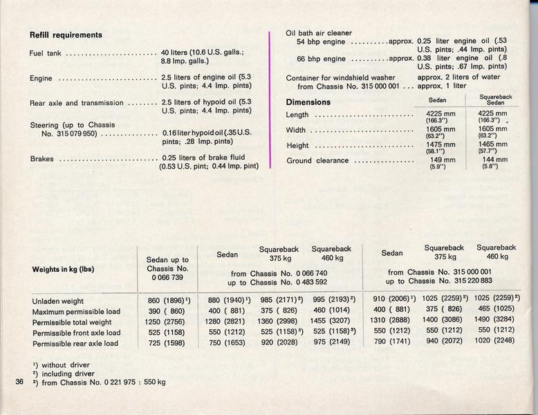

Originally posted by vlad01
early is rumored to be 980kg ? but I can't say that figure is right or not.
880kg ;)
http://www.thesamba.com/vw/archives/manuals/651500smanual/page36.jpg
posted on August 20th, 2013 at 08:31 PM
880kg ;)
I seen other figures too including that one. Let me see what I find in my VW operator manuals.
seems vw ball parked a lot of figures with the type 3. Especially the EFI models, different vw literature sated different specs for some of the same stuff.
interesting how they state on your pic the weight with driver for the SB but without for the sedan?
EDIT.
got a wheels road test, fastback. doesn't state the year but judging by the colour and IRS rear its a late model, at least 69. some BS weight measurement cwt? anyway got 780 or 883kg.? sounds wrong either way
Then in my VW owner's manual its states unladen weight is 1010kg for fastback and 1035kg for square from 70 on.
69. models state 960kg across all body types.
67. 920kg for sedans, 950kg for square
65. 910kg for sedan, 1025kg for square.
ect etc...
I would take that the official owner manual would be the most accurate.
http://www.thesamba.com/vw/archives/manuals/type3.php
71 notchback,
