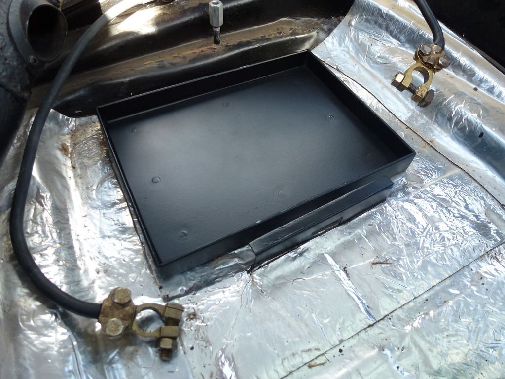

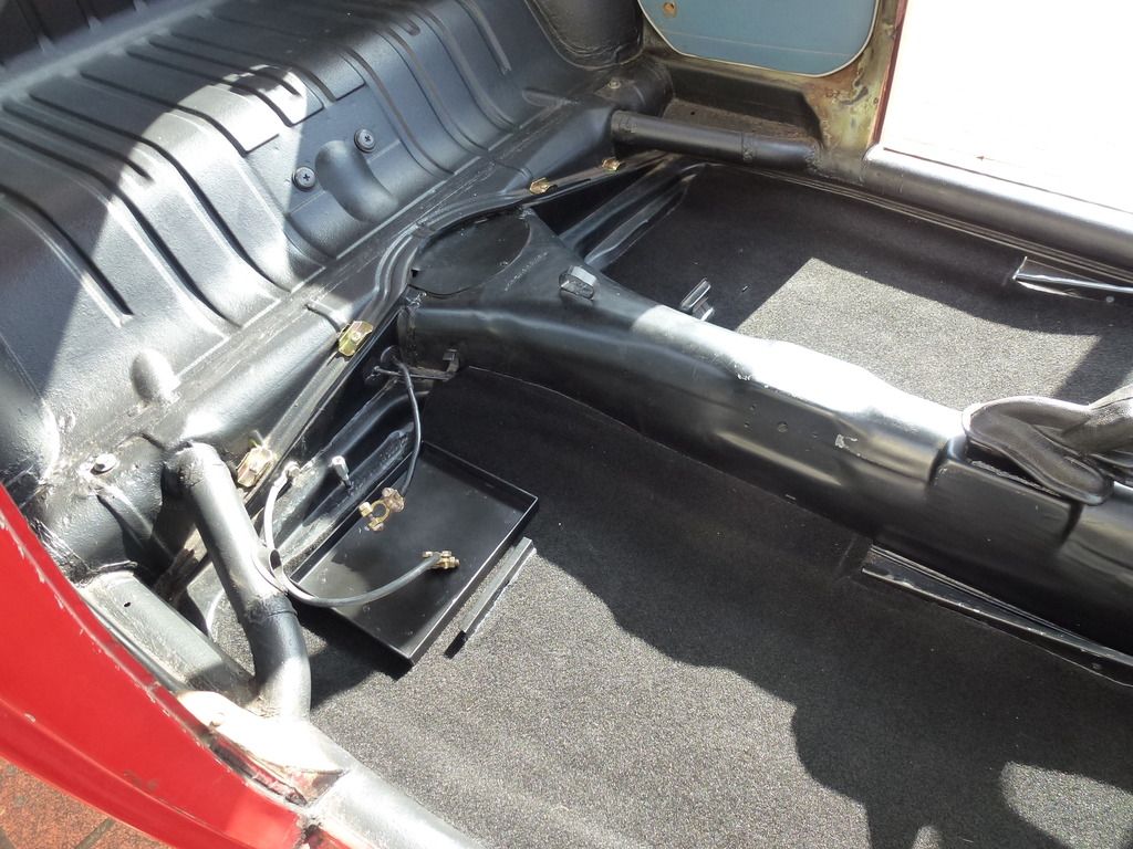

Made a battery tray. I have seen a lot of bugs rusted under the battery so I thought that a steel tray might help with rust.
http://i1062.photobucket.com/albums/t500/M4CO_23/P1070476_zpsckgb4ztj.jpg~original

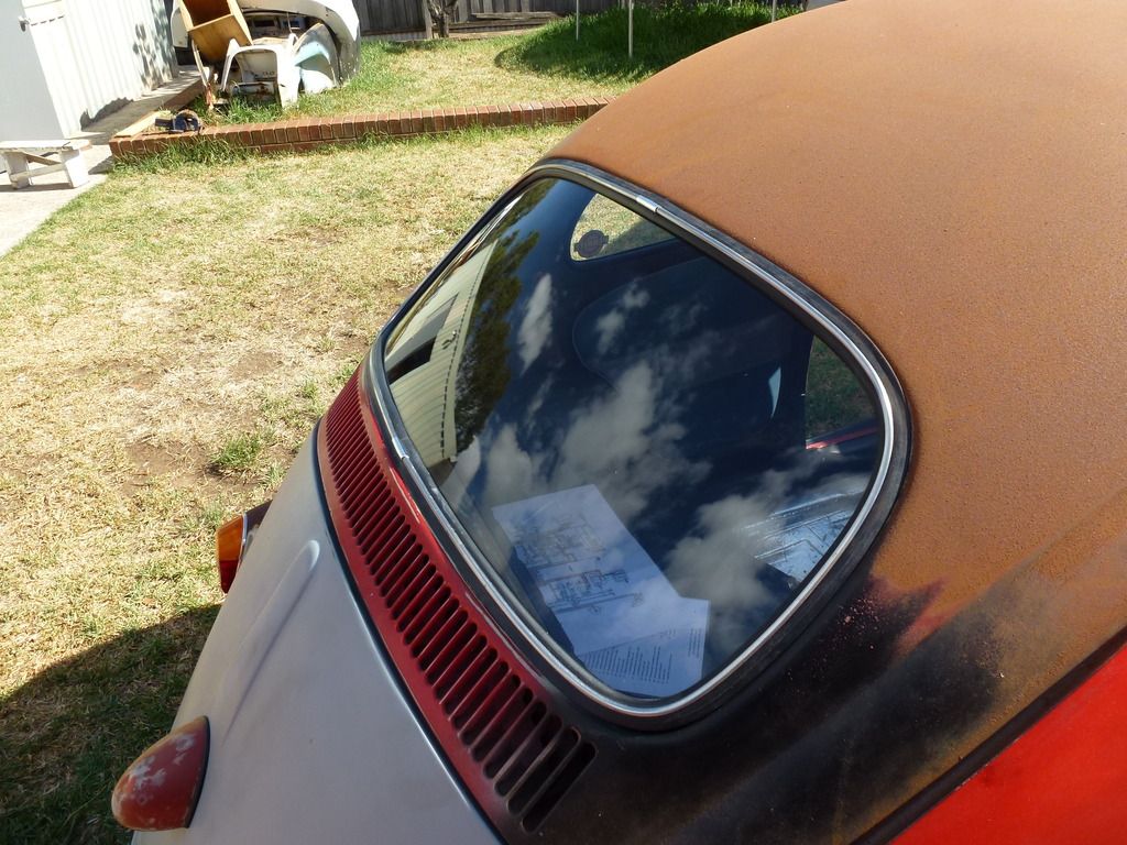

Rear window in
http://i1062.photobucket.com/albums/t500/M4CO_23/P1070477_zpsoittp7av.jpg~original

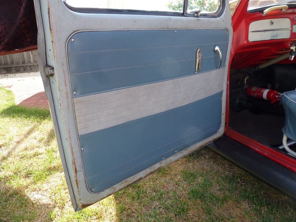

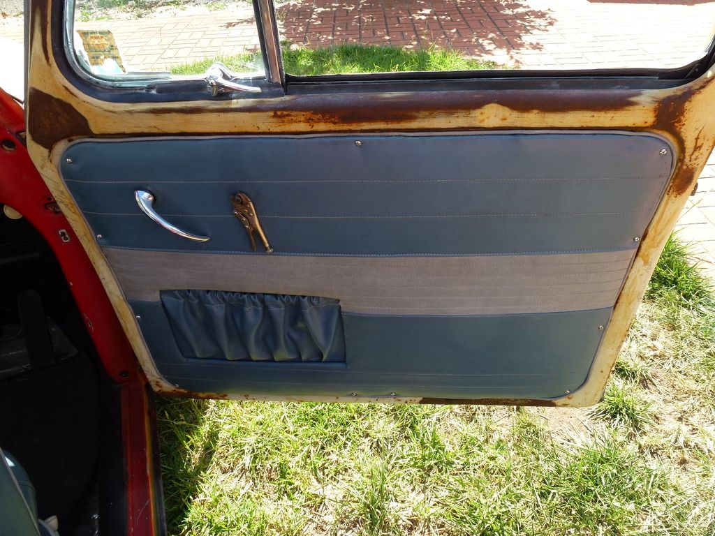

Door cards redone. I didn't want to play around with the clips that were used to hold the door cards into position. They make a weak point in the masonite and usually break when you go to pull them off. I just used some stainless self tapping screws.
http://i1062.photobucket.com/albums/t500/M4CO_23/P1070478_zpsnyhlkxvw.jpg~original
http://i1062.photobucket.com/albums/t500/M4CO_23/P1070479_zpst5nluztu.jpg~original

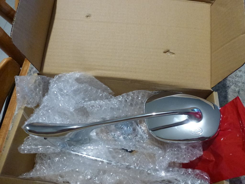

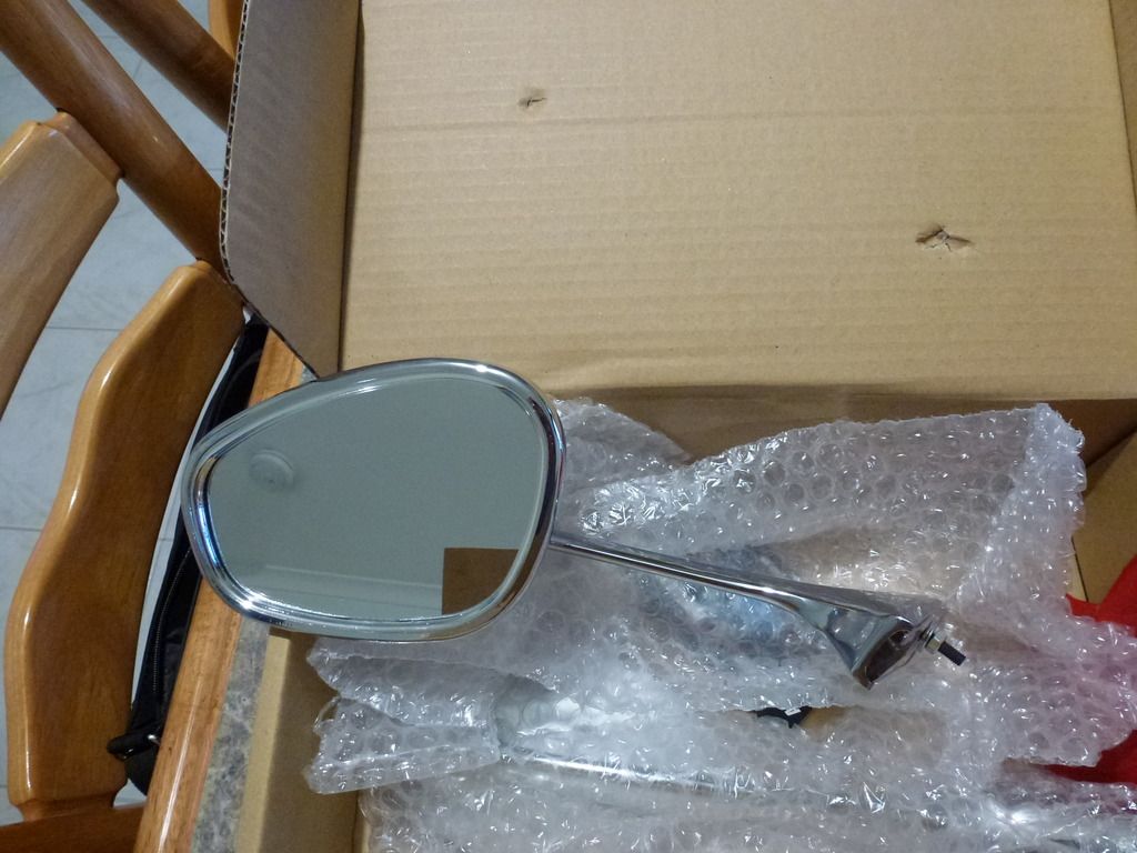

And got some swan neck mirrors.
http://i1062.photobucket.com/albums/t500/M4CO_23/P1070480_zpssu7uitor.jpg~original
http://i1062.photobucket.com/albums/t500/M4CO_23/P1070481_zpsifcimx9z.jpg~original

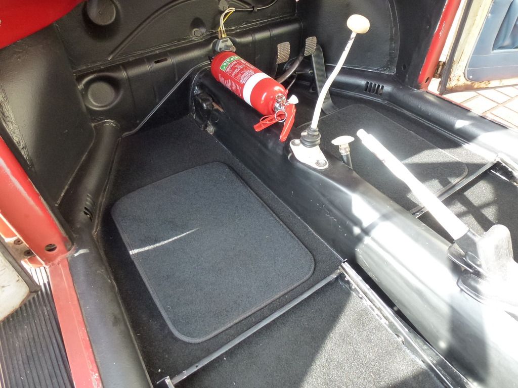

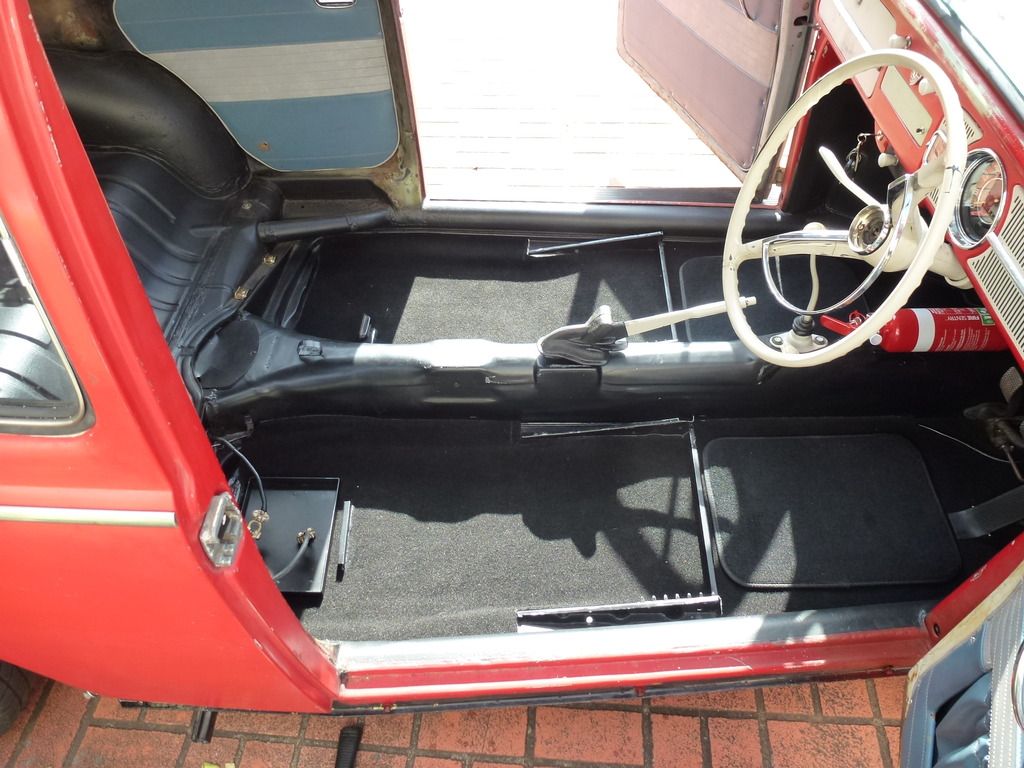

Installed some carpet today
http://i1062.photobucket.com/albums/t500/M4CO_23/P1070484_zpshju9lbob.jpg~original
http://i1062.photobucket.com/albums/t500/M4CO_23/P1070486_zpspffj4ira.jpg~original
http://i1062.photobucket.com/albums/t500/M4CO_23/P1070482_zpsl3hss6ka.jpg~original

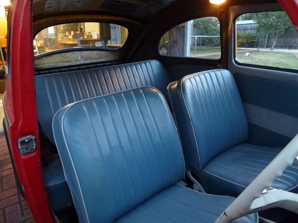

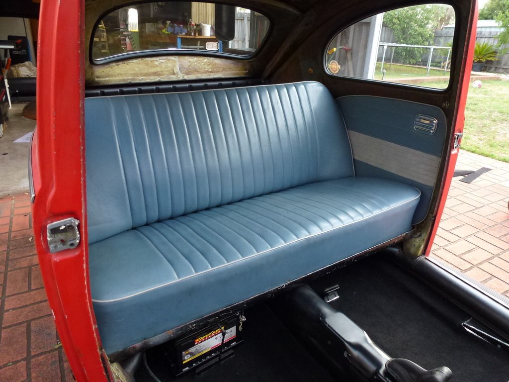

and the rear seats
http://i1062.photobucket.com/albums/t500/M4CO_23/P1070488_zps6s1am8r0.jpg~original

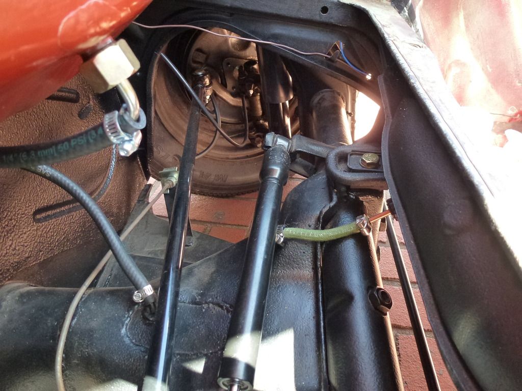

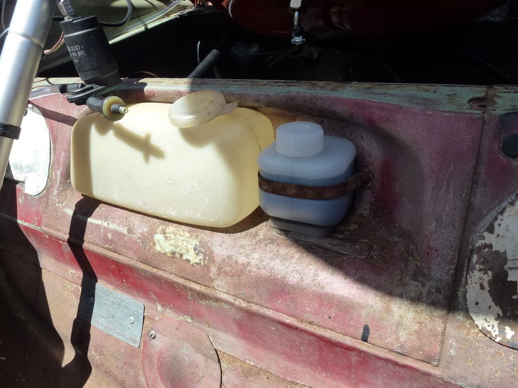

I had to buy a new brake fluid reservoir as mine had a pin hole at the bottom and was leaking fluid, I also had a dodgy pvc pipe connecting it to the steel line.
New reservoir and brake hose line
http://i1062.photobucket.com/albums/t500/M4CO_23/P1070538_zpslhgeihcp.jpg~original
http://i1062.photobucket.com/albums/t500/M4CO_23/P1070537_zpsx1s17dli.jpg~original

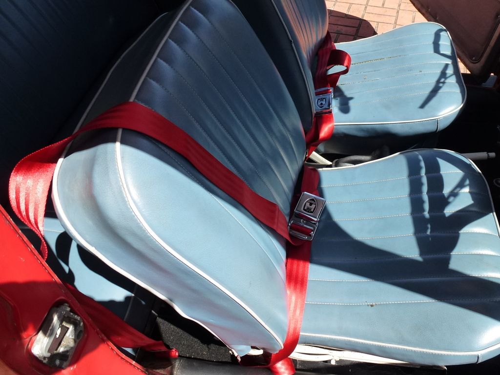

Also bought some new seat belts as mine were fraying and I don't think that they will pass a roadworthy check
http://i1062.photobucket.com/albums/t500/M4CO_23/P1070540_zpsf9j66oow.jpg~original

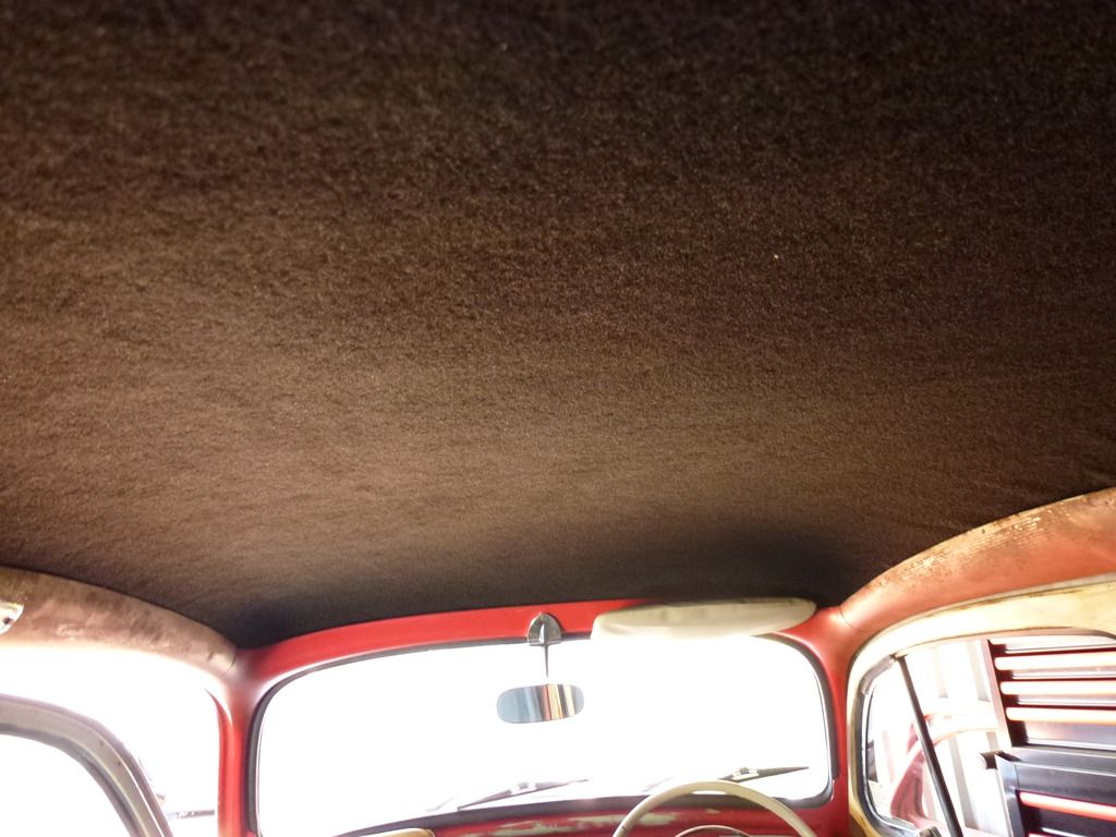

Installed the headliner. I was going to leave it like this but I want to cover it in some old coffee hessian bags that I have.
http://i1062.photobucket.com/albums/t500/M4CO_23/P1070564_zpseccdgnd7.jpg~original

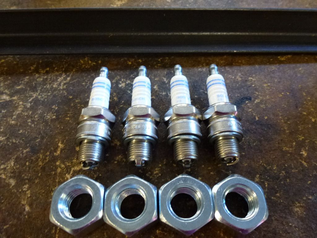

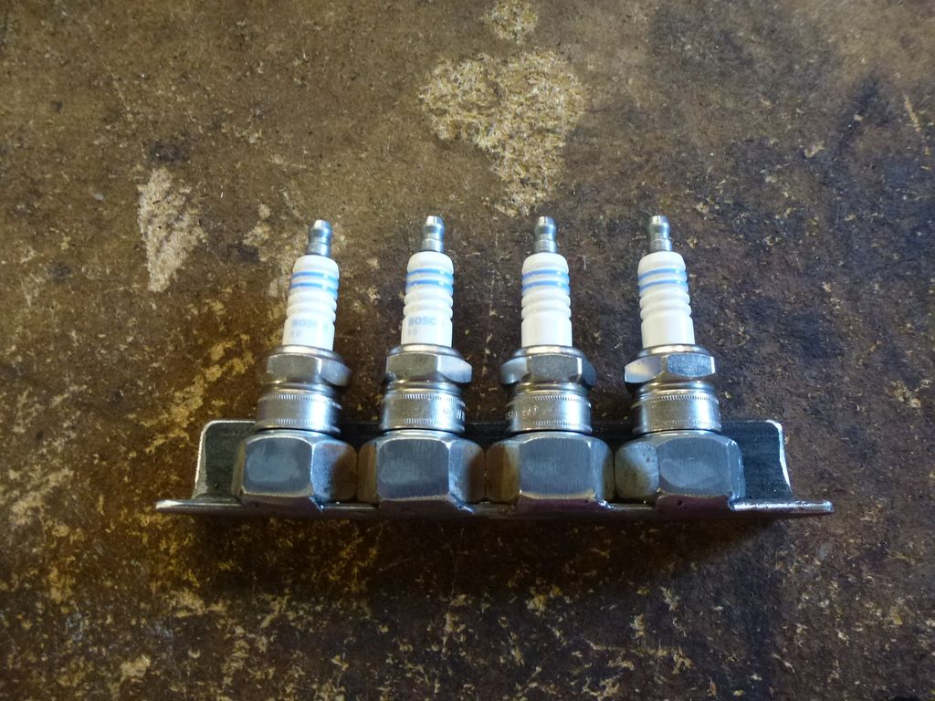

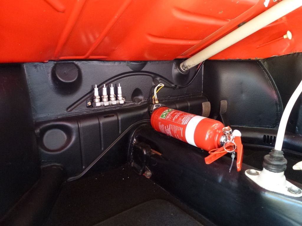

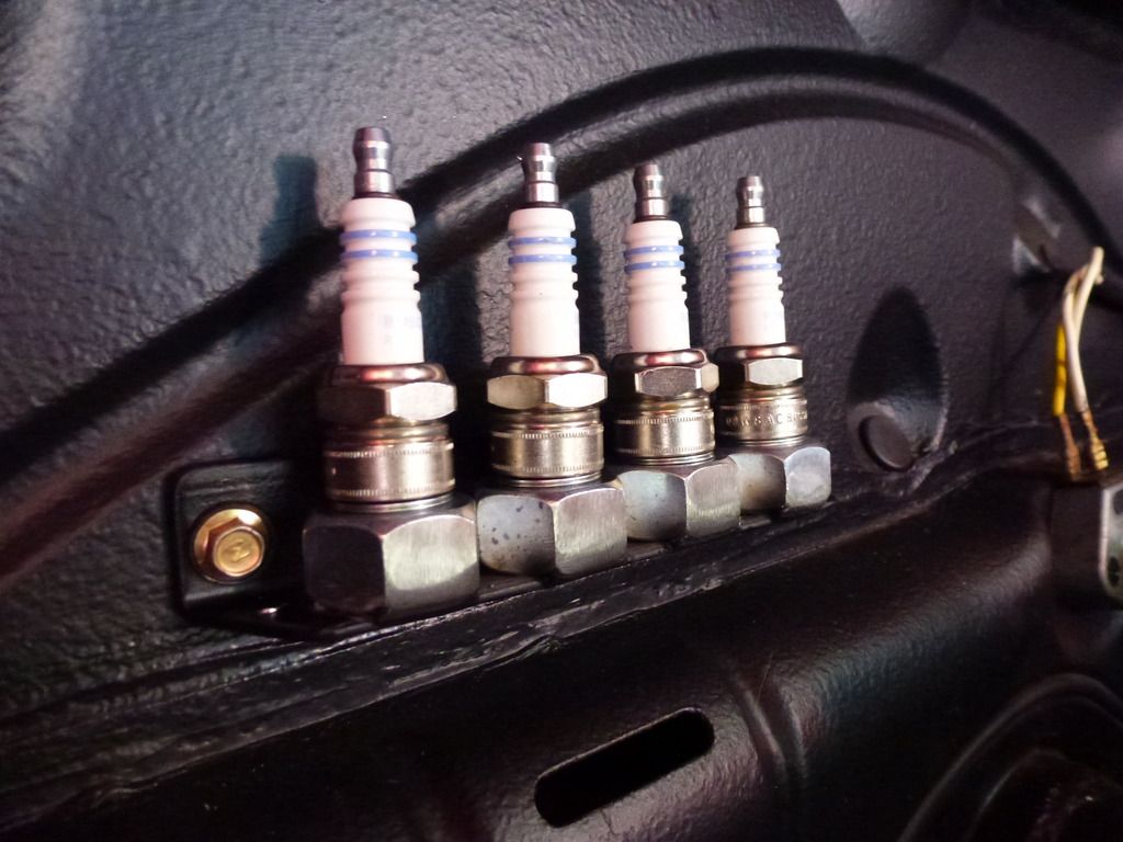

I also made up a spark plug holder. I saw Air Cooled Accessories have a billet holder but I wanted to see if I could make something similar.
I had some 5/16 nuts, angle iron, and spark plugs. The nuts don't have the correct thread pitch but they are a little bigger so the plug threads just catch on a thread or two and just snug up finger tight so I don't damage the threads.
http://i1062.photobucket.com/albums/t500/M4CO_23/P1070544_zpsaizjmgj0.jpg~original
http://i1062.photobucket.com/albums/t500/M4CO_23/P1070549_zpsl1tajazx.jpg~original
http://i1062.photobucket.com/albums/t500/M4CO_23/P1070550_zps2o8as02t.jpg~original
http://i1062.photobucket.com/albums/t500/M4CO_23/P1070554_zpskmhrwaml.jpg~original

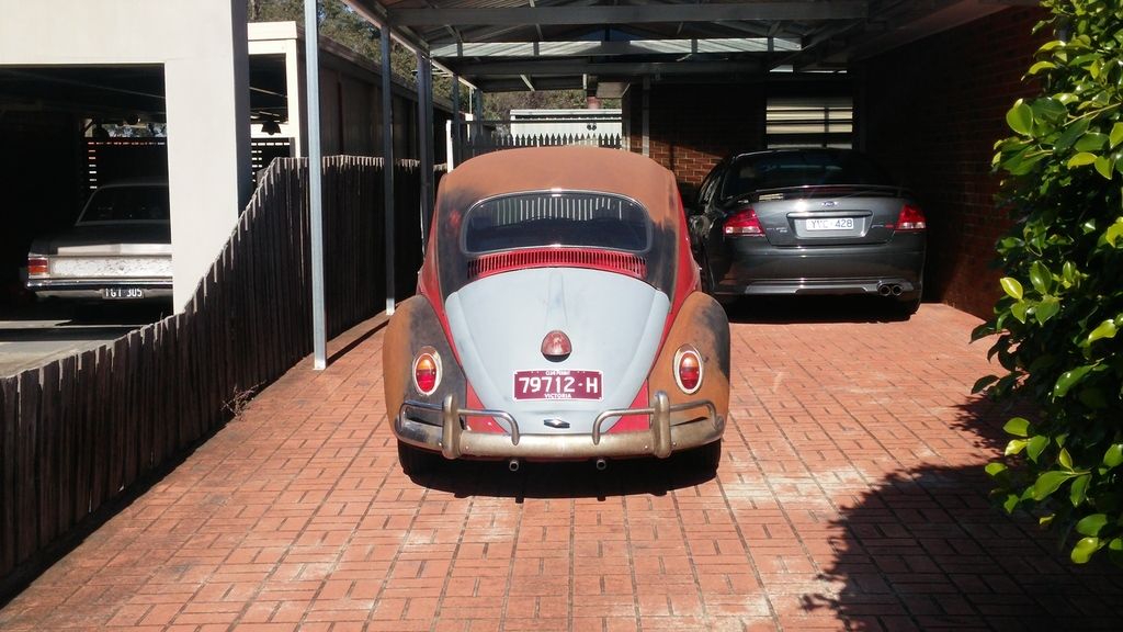

http://i1062.photobucket.com/albums/t500/M4CO_23/DSC_0527_zpskbczyyjg.jpg~original
http://i1062.photobucket.com/albums/t500/M4CO_23/DSC_0538_zps22rjbgse.jpg~original
http://i1062.photobucket.com/albums/t500/M4CO_23/DSC_0535_zpsz2adx8w0.jpg~original
http://i1062.photobucket.com/albums/t500/M4CO_23/DSC_0549_zpswjzzptph.jpg~original
http://i1062.photobucket.com/albums/t500/M4CO_23/DSC_0547_zpsfkkcgptx.jpg~original
Now just need to find a bonnet latch and it's time for a roadworthy!

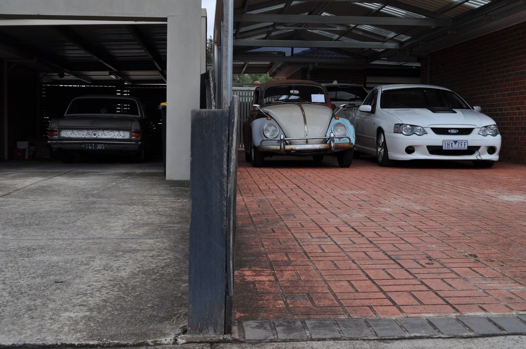

I took it for a spin today, about 30km and it went fine. I backed off the timing a little more and its happy.
Quick snap of it in the driveway next to my XR8. Quite a difference in power and handling :lol:
Neighbor also has a pretty cool HD Holden.
http://i1062.photobucket.com/albums/t500/M4CO_23/DSC_0553_zpsybxzhtlo.jpg~original

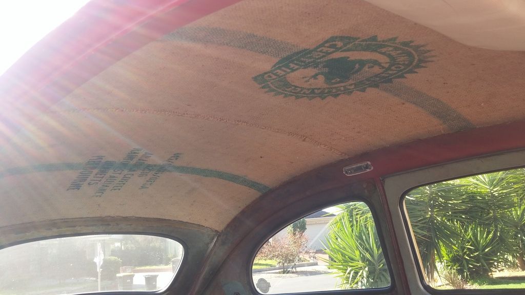

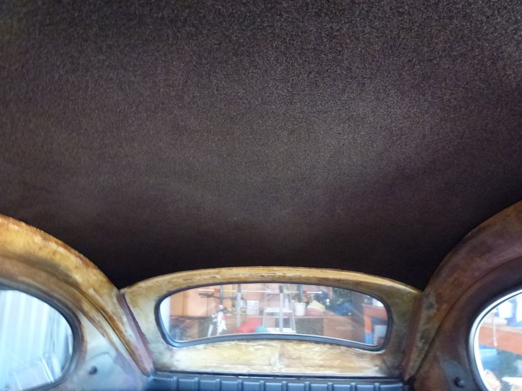

The Beetle is finished and has been on the road for a while. Now looking for a new Beetle project, thinking of an oval or another square window but with good brakes and a performance engine.
Also re-did the headliner.
http://i1062.photobucket.com/albums/t500/M4CO_23/20170510_125719_zpspxpvredr.jpg~original
http://i1062.photobucket.com/albums/t500/M4CO_23/20170510_125710_zpsaywwaw1d.jpg~original
