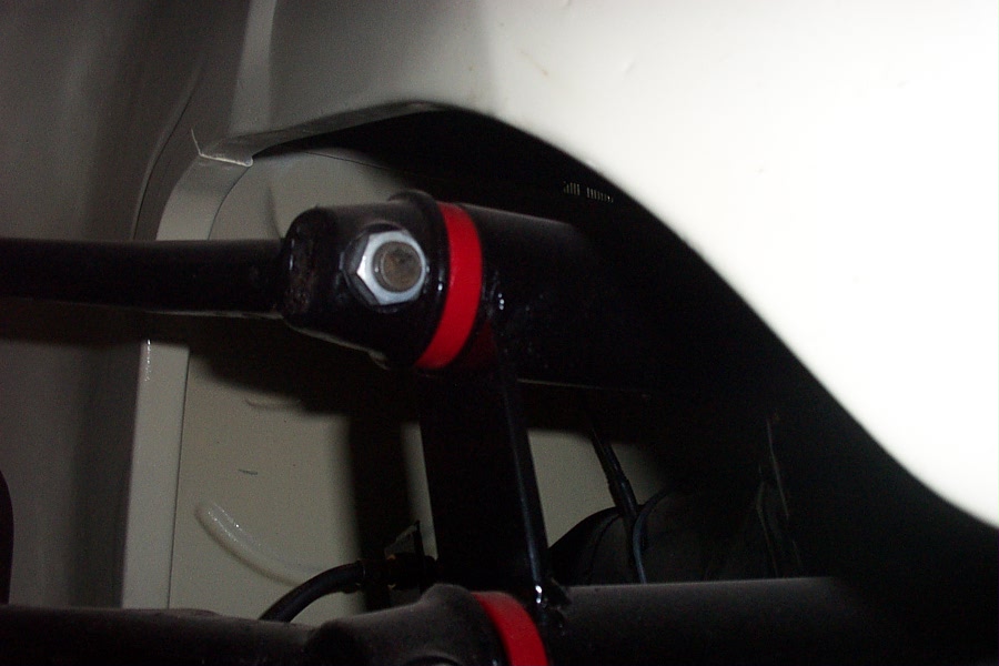

heres a little something.
Scott R.

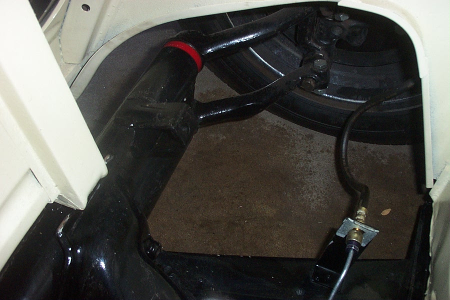

posted on October 8th, 2003 at 05:04 PM
Scott R.

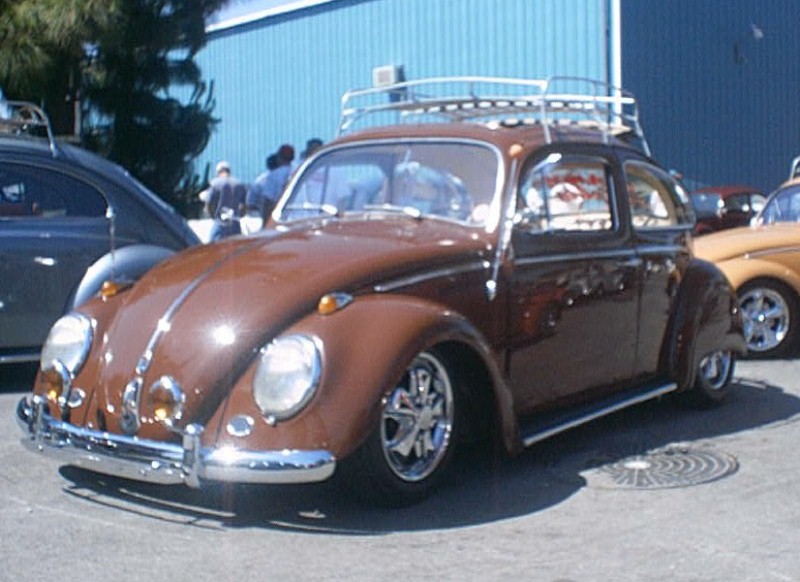

posted on October 8th, 2003 at 05:16 PM
if you look closely, the white car in the front is my bucket right after i got it narrowed. you cant even see that there is a five spoke inside there. Also, oval fenders are 3/4 of an inch wider than a later fender. Im shaving off the bullets ( the vintage guys hate me, lol) and putting italian turnsignals on.

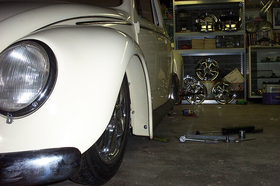

posted on October 8th, 2003 at 05:19 PM
the bucket the way it looked 2 days ago. i started stripping the crap off of it, i might just roll it around in bare metal. and its got a 5 inch narrowed beam WITHOUT SHOCK TOWERS, dropped spindles, castor shims, quicksteer, and of course 135's. and it rides better than stock.

Originally posted by Trayle D. the real oggfk
Lets just clear the miths from the facts. Shocks do not hold your car up. They are merely a dampening device. The are to keep the wheels on the road. Running without shocks is not dangerous, it can be uncomfortable in some cases, but not dangerous. The comment earlier about the front end of the car being ready to crack off has nothing to do with a beam narrowed without shocks. It would actually be safe to say that because of the added tension that shocks add to your suspension, running shocks would have done this more than not running them So this makes no sence. Think about it.
Now my name is Trayle Duncan, you may or may not have read my name in Volksworld, VW trends, Hot VWs, and other international publications. My business is suspensions. I have a degree in Automotive and Automotive technology so my knowlegde is based in theory as much as experience. Now having said this I have narrowed no less than 100 beams over the years, ranging from as little as 1 inch to as much a 7 inches.
On a link pin beam narrowed less than 4 inches custom shock towers are an option. Though the closer you get to 4 inches the less they(shocks) become relivant. More than 4 inches and the need for them compared to the cost and labor involve in manufacturing a custom tower to miss the body makes no sence. It has been mentioned by someone here that narrowing the Leafs(some call them torsions) stiffens the ride. This is true. It also lesses the sping. So by narrowing a beam you are stiffening sping tension. thus lessening the need for a dampening devise. You wouldnt need a dampner(shock) on a car with a straight axle and no suppension would you? It would be useless. I invite any of you to come and take a ride in any car that has been installed with one of my beams without shock towers. You will be singing a completely different tune than what Ive read here.
There are lots of ways to make a narrowed beam ride well. I can make a narrowed beam without shocktowers ride so well that you would swear by them. There are angles that are built into a stock beam that must be reset when you add adjusters. You cant just set the adjusters where you want the car to sit and be done. You much have one beam tension fighting the other. "Steering axis inclination" is big part of handling. So proper shiming of the spindles is a must. Caster is a big part of drivability. Caster is a angle that is built into the beam. Its the anlge that the king pin sits in relation to the car. So shiming the beam to regain proper and OE spec. caster is a must. And on a narrowed beam a good(new) steering dampner is a must. Other wise you will have bad bumpsteer. The front end of a beetle weighs next to nothing. Seiously a mear weakling and lifted the weight of the car off the suspension. So by increasing the sping tension in the beam on a car that is so light you lessen the need for shocks. Ive been doing this for almost 10 years and have not had one complaint. People never believe it can be possible. But it quite simply is.
Now having said this, this is not true for a bus (splitty). The front of a bus weighs supstancialy more than a beetle and needs something to dampened spings from bouncing under the weight of the car.

Trayle, Isnt it "easier" to narrow a bus beam and keep the shoch towers anyway, due to the fact the shock towers are quite wide, so therefore getting your narrowing out of that section, while retaining your shock mount?

I make custome shock towers out of 3/8 inch plate steel for my bus beams. A bus beam is narrowed a little differently than a bug beam.

The reason its easier to narrow a bus beam and keep shock towers is because there is like 3 inches of beam outside of the mount to the body. So you can loose that much meat from the beam and still have room for custom towers. Like I said, becuase of the wieght of a bus shocks are a must.

Nic the dampner will clear the tank no problem. It mounts to the inside tierod end and to the beam itself.
Hers a shot of a 6" beam from under the tank.
