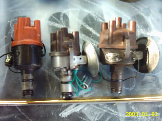

the yanks have been using half shrouds for years on there rails it's not that hard with the oil cooler removed and placed elsewere with a fan than all the shit removed from inside it gives a better air flow to 3&4 cylinders so it actually cools better
and the dissy in the picture is not the one being used i'm using a dissy of a 61-67 bug whitch are 1.5 inches shorter
no big mysterss just homne work and asking the right people

posted on October 9th, 2006 at 12:29 PM
the pulley was from a trash and tresure i just kept my beady little eyes open but ya could get em from an engerning supplier
http://i54.photobucket.com/albums/g104/greedy53/IMG_0011.jpg
http://i54.photobucket.com/albums/g104/greedy53/IMG_0010.jpg
http://i54.photobucket.com/albums/g104/greedy53/IMG_0007-4.jpg
http://i54.photobucket.com/albums/g104/greedy53/IMG_0006-2.jpg
http://i54.photobucket.com/albums/g104/greedy53/IMG_0002-2.jpg
http://i54.photobucket.com/albums/g104/greedy53/IMG_0012.jpg
and these are the dissys thqat i had to pick from
you may have noticed that one pulley was made from a genny pulley set
[ Edited on 9-10-2006 by greedy53 ]
