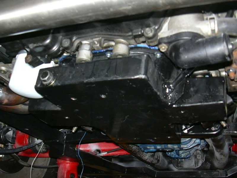

Sharpbuilt sell shortened sumps which have the original baffles and surge plate in it. Uses the original dip stick and comes with a shortened oil pickup. Costs $430 exchange.
http://www.pa.com.au/tmp/forum/sump.jpg
Sharpbuilt V2, EJ25, Subaru 5 Speed, Falcon rear discs, Heater & A/C, Rack Steering

mmmm do they do one that goes on the bottom of the engine as well or just on the top ?
Brad
Meyers Manx Australia
MemberBlueV2
A.k.a.: Mark
Posts: 193
Threads: 15
Registered: April 22nd, 2008
Location: Blacktown - Sydney
posted on August 4th, 2008 at 06:12 PM
hehe. Its easier to fit them on the top....saves having to get under the motor and get dirty and stuff... :lol:

I received my sump today from Bugsat5speed, thanks to Mike H for going to all the trouble to organise a group buy. I'm very happy with it and cant wait to fit it.
Thanx for the posetive comments Steve! Will do a picture trade when we fit ours to the new buggy!!!:punk:
