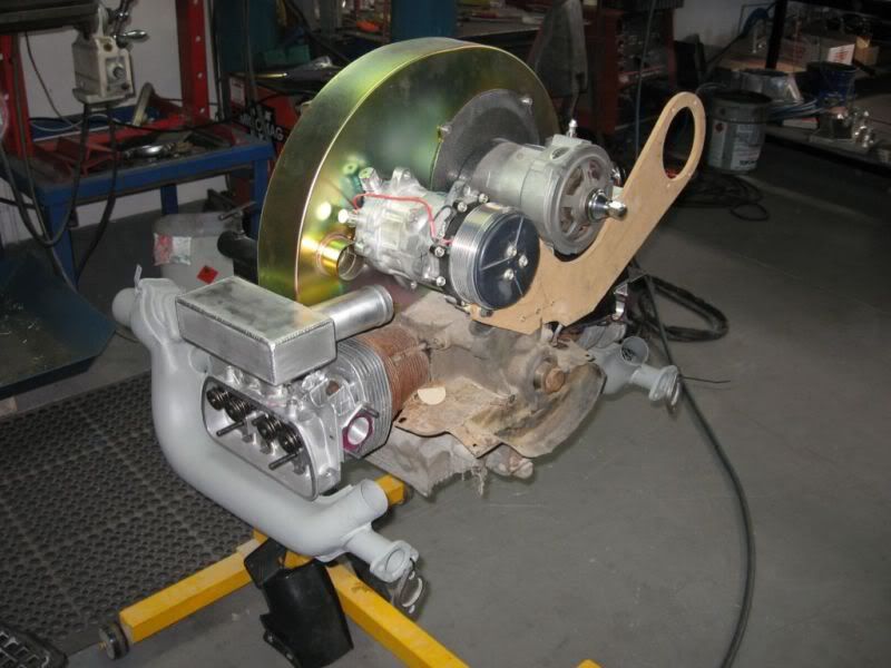

Interesting setup Al...(good interesting that is)
only comment...face plate from 10mm steel + gussets. That's fairly robust.

Cheers for the link Adam - will check them out (looks like there is one that is pretty much bang on to the dimensions we have been working with).
Stanley - you are right the faceplate is pretty thick (to provide the necessary support)....the front will have holes/slots machined into it to lighten both the weight and/or aesthetic "heaviness" to it.

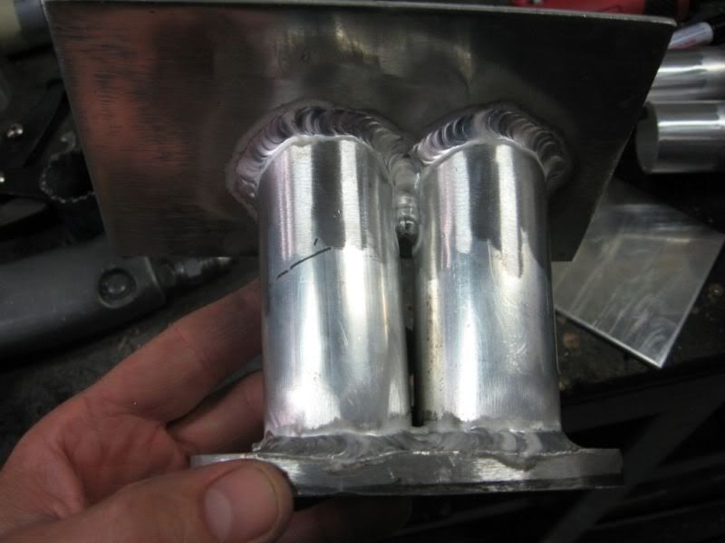

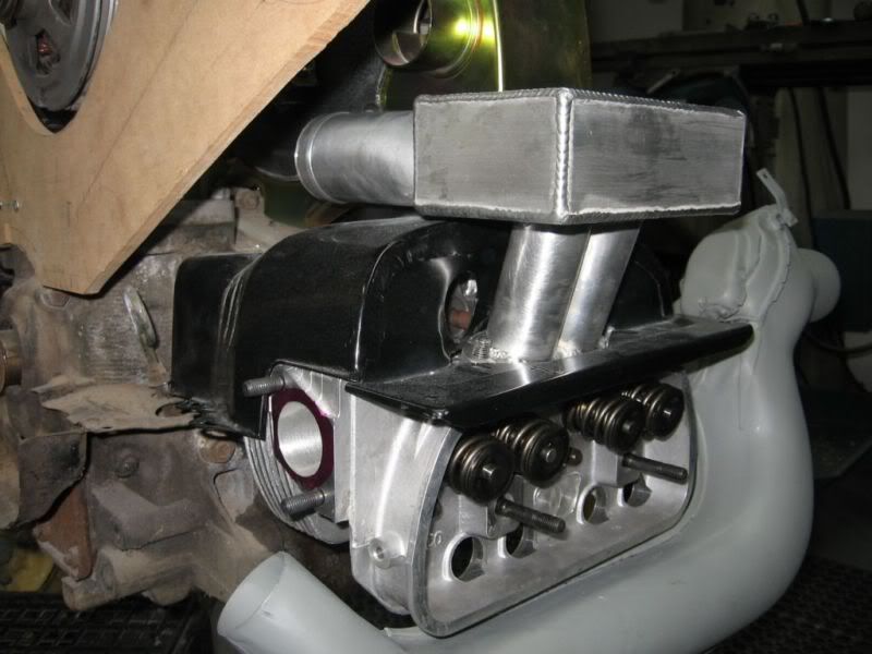

Mounting plates for inlet manifolds were fab'ed from aluminium and match ported reasonably closely using manifold gasket as guide. They were faced after welding (the marker pen makes them look wobbly but its an optical illusion)
http://i10.photobucket.com/albums/a145/Dasdubber/Jun4inletmanifold1.jpg

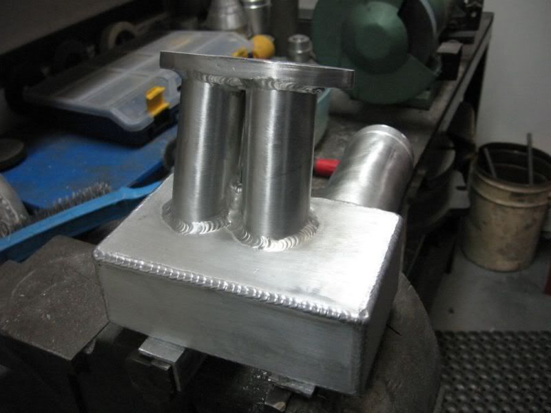

Plenums ended up as rectangular box sections instead of round tube - tops of runners were bellmouthed.
http://i10.photobucket.com/albums/a145/Dasdubber/Jun4inletmanifold2.jpg
http://i10.photobucket.com/albums/a145/Dasdubber/Jun4inletmanifold3.jpg
1 1/2in heater boxes were trial fitted as the bus will still run operational heaters.
http://i10.photobucket.com/albums/a145/Dasdubber/Jun4inletmanifold4.jpg
http://i10.photobucket.com/albums/a145/Dasdubber/Jun4inletplenums.jpg

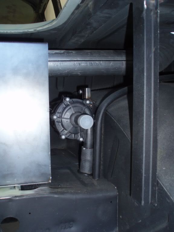

We are in the process of making the custom fuel tank with the width and height taking into account other ancillaries that need to be mounted in the engine bay like the intercooler water pump
http://i10.photobucket.com/albums/a145/Dasdubber/Jun16waterpumpmount.jpg

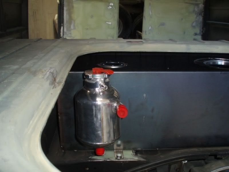

PWR water reservoir was mounted onto the front face of the tank (hence why steel was used - easier to work with when it acts as a mounting surface as well as a tank)

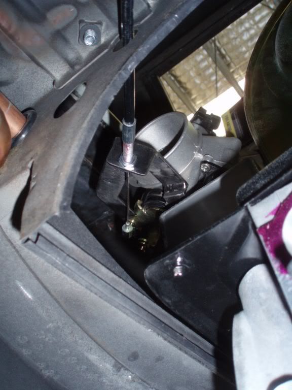

Throttle cable setup is close to finalisation although supercharger will move in towards the fan shroud 15-20mm so the front engine plate is still just the first laser cut mockup, it needs a little adjustment here and there.
http://i10.photobucket.com/albums/a145/Dasdubber/Jun22throttlework2-Copy.jpg

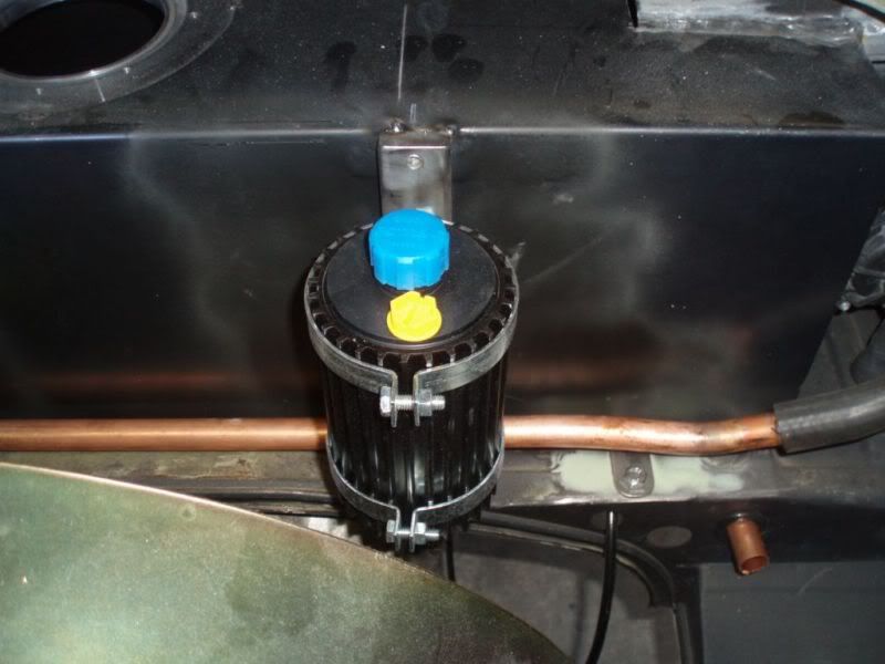

Supercharger oil reservoir also mounted on tank. Oil lines (copper) will all be removed and painted later - due to the length of some of the runs we wanted to use hardline where possible to minimise internal friction/resistance.
http://i10.photobucket.com/albums/a145/Dasdubber/Jun23superchargeroilreservoir.jpg

Looking good there Al, but I have a question..... Why the rectangular plenums?

Rob who was doing the fab work made that decision - I prefer the look of round plenums however it was easier and quicker with the material he had available to go rectangular at that time. Unless someone knows there is a big functional difference between the round vs rectangular I'd say they will stay as is.

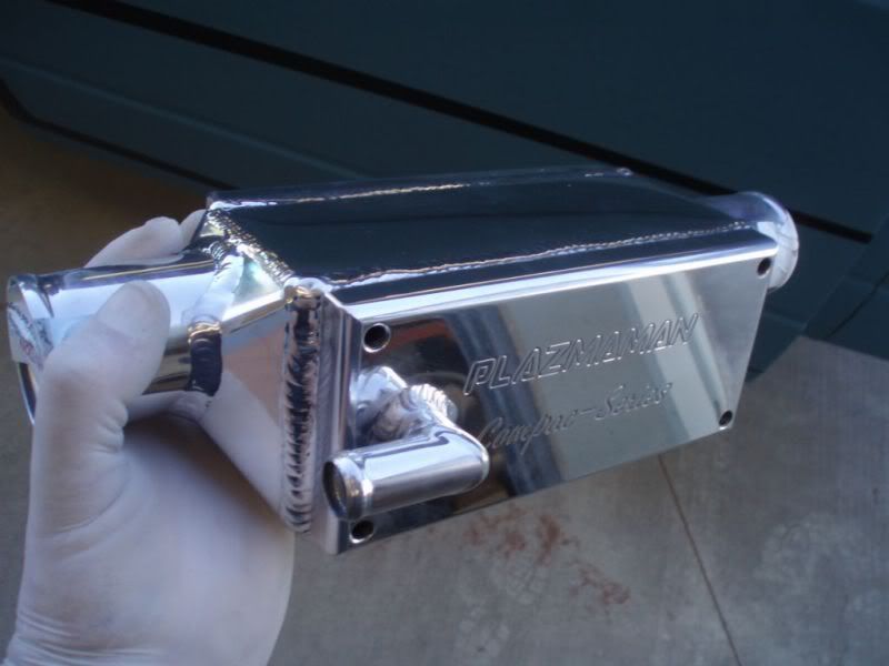

The Plazmaman water to air intercooler was fabricated recently:
http://i10.photobucket.com/albums/a145/Dasdubber/Aug3intercooler1.jpg

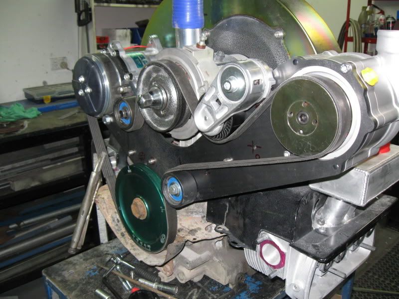

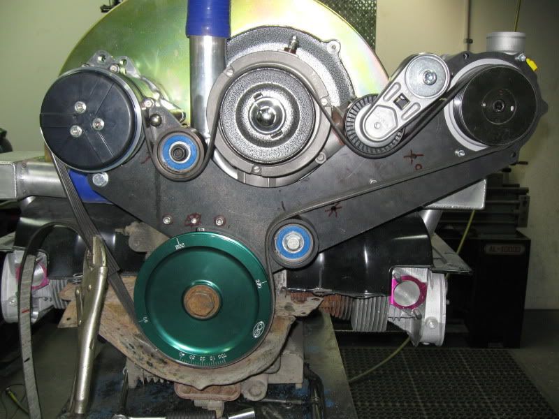

Pulleys (6PV belt) haven't been machined yet (CAD drawings required slight adjustment) however idler and tensioner pulleys were all aligned with the new laser cut front plate (this will go through one final change with slots cut out etc). Laser was used to align pulleys
http://i10.photobucket.com/albums/a145/Dasdubber/Aug4laserpulleyalignment.jpg
This gives you an idea of the belt run:
http://i10.photobucket.com/albums/a145/Dasdubber/Aug4serpentinemockup1.jpg
http://i10.photobucket.com/albums/a145/Dasdubber/Aug4serpentinemockup2.jpg

Membervassy66T1
A.k.a.: Marcus Vass
Wow ... are U reading this?
Posts: 2120
Registered: June 4th, 2003
Location: Brisvegas
Mood: Happy to own a VW
posted on August 6th, 2010 at 08:49 AM
Looking good Al.
Nice belt set up.
Not worried about heat build up with the heater boxes?

Hey Allan, just a question with the mounting plate, it looks like theres only two bolts holding that, it that right or are there more??

Hey Marcus, heat is always a consideration - however the rest of the motor will remain relatively mild including cam and compression and with only 7 to 8psi of boost, head temps should remain under control. The heater boxes are the 1 1/2 inch flanged variety rather than stock internall diameter ones so exhaust flow shouldn't be restricted excessively. External oil cooler with thermostat and fan will help to a degree (pardon the pun).
Troy, we didn't get any shots from the back but the two bolts above the crank pulley attach the face plate to one gusset that ties into the fuel pump stud locations, and there are an additional two bolts (I think only one bolt in at time of pictures) between the crank and supercharger pulleys that attach a secondary gusset that ties back to at least two (possibly three) alternator stand studs).
