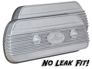

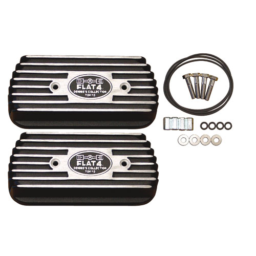

or you could get some nice ones...
http://www.classicveedub.com.au/SpareParts/Parts_Results_Monthly_Specials.asp...
http://www.classicveedub.com.au/images/SpareParts/body_trim_parts/EG-164-B.jpg
(the flat 4 set... $150)
Or ... Classic also has CB ones for like $95...
http://www.classicveedub.com.au/images/SpareParts/engine_performance/1702d.jpg
