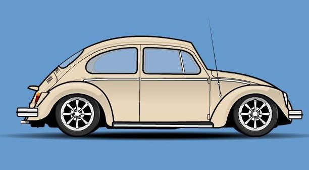

Here is the look I am trying to achieve
http://www.trainboard.com/railimages/data/1241/ScreenShot002.jpg
You will find the front tyres rubbing with Your front suspension down that low..
but smaller tyres will do the job... but will still look smaller...
with 165 x 85 x 15 on the front, You won't have to lower the front so far down...
and your speedo will be close to the mark..
If You don't have any large speed bumps or rough roads, You can go lower than My beetle's front..
when i had it lower...
turning and hitting a bump... would cause My tyres to rub on the guard lip ...
LEE
