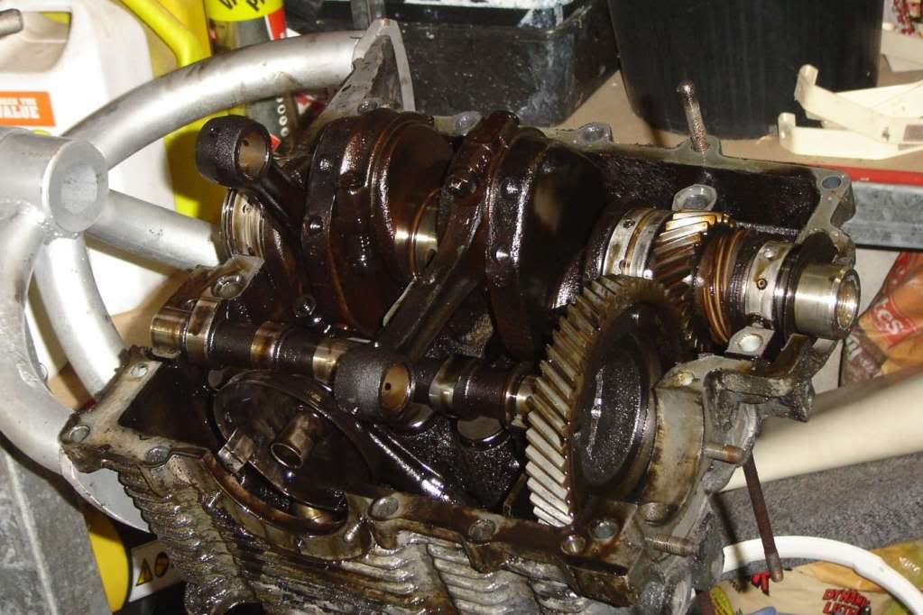

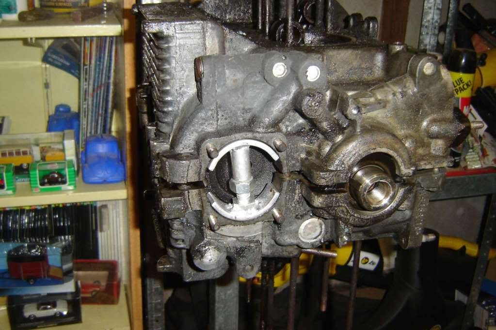

Church this morning, then a walk around Sydney Harbour National Park with the family, then managed to get started on the engine about 5pm. After loosening the bolts last night the oil pump came out with the oil pump puller as intended, and then I removed all the bolts (I thought), and started using the case splitter.
The case started splitting, but it would only go so far, and the whole thing didn't want to play like I hoped, so I stopped splitting afraid that I would do some damage to something.
After some stuffing around I turned the engine on the stand, and finally noticed under a pile of gunk was another bolt. I probably should have counted against the number specified in the manual, but being a boy I didn't bother.
So, surprise surprise, it actually came apart pretty easily once all the bolts were out, and now I have two engine halves. So now I have a lot of cleaning to do. I think given my current schedule that will start next weekend.
