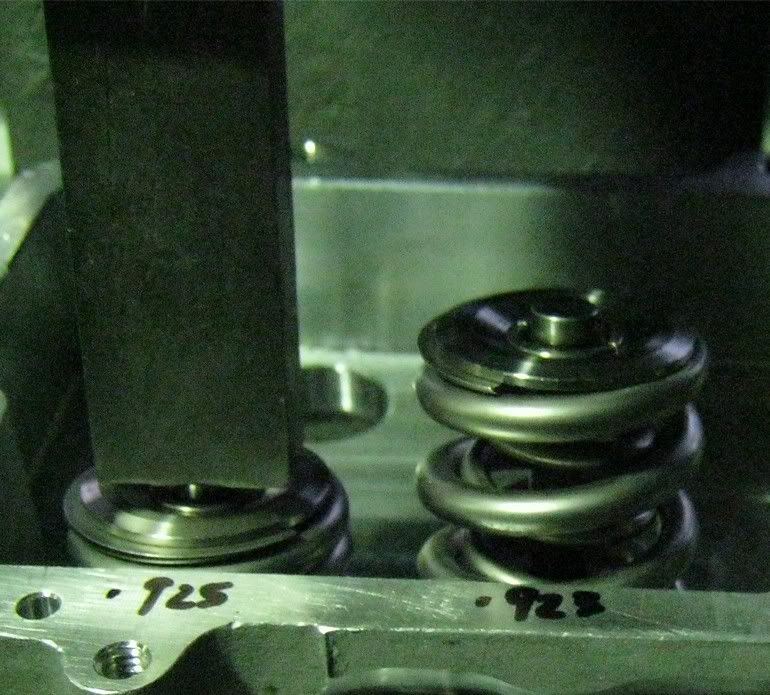

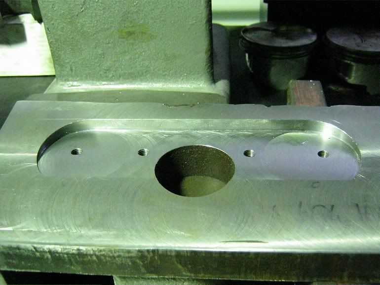

Set up the springs:
Needed to cut out a recess in my angle plate to clear the valves at full travel.(check for bind).
http://i113.photobucket.com/albums/n216/dangerous_05/IMG_2378.jpg

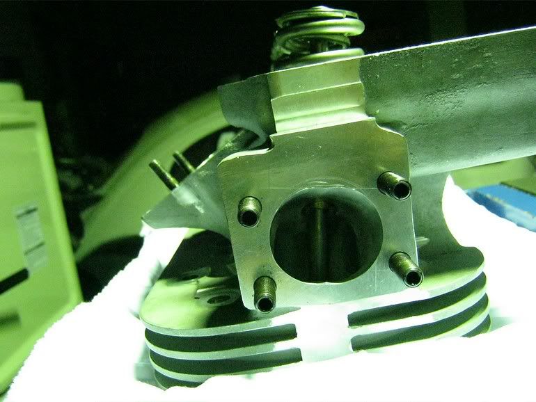

Seat pressure is 350, nose pressure is 900.
Lift is .710 inlet and .670 exhaust
Here is the exhaust port:
http://i113.photobucket.com/albums/n216/dangerous_05/IMG_2377.jpg

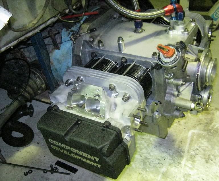

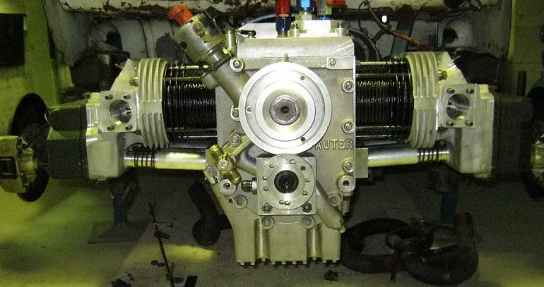

posted on June 8th, 2011 at 07:15 PM
http://i113.photobucket.com/albums/n216/dangerous_05/IMG_2453.jpg
http://i113.photobucket.com/albums/n216/dangerous_05/IMG_2451.jpg
http://i113.photobucket.com/albums/n216/dangerous_05/IMG_2454.jpg
Originally posted by westi
That's mad Alan.
MemberRISKY4LIFE
Posts: 308
Registered: July 4th, 2010
posted on June 8th, 2011 at 07:34 PM
OMG way sexy stuff LMAO :tu:
btw what is AUTER?

btw what is AUTER?
That would be Pauter.

Memberreub
VWRX is gone...
Posts: 2054
posted on June 8th, 2011 at 09:42 PM
Volksporn as always Dave.

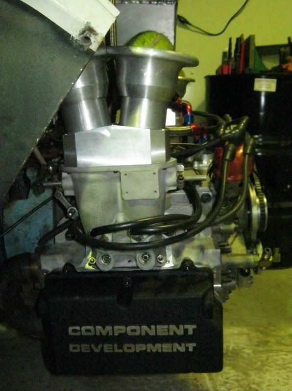

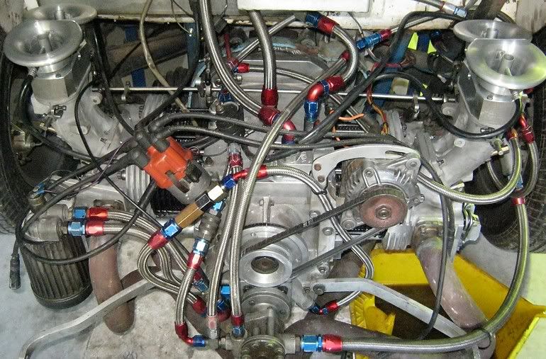

posted on June 9th, 2011 at 07:18 PM

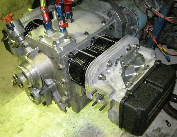

http://i113.photobucket.com/albums/n216/dangerous_05/IMG_2455.jpg
http://i113.photobucket.com/albums/n216/dangerous_05/IMG_2463.jpg
http://i113.photobucket.com/albums/n216/dangerous_05/IMG_2465.jpg
That's mad Alan.
posted on June 9th, 2011 at 07:25 PM
Awesome Dave, when do you fire her up?

posted on June 9th, 2011 at 07:54 PM
It's too shiny and showy mate!! Need to make the alloy dull off a bit lol
Can't wait to hear it in anger!!

posted on June 13th, 2011 at 04:34 PM
Yeah runs sweet, just have to book some dyno time now.

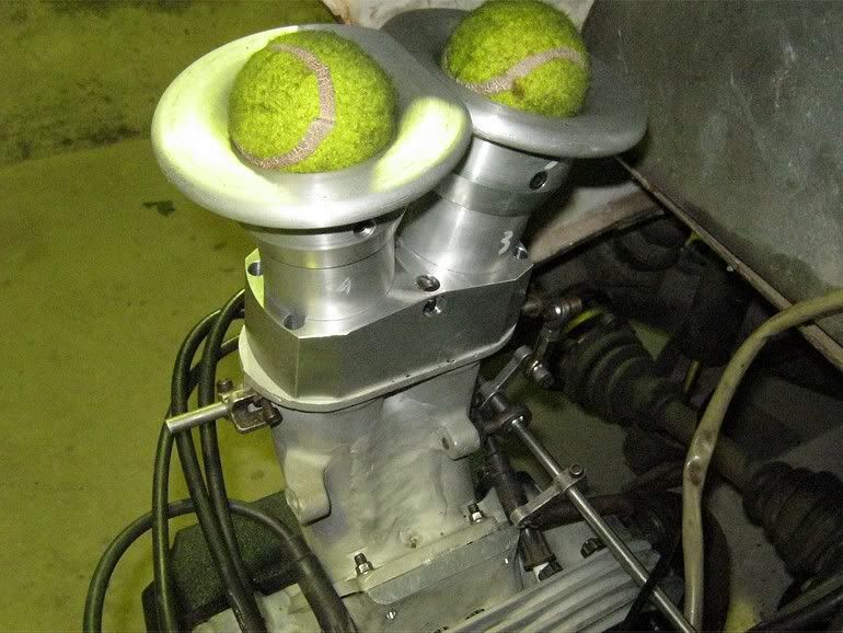

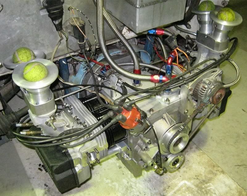

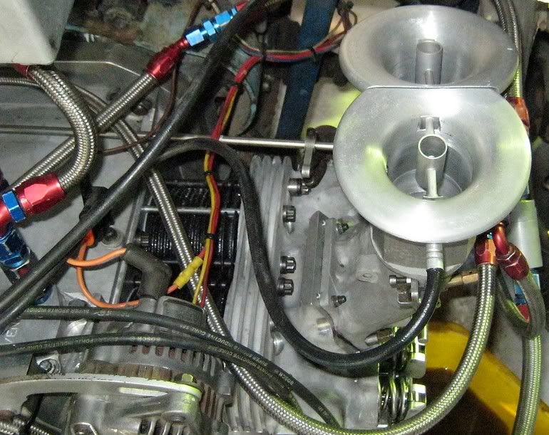

posted on June 25th, 2011 at 09:18 PM
Engine survived the dyno, but a bit low on power.
The gauges said it was still rich,(.79lamda) but lost power when leaned off.
Best of 222.1hp@7600.
Pushrods did the job as did the 900lbs springs.
More improvements to come.
More camshaft duration,(currently 264 degree),
better ignition(thinking MSD 8-plus)

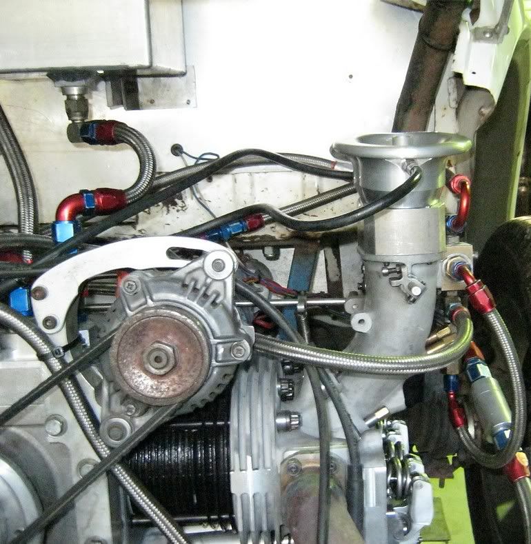

Aux venturis to adapt to the injection for better atomisation:
http://i113.photobucket.com/albums/n216/dangerous_05/IMG_2494-1.jpg
http://i113.photobucket.com/albums/n216/dangerous_05/IMG_2500-1.jpg
That's mad Alan.

Dave you are always on the edge and I'm damn glad of it. Have you ever thought about preheating your fuel so that it is on the edge of going from a liquid to a gas ? Mike McCarthy
MemberSides
A.k.a.: Dave Sidery
Posts: 2220
Registered: May 20th, 2007
posted on June 25th, 2011 at 11:47 PM
So adapting the aux vents in... you mean mounting little injectors inside them somehow ???
Would they be an always running sort of thing, or extra injectors somehow rigged (fuel pressure ?) to only operate lower in the revs ???
Also that MSD 8 Plus... 315-345 mJ... holy crap batman that's a lot of spark !!!
:punk:

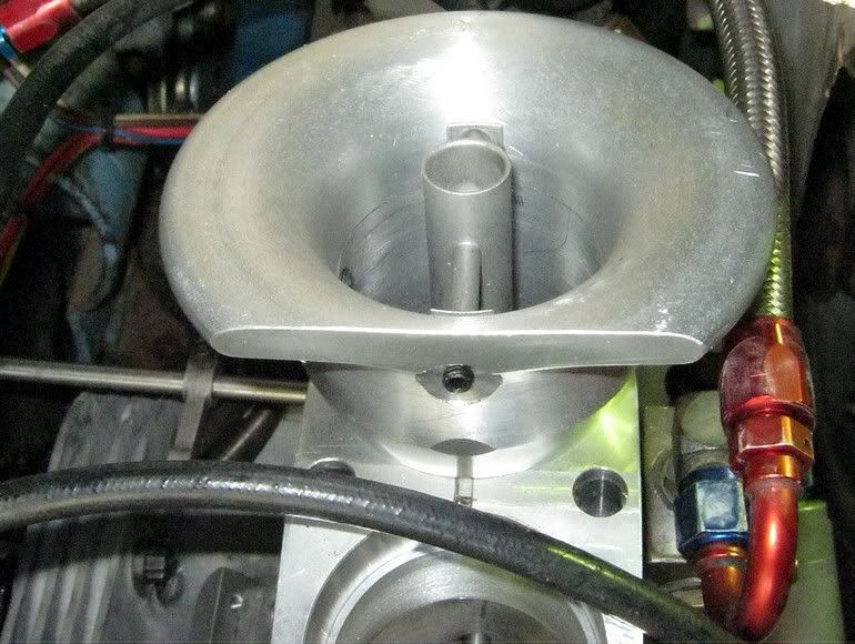

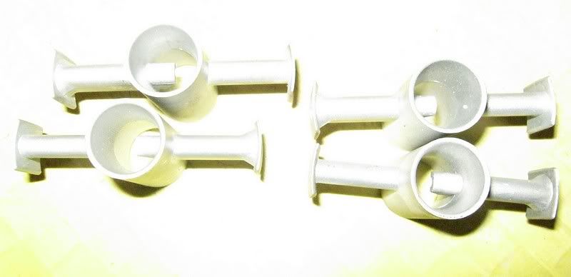

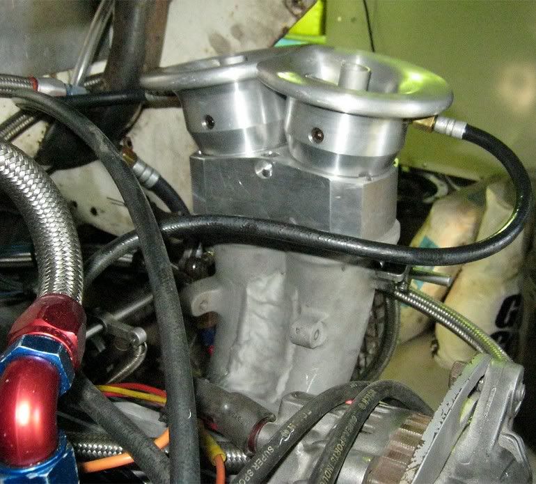

posted on June 26th, 2011 at 04:22 PM
A busy Sunday.
No more steam left, so finish it tomorrow.

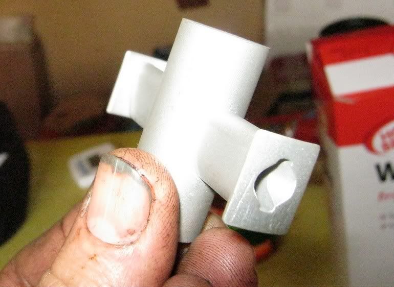

Dave,
the Aux venturi's are located in small slots cut into the port wall,
and held in by a grub screw,
then the constant flow nozzle squirts into the other end,
where the carb normally draws from the main jet well.
Hi Mike,
in theory the head temp should be enough to sort out the "turn to vapour",
but methanol can be a pain,
but any theory is worth trying if this gets ugly!

posted on June 26th, 2011 at 04:49 PM
I like the aux venturis.
Have you got your new cam yet?
MemberStanley
Posts: 4523
Threads: 270
Registered: March 13th, 2003
posted on June 26th, 2011 at 05:20 PM
looks like you've shortened the tubes as well....nice work.
Off to the dyno again?

posted on June 26th, 2011 at 05:56 PM
Hey Dave.
Do you think maybe the methanol may be taking up to much volume if it is placed all the way up the top. There fore maybe giving you less room for the air to occupy for a good a/ f ratio.
What do you reakon.

Memberwesti
what the
Posts: 1610
Threads: 28
Registered: August 30th, 2005
Location: milperra
Mood: not blue, pink
posted on June 26th, 2011 at 06:00 PM
I don't think fuel is the problem .I think it's the fuel taking up the room of the air.there for maybe some bigger manifolds .
Just througing it out there.
