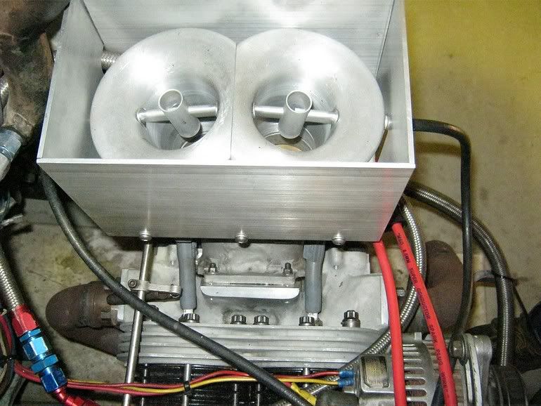

Do you think maybe the methanol may be taking up to much volume if it is placed all the way up the top. There fore maybe giving you less room for the air to occupy for a good a/ f ratio.
What do you reakon.
Yes good point Brad,
this is a problem with methanol period.
Not sure it will make much difference in 'space' whether it is injected either top or bottom,
unless it is injected direct into the chamber like the new Comodore engine.
The manifolds DO have a fair bit of cross section,
but there is always room to improve.
My theory with the better atomisation is just something I want to try,
and doubt very much it is the total answer, hence why I have other changes also in the works,
but if the fuel IS atomised better,
it will allow me to use less fuel per HP and thus more space for said air.
My primary reason for the top fuel entry is
to fatten up the power curve on the gear change.
I saw this occur last time I tried the nozzles up high,
but I am hoping this to be a better way to acheive the same result.
The top end normally benefits to if i can generate some controlled stand off.(it is my friend...or not?)

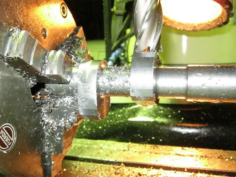

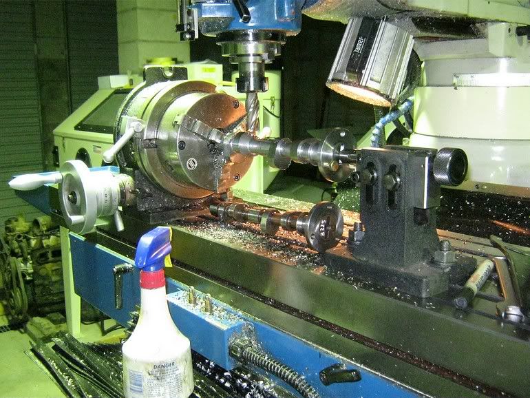

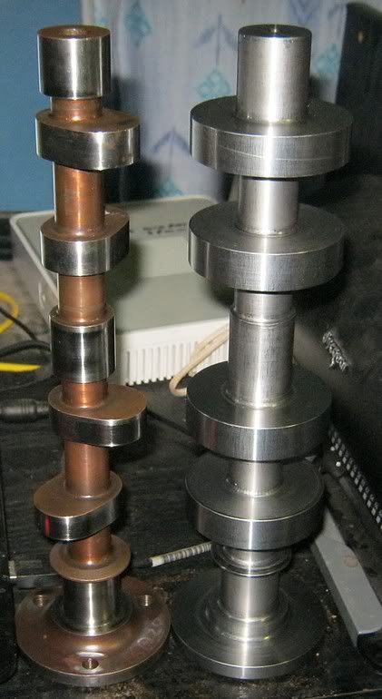

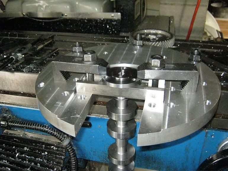

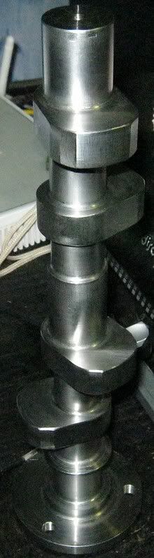

http://i113.photobucket.com/albums/n216/dangerous_05/IMG_2533.jpg
http://i113.photobucket.com/albums/n216/dangerous_05/IMG_2534.jpg
http://i113.photobucket.com/albums/n216/dangerous_05/IMG_2538.jpg
http://i113.photobucket.com/albums/n216/dangerous_05/IMG_2539.jpg
http://i113.photobucket.com/albums/n216/dangerous_05/IMG_2540.jpg

Wow... just... wow...

Wow... love your work man!!
How much thicker were you able to make the shaft?

How long..... did that take man??? That was a massive lump of metal to machine!!!!
Memberdangerous
Posts: 5901
Registered: January 6th, 2005
Mood: 591
posted on July 1st, 2011 at 06:40 PM
9 hours!

So dumb question time from me again DB... what's the finishing process from here on the cam... presumably polishing and/or hardening ???
And how do you avoid the incompatibility with followers problem that keep hearing about, or is that not such an issue with roller cams ???
My toys
Memberdangerous
Posts: 5901
Mood: 591
posted on July 2nd, 2011 at 07:39 AM
Hi Dave,
the next step will be for the lobes and journals to be pre-ground
to the desired shapes and sizes.
Crankshaft Engineering will do the journals on their crank grinder,
and Surecam will do the lobes to my desired specs.
It will then go off to be case hardened.
In the past I have asked for .060" deep case, but I may ask Surecam to give his recommendation.
After this it will go back to get the lobes and journals finished.
I made a flat tappet cam the same way some years ago,(currently in "Cranky2"),
and it was compatable with any of the induction hardened iron VW lifters(I used Mahle black ones).
In this case it will be able to be run on my current roller lifters no problem.

Still waiting on my new cam, so fitted one that Don pauter did especially for me.
New MSD and injection made for a much nicer curve and a little more power.
Remembering that it ran 10.93@122 with 220hp and 1785 lbs of weight,
this should be worth a couple of mph and tenths too i hope.
The red humpy curve was last time, with small cam, 265*.
You can see how it has picked up from the 6500rpm and up (right where I use it).
http://i113.photobucket.com/albums/n216/dangerous_05/ScanDyno15thSept2011.jpg
http://i113.photobucket.com/albums/n216/dangerous_05/IMG_3040.jpg
http://i113.photobucket.com/albums/n216/dangerous_05/IMG_3037.jpg
http://i113.photobucket.com/albums/n216/dangerous_05/IMG_3039.jpg

thats awesome dave power curve looks great

Nice one!!
That power curve will translate into times no doubt :tu:
