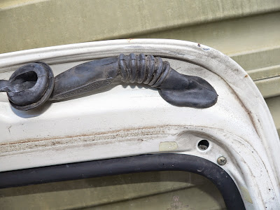

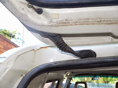

Thanks for the tip on these Nils, I must confess I had a look at these when I was stripping a subaru wagon a while back and discounted them because I thought they woundn't work. Need to look a bit harder next time.
https://lh3.googleusercontent.com/-8nZELE5FLAc/U_WlBA5lEEI/AAAAAAAAAS8/Os7avaGt7vs/s400/LH%2520Tailgate.JPGhttps://lh4.googleusercontent.com/--4oJePEoZ4Y/U_WlCgnMjkI/AAAAAAAAATE/b2MOj_hy3Ro/s400/RH%2520Body.JPG
https://lh5.googleusercontent.com/-dBkxHo50UdE/U_WlCbQCv6I/AAAAAAAAATA/07pB3H4e5ws/s400/Lefthand.JPGhttps://lh4.googleusercontent.com/-JwE2oeT62GU/U_WlDxZDrkI/AAAAAAAAATM/pBSZ8bduPXY/s400/Righthand.JPG
