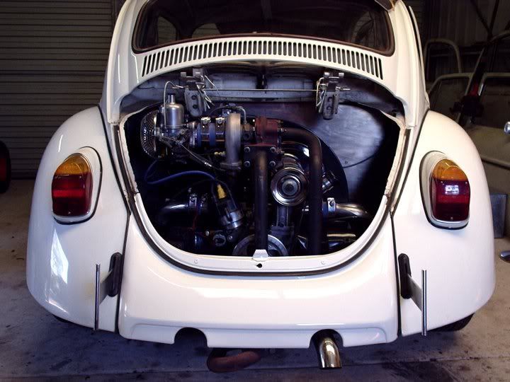

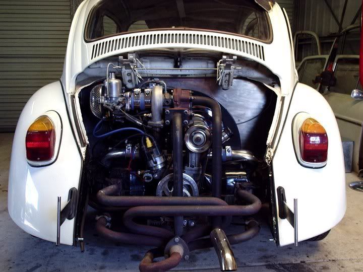

posted on June 1st, 2007 at 12:01 PM
Finished the rear apron
now you see it
http://i76.photobucket.com/albums/j37/stanley111/rearapron1.jpg
Now you don't
http://i76.photobucket.com/albums/j37/stanley111/rearapron2.jpg
will make it so much easier to remove engine with turbo intact

Originally posted by Stanley
The dump pipe is that size only because I had an old exhaust system and I used the bends to make it (TAT remember). It' 1 5/8. When I fit the new system I may go a bit bigger. There are some different schools of thought as to big or small.
Thats very fair to say on the frontend of the turbocharger but on the back end you want it as free flowing as you can get.
2.5" minimum and separate the wastegate outlet as far as you can go if you can.
Theres a surprising amount of HP to be gained and spool time to be lost with a decent dump setup.
L8tr
E
Im not a complete idiot, quite a few parts are missing....
MemberStanley
Posts: 4523
Threads: 270
Registered: March 13th, 2003
posted on June 3rd, 2007 at 06:37 AM
I'm hoping to have a new exhaust system made in the next few weeks. Something like the attached photo. Won't be equal length but the merge/collector will be at the turbo flange.
Just trying to work out whether to have it made or to buy some mandrel bends and have a crack myself. I will need to have the actual collector made so it might be easier to get the local shop to do the whole lot.
Once this is done then I will make a dump that is more efficient than the one I have.
Unfortunately the bug has bitten hard and it's gone from a street car that will be sometimes used on the track to a track car that will sometimes be driven on the street....:starhit:
It must all fit under the deck lid though as I need to be able to drive it to the track.
