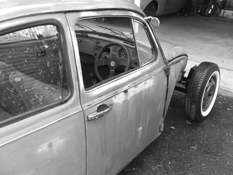

I think before you have a drive I'd like to connect the steering and put the fuel tank back in : ) I've already hooked the front brakes back up but just need to bleed them.
I modified a VN commodore steering shaft so I can use it as the joiner in the steering column. Obviously with the front now 10 inches further forward I need to lengthen the column the same amount.

I used a bit of 8mm steel to make the new ends for the steering shaft. I drilled a hole that the commodore shaft would fit into. I slid the shaft half way into the new piece and then tacked the outside of it together to check alignment. Once it was OK I then plug welded the new piece to the end of the steering shaft.

To make sure it wasn't going anywhere I also welded around the shaft on the other side too. If your welder isn't ballsy enough, don't do this. You'll need to also have a keyway or some other form of holding the two pieces in line. I relied solely on the power of my welder. Yay 240 amp unimig. It makes it possible for retards like me to build stuff : )
Next step is to cut the shaft down to the correct length and fit it, see if the fuel tank will still fit in the original spot, fit all the lights, trim the front seats, etc etc. I'm still waiting for my hubcaps to arrive as well. It's been a month!!!! I want them NOW. Me? Impatient? : )

Today I got the steering working again. Because steering knuckles aren't supposed to be bent/angled more than 30 degrees I cut the steering column back around 120mm so the knuckles were at a more relaxed angle. I also made a new piece to go in the end of the column shroud to stop the steering shaft flopping around. It actually feels really good now.

After seeing what had to be done to the fuel tank mount to clear the steering I gave the tank a bit of a clean and a paint.

I had to raise the front of the fuel tank 35mm to clear the new steering set up.

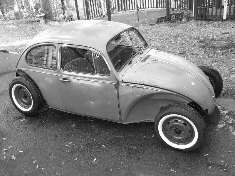

I took a pic of the rear suspension before I cleaned and painted it but was too stupid to remember to take a pic of it afterwards. I could take the wheel back off, but, nah....too lazy for that : )

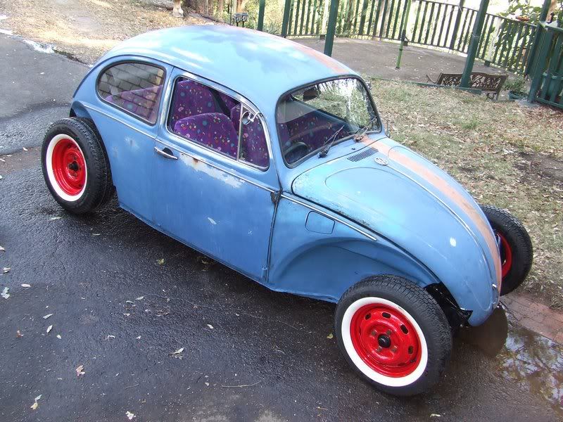

Just thought I'd bore you all with another pic of Sid. At least the rear suspension looks better now. If only you could see it....

I just like this pic because the tyre to guard clearance is sooo good. : )

saw Sid the punky bastard in the flesh today - he sure is hot !

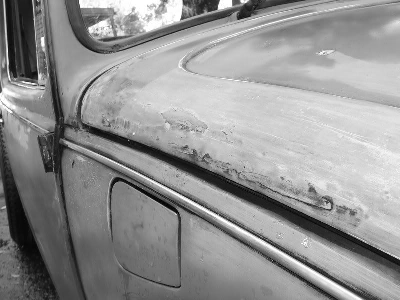

I finally painted the bodgy stripe on the decklid today.

How's this for a show car : ) Nice glossy scratch free paint. Gotta love the attitude on the back wheels. Plus I have to admit I do like how my half assed W inspired decklid turned out.

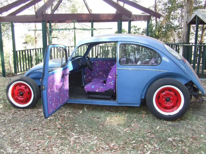

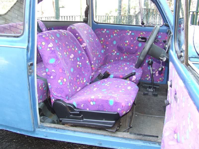

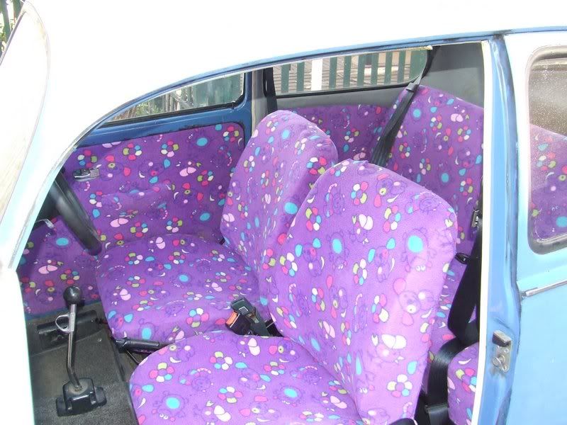

Well, I finally got the front seats done so I'll stick a few pics here to bore you all some more. I'll throw in some b&w shots too, just because I want to. So there : ) I'm going to try using photobucket this time so I hope I don't stuff it up. Remember, me not smart.....

No worries mate, just mucking around. Never can have to many options. The problem is deciding on one lol
Sid's looking great. Dig the interior. What have you got in mind for carpet?

looking good in a kinda "up yours" sorta way, if your looking for a matching exhaust I've got a pair of those mufflers in the second pic that the colonel posted (CVD-3709S) no pipe work tho, just the muffler bits, chrome, if interested let me know, they arn't free but going at a reasonable price, they were too big for what I wanted so I cut them off the chrome pipework and welded a cupla hot dogs on. Mind you I am at the other end of the earth from you.

Laziness was going to have me just leave the grey carpet that's in there, but I like the idea of astro turf : ) Freakin' hilarious....purple and green....mmmmmm tasty combination. Perfect : )
