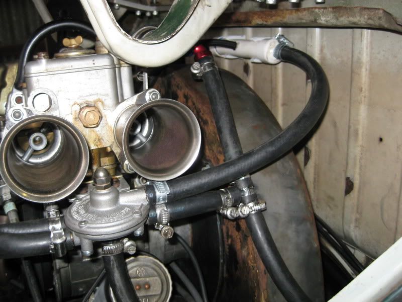

Upon Nick's help with this, I am refitting the Malpassi that I had fitted way back at the start of this project, and thrown out the Holley FPR's.... Stupid farka I am.... I should have listened to Nick's advise from the start!!!!
But anyway... How Nick has suggested I fit the Malpassi is a very curious one for me, but I have been informed by my brother (who is also a very clever dude), that the method Nick has suggested is also how Subaru do it.... But I digress...
The questions I ask those that a cleverer than I, are as follows...

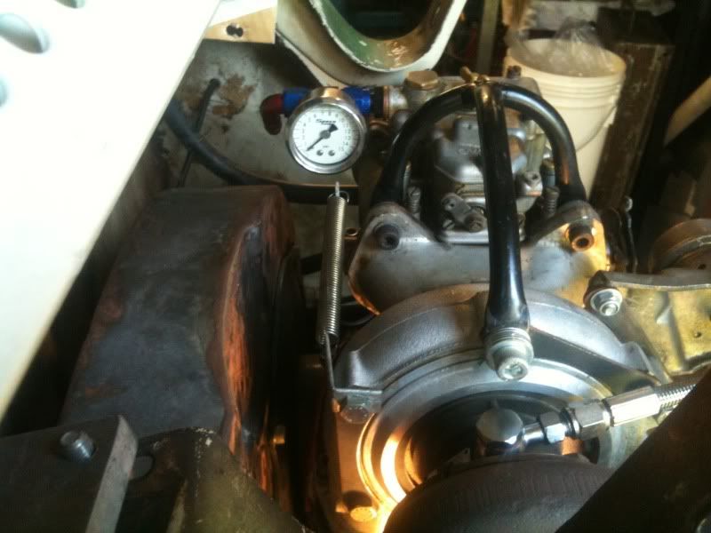

In the image below, you can see that I have relocated the FP gauge to the fuel inlet point on the DCOE.... Anyone have any issues with this location?
http://i27.photobucket.com/albums/c181/Humptydub/POS60T/FGauge.jpg
http://i27.photobucket.com/albums/c181/Humptydub/POS60T/Overall.jpg

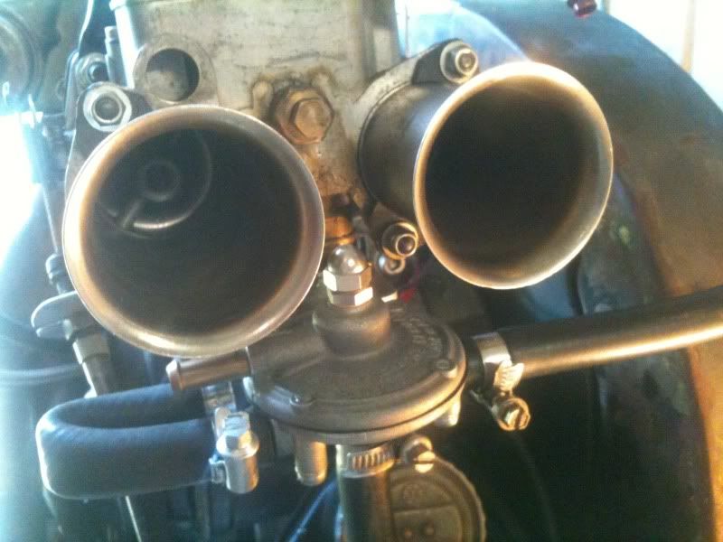

Next I give you the Malpassi FPR location....
http://i27.photobucket.com/albums/c181/Humptydub/POS60T/FPR.jpg
Likewise, can anyone see a problem with mounting it here?... Apart from the minor obstruction to the oil filler cap and breather point?
And before you ask.... Yes the FPR outlets are looped on purpose... I'm not going to use them on this set-up....

Having the gauge at the inlet IN the carb will give you a true pressure at the inlet when the fuel is flowing. Mine is at the pump and won't give an accurate reading due to pressure drop when the fuel flows.

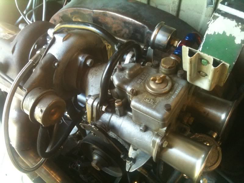

Latest update....
The story so far....
As you guys know, I've been having some issues with fuel pressure... It seems that since I changed the system to a 'dead head' setup instead of the previous 'return' setup, I have way too much fuel pressure and the Holley FPR's that I have tried (and was told would do the job), have not coped.... So after consulting may turbo VW peeps around the globe, I have come to the conclusion that nobody has any clue about turbo fuel systems, and the fool proof setting up of them.... What works for one dude, may not work for another.... I have proved this, as I have attempted 4 different set-ups and none have done the job yet.... But its funny how the world turns...
After chatting to Nick about this problem, I have redone the system again and gone back to the original set-up I had fitted way back at the start.... But with a curious twist.... As some of you may remember, the carb and manifold I have on my car actually came from Nick... I think it was used on his one of his street cars from earlier this century.... So he should know what system worked best for this carb.... And here it is....
http://i27.photobucket.com/albums/c181/Humptydub/POS60T/IMG_1079.jpg
If you look directly below the carb velocity stacks you will see the Malpassi rising rate fuel pressure regulator (FPR)... You may notice that the outlets on the carb are "capped".... Weird huh?.... I thought so too... So here's an explanation on how this system works.... The fuel from the pump goes directly to the carb.... No regulation (at least in the conventional sense).... Spliced into the line to the carb, the fuel is t'ed off to the FPR fuel inlet.... From the FPR the fuel is then returned to the tank... The flow of which is controlled by the boost reference port at the top of the FPR.... Fuel pressure will be set quite low at idle.... Like 2psi low.... As boost rises, the FPR pressure also rises, which restricts the flow of fuel back to the tank, in turn the fuel volume and pressure increases the flow to the carb....
I will get an accurate pressure measurement from the FP gauge I have fitted to the carb fuel intake...
To make all this happen I needed to create constant source for the FPR, iginition MAP and the boost gauge to get their respective vacuum/boost signals from.... The method I had before was getting messy with too many vacuum lines t'ing off the main line..... So I made a vacuum chamber with it's feed from a port on the intake manifold.... The FPR, the ignition and the boost gauge all get their signals from there.
http://i27.photobucket.com/albums/c181/Humptydub/POS60T/IMG_1078.jpg
http://i27.photobucket.com/albums/c181/Humptydub/POS60T/IMG_1082.jpg

Originally posted by SuperOwen
I can't see why you need a rising rate setup in a draw through config. Just keep it simple, bypass regulator set at a constant pressure and let the carb work as intended.
Been there, tried that, didn't work.... I think the reason it didn't work for me is more down to the pump I have.... Its a Holley Blue... Way too powerful for a conventional draw-through set-up... No regulator on the planet (as far as I could find/afford anyway) could get the pressure low enough for the weber...
Gonna stick one of my Holley FPR's inline before the Malpassi in an attempt to drop the pressure a little... Hopefully I can then get the Malpassi to regulate down the 1psi at idle, and boost reference to the level the Holley FPR is set too...

hey simon,
what size fuel lines do you have? up and back?

Originally posted by Boostn
hey simon,
12mm ID from the tank to the filter (12mmID tank fitting) then to the pump, 10mmID line to 3/8 hardline to the rear, 10mmID to the FPR/Carb (as per the previous pics), via 3/8 'T' return, to 10mmID hardline back to the top of the tank...
So basically 10mmID for the most part in both directions....

MMMM,
I always ran 1/2'' copper.
It could be the reason you can't get the pressure down?

does the mallpassie change the fuel pressure when you adjust the screw?
