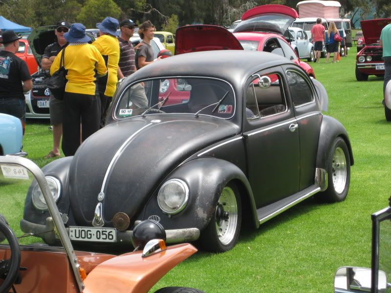

Always good to have a chat Reub.... Sometimes a little banter and a debrief can work wonders.... And a laugh about stupid shit can really set you in a good mood.... I had a couple of beers with my bro and my neighbor after talking to you.... I now have renewed enthusiasm for the car... Can't get 1/2" bundy tube, so have decided to go with copper.... Possibly a little heavier, but I can source it tomorrow and get it done.... Might even make the track on Wednesday night!
A good mate owns this car.....
http://i27.photobucket.com/albums/c181/Humptydub/DoVW-10/IMG_1168.jpg
And we've been itching for a little grudge action.... :smilegrin:
