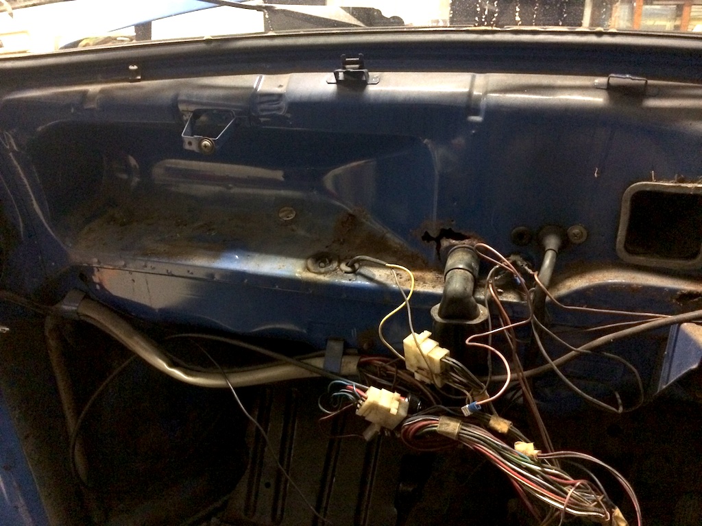

Dash off
Finally found some rust, in the obligatory behind-dash position. Although from pictures I've seen online I'm getting off pretty lightly.
Next steps: remove fresh air box, remove fuel tank, acquire welder, re-teach self to weld.
I did say this was a project.
Home welding suggestions? Cheap but straightforward please :)
http://www.reverb.com.au/images/beetle_dash_rust.jpg

I got rid of the vent in the front scuttle panel, water will never get in there again.
Hmmm, interesting approach. I think mine is unlikely to make it to daily driver status so water should be minimal.
Mind you until I fix all air leakage into cabin, new bonnet plus seals etc. I don't really need a fan.
posted on February 11th, 2014 at 08:48 AM
If you are talking about my convertible from the dash removal threads it was a pretty severe case from sitting unused in a backyard under trees for many years.
Normally if they rusted much worse than yours the whole car is a rust heap.
As Steve says just fill in the vents, I did the same.
posted on February 11th, 2014 at 02:44 PM
I agree - fill in the vents. Especially if daily driver. It isn't so much the water but the dust and leaves etc that fill up the air box and form a layer of silt that corrodes away
When you take the air box cover off you will see the drain point is not the lowest point.
I use to leave the air box cover off so as the fan just draws air in from the boot for the demister
