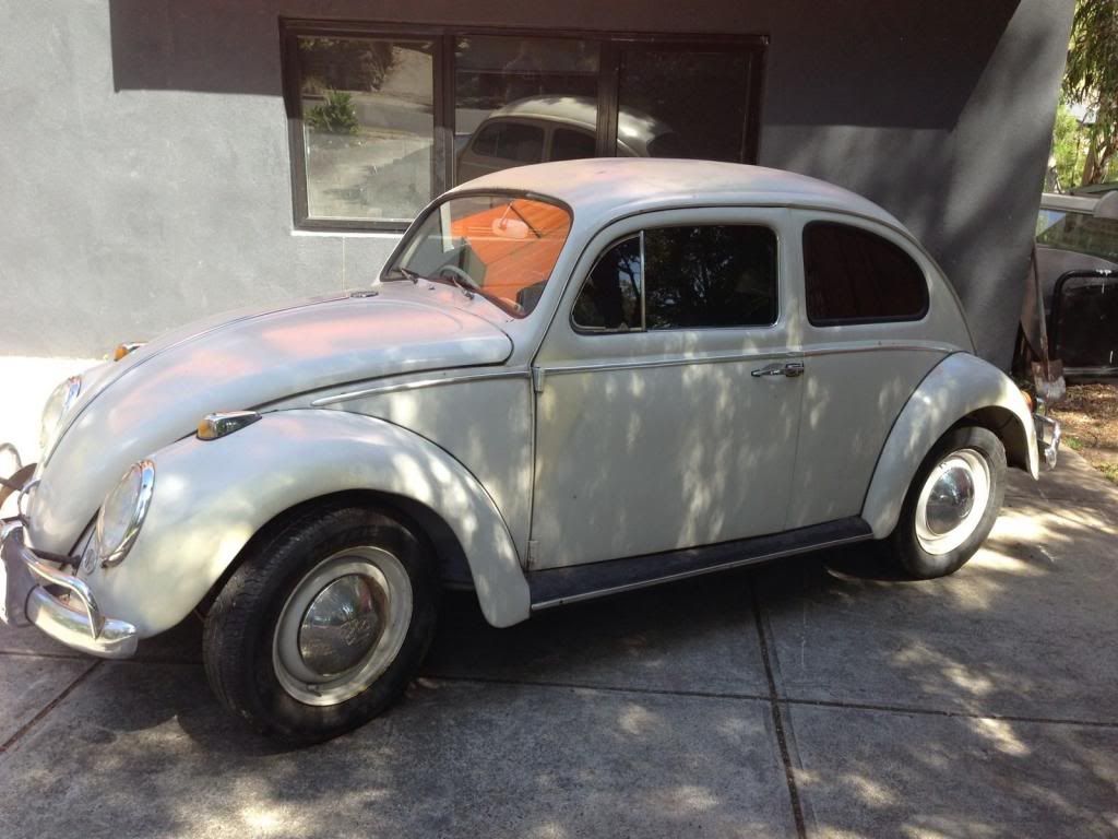

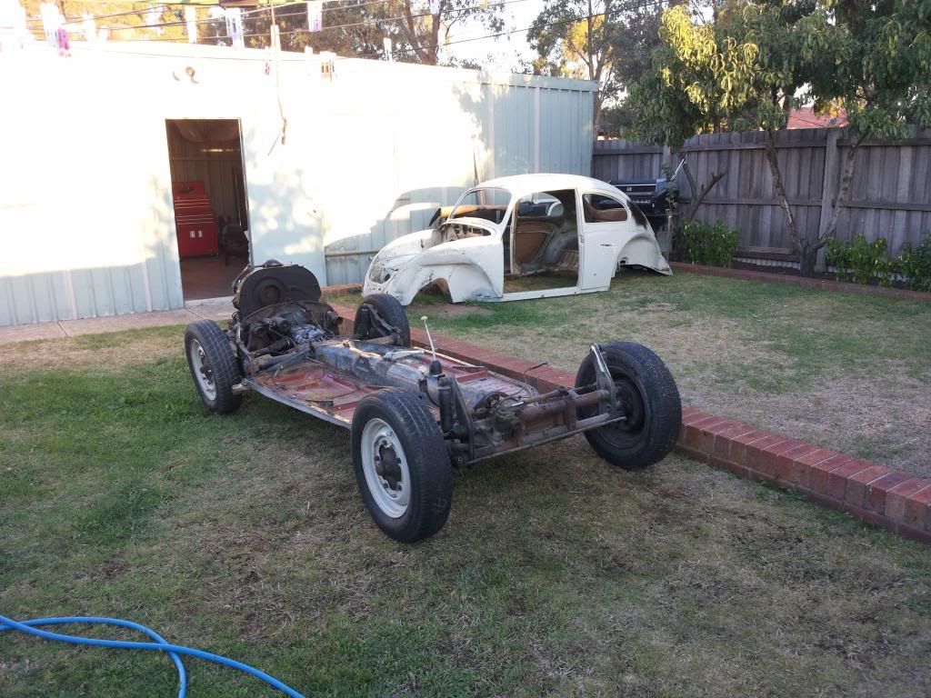

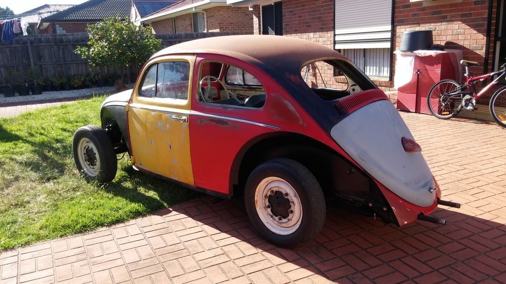

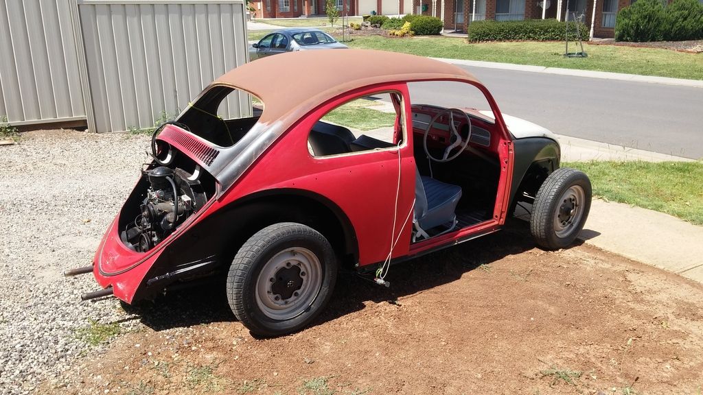

So I bought my first Beetle. It was an impulse buy off eBay, advertised as a '67 but later going off the chassis no. it was a '65. When I bought it I had no clue about anyting to do with VW's. Turns out I bought a lemon, pretty much some steel held together by bog, and a lot of it! But that just began the process of fixing it up to what I want it to be.
What I bought
What it turned out to be
Off it came

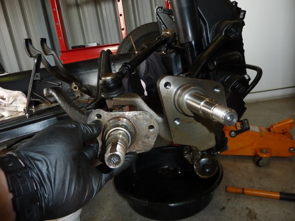

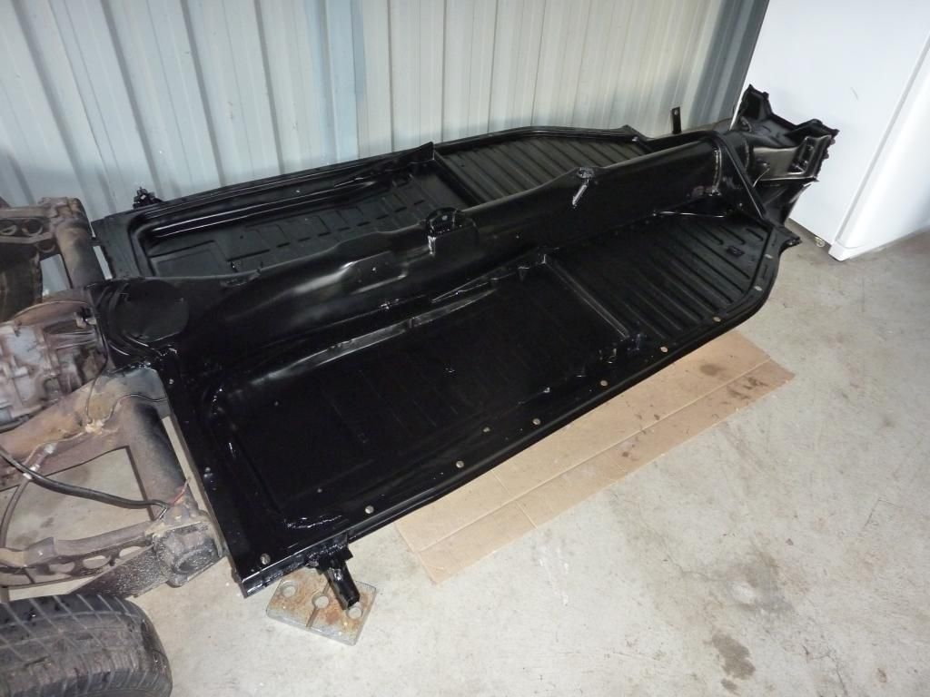

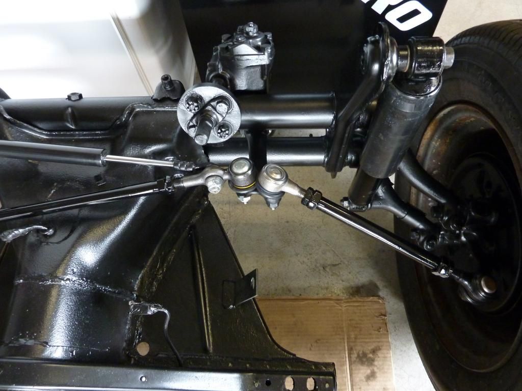

Got to work on the chassis
Drop spindles
Done with the chassis
Made this (I'm going for a rat look Beetle)

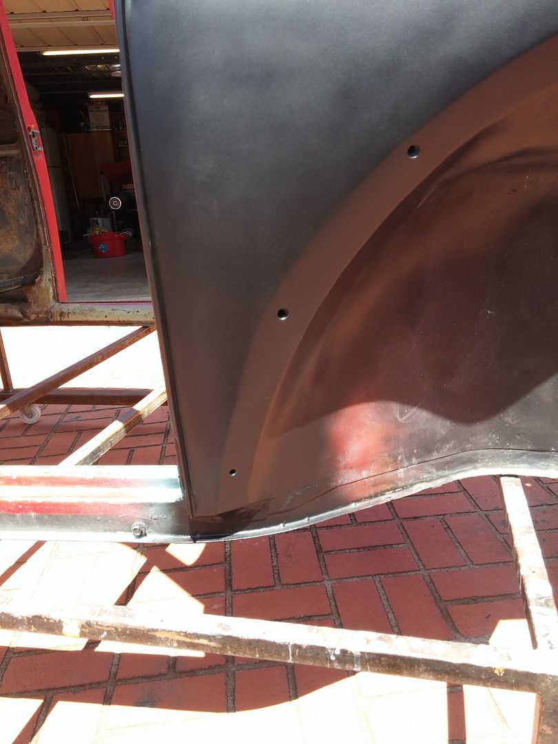

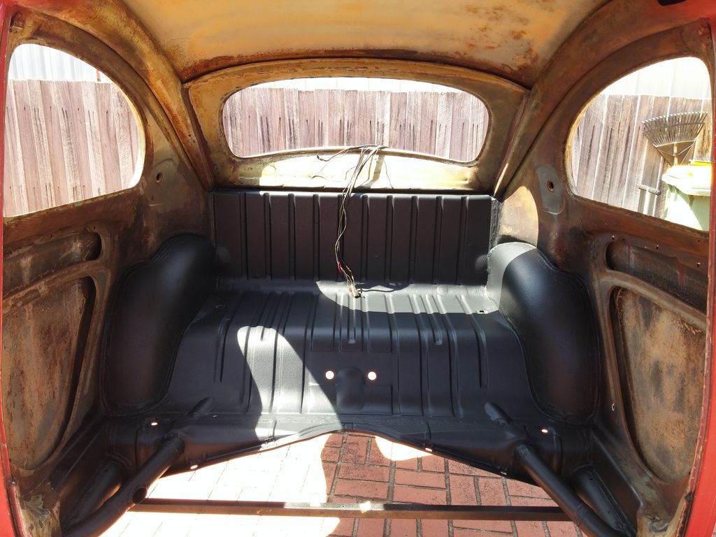

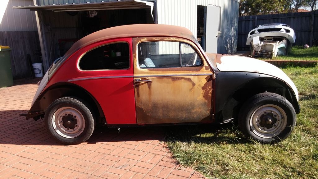

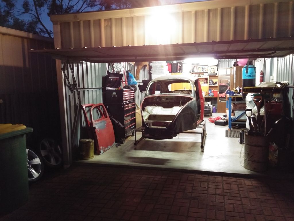

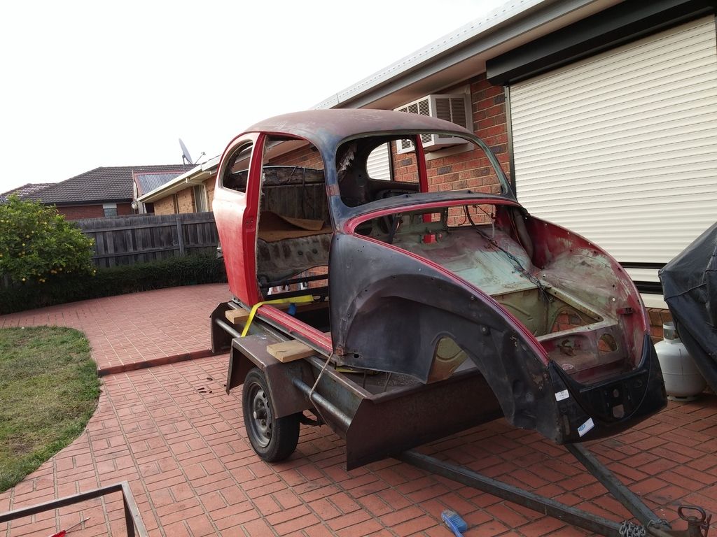

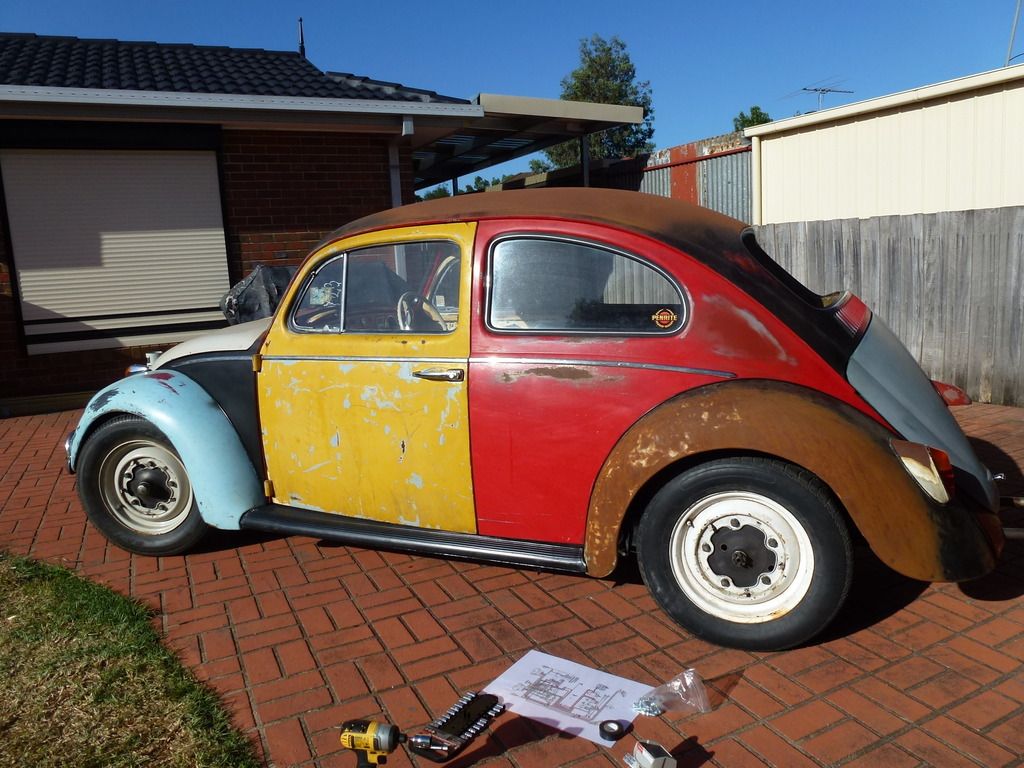

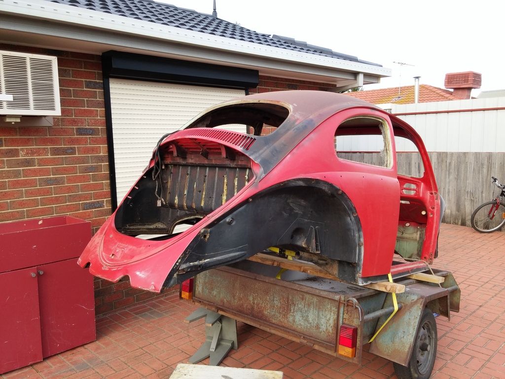

I ended up finding a new body, a '64 in not too bad of a shape. Just getting started on fixing the rust on it and hopefully get it all back together soon. I'm going for a rat look Beetle.

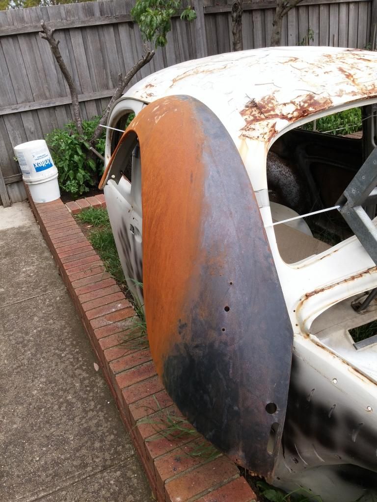

The fenders I will be using: I took bits to bare metal and rusted them with salt and vinegar (wasn't too tasty) and painted a few bits.

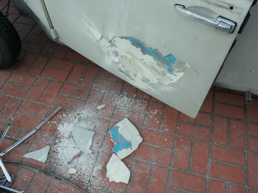

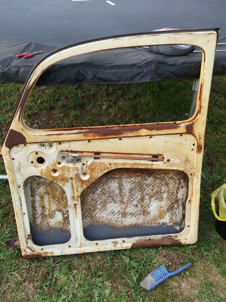

The drivers door I'll use. I picked it up for $10 pretty much to practice rust repair on the buttom but it turned out good so I rusted it up as well 😏
Got this for a steal as well, will go good with the rest of the car
Finally got the body home to start work on it
The stuff that needs repair
So far I have done:

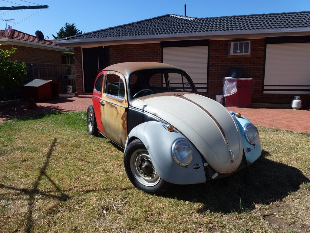

As it sits for now
Still have this to put into it 😂
It gets pricey

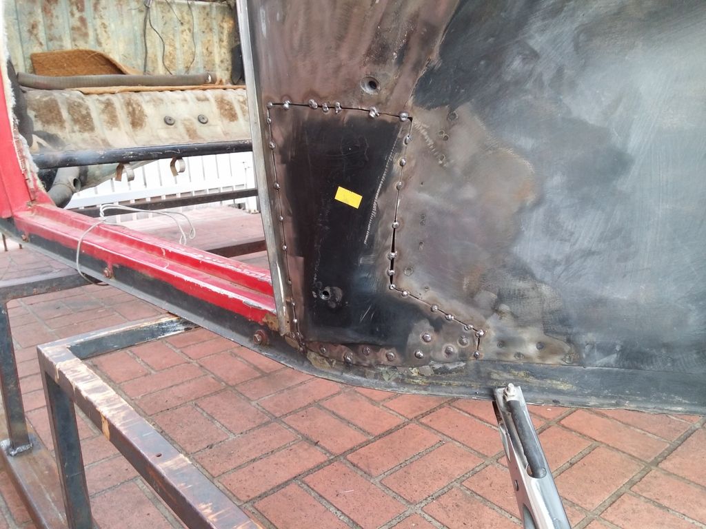

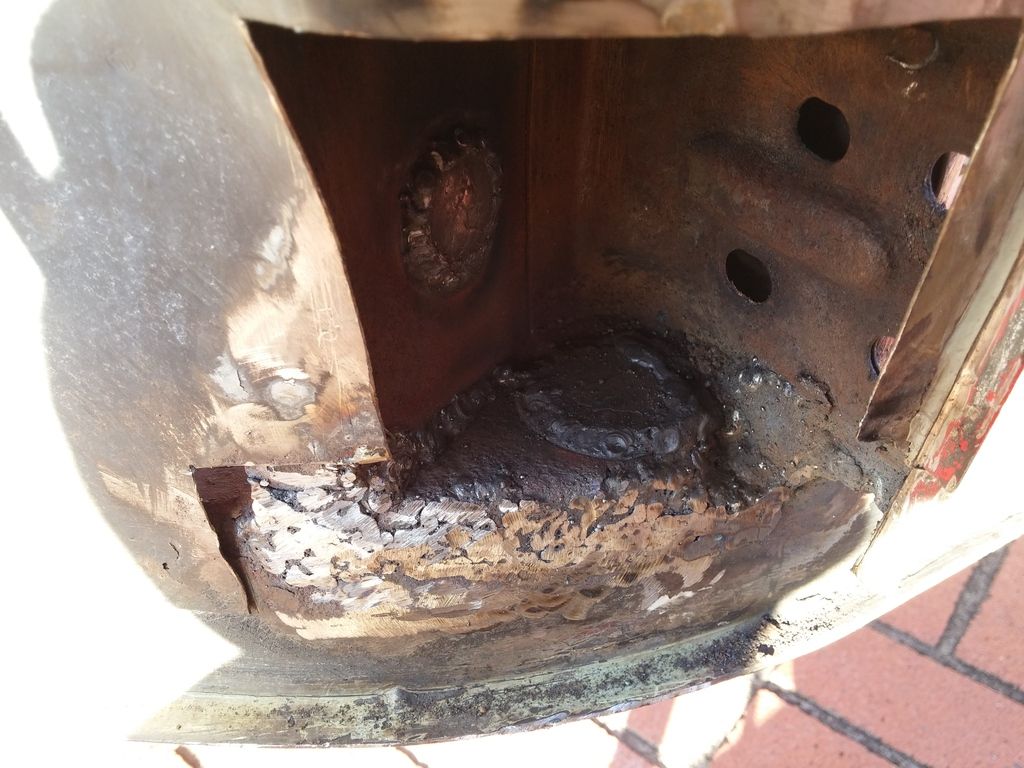

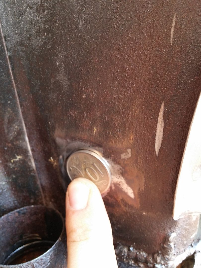

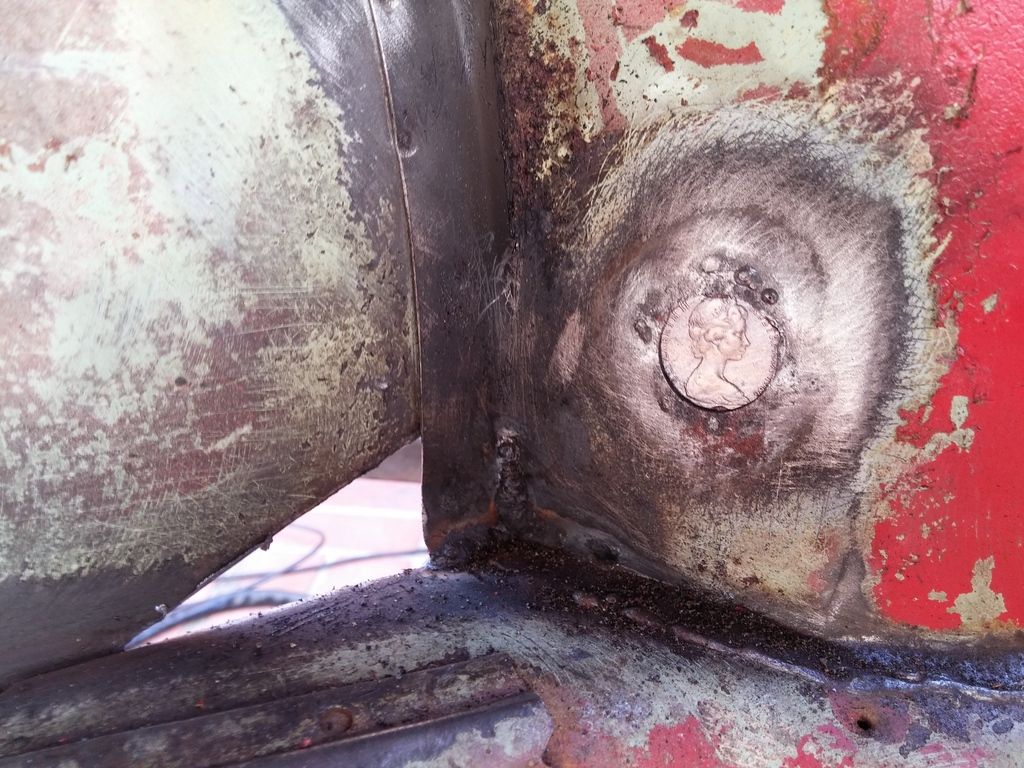

The coin didn't really like to be welded, the weld just kept on bubbling out but I just turned the heat up a little and welded all the way around it. It shouldn't be going anywhere, I just couldn't be bothered making a patch and by coincidence had 10 cents in my pocket 😂

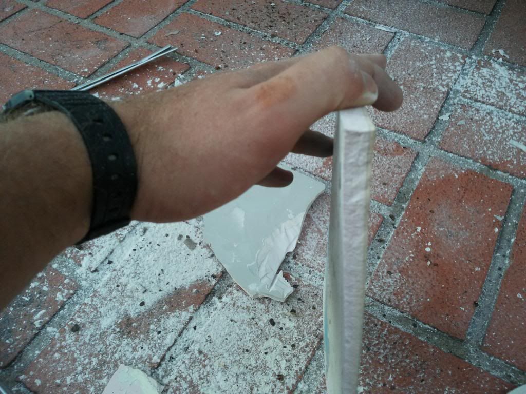

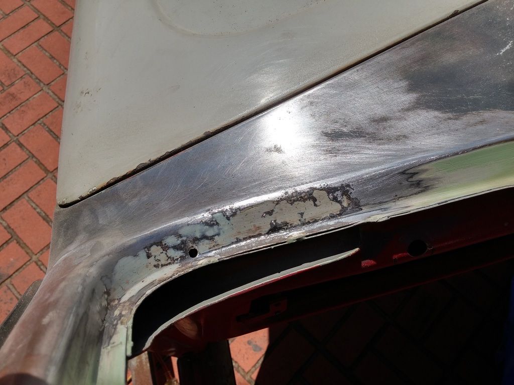

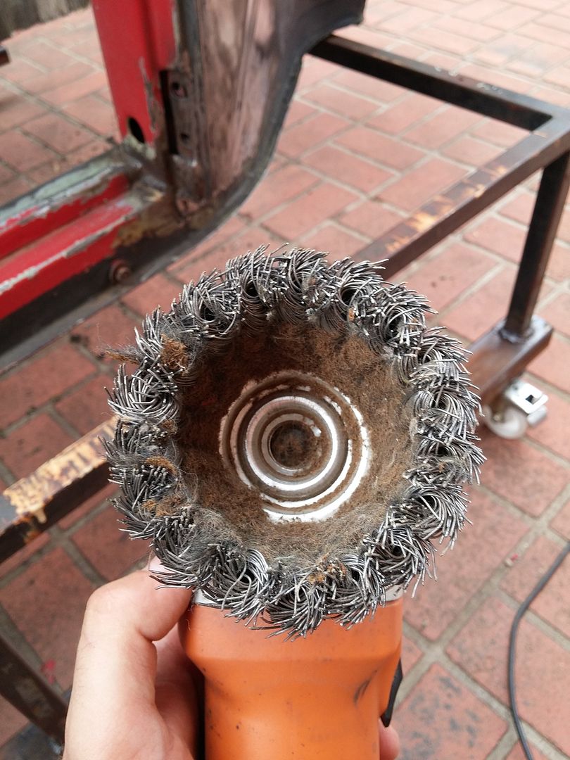

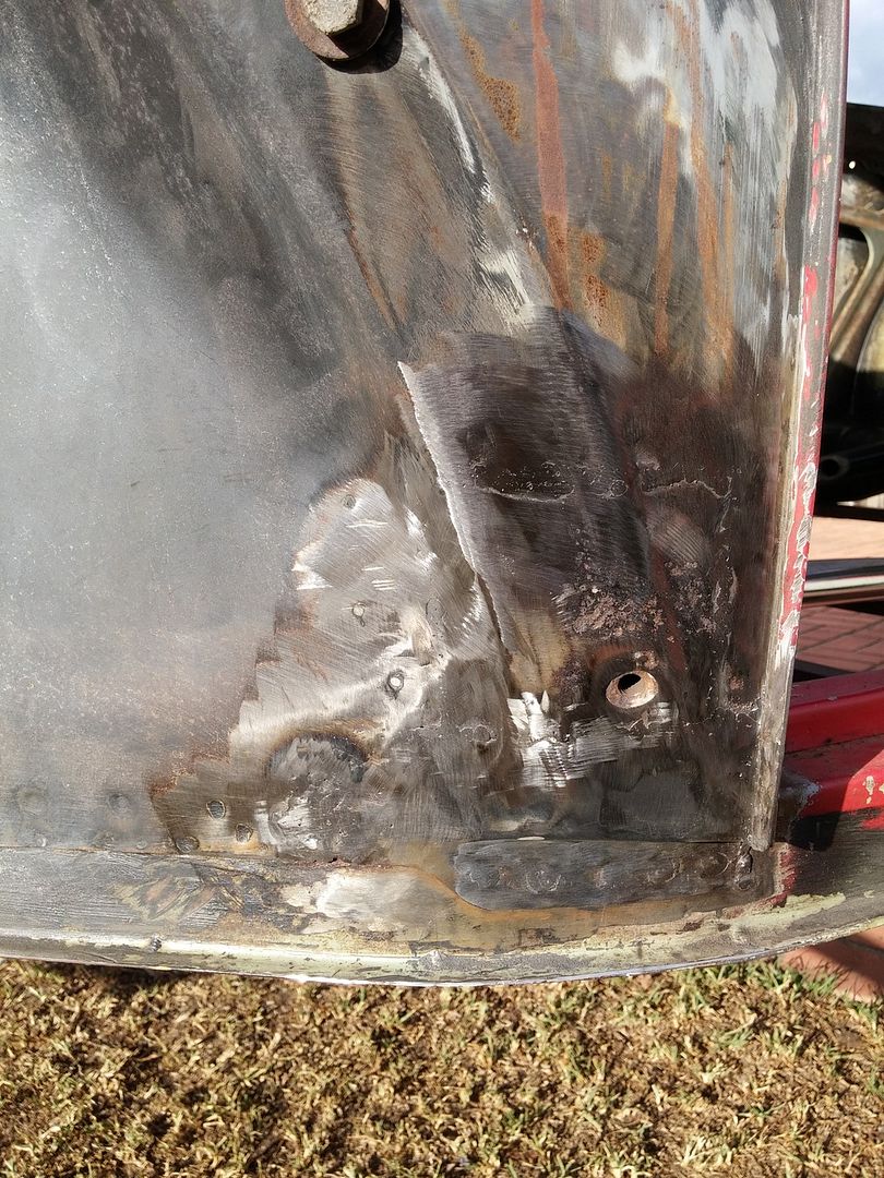

I smoothed out the welding today, didn't turn out too badly. A skim of filler and I don't think anyone would notice.
I bought one of these wire stripping wheels for the grinder today, they do an ok job at taking off paint but wow they are dangerous. The little wire bits like to fling off and go right in your skin, if you don't have safety glasses on it's a sure way to loose and eye!

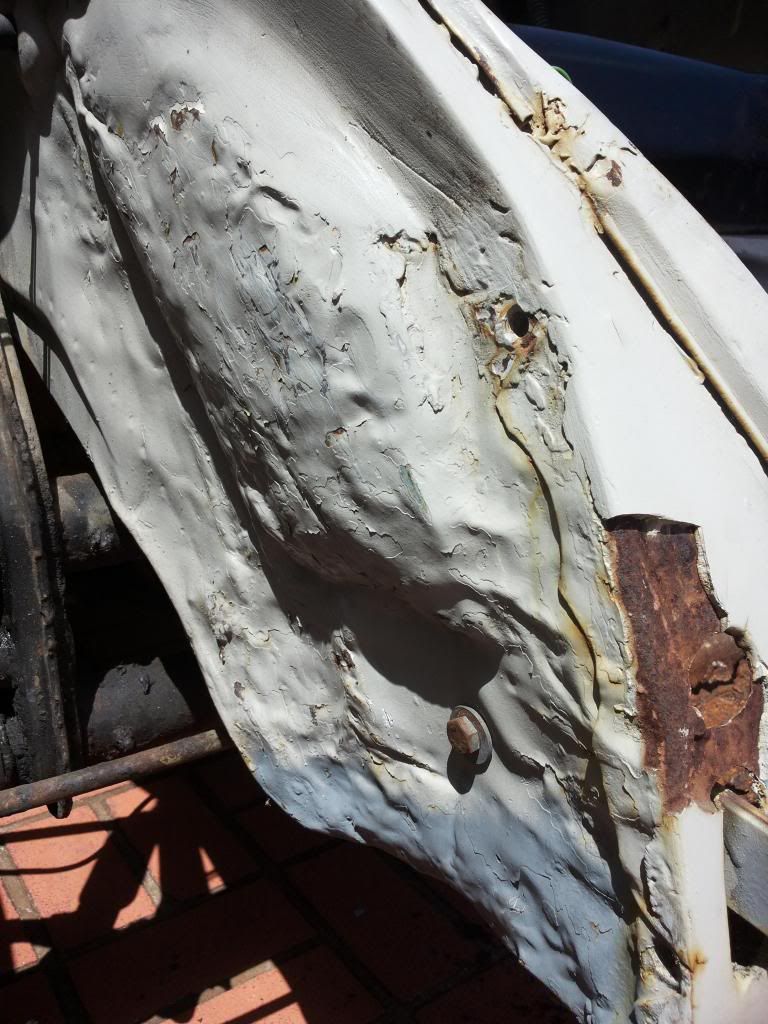

Wow, that amount of bog in that car!!

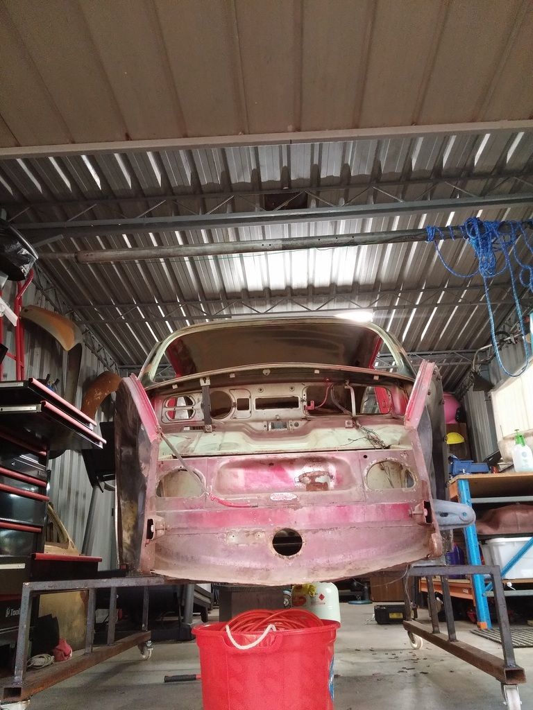

#1023340

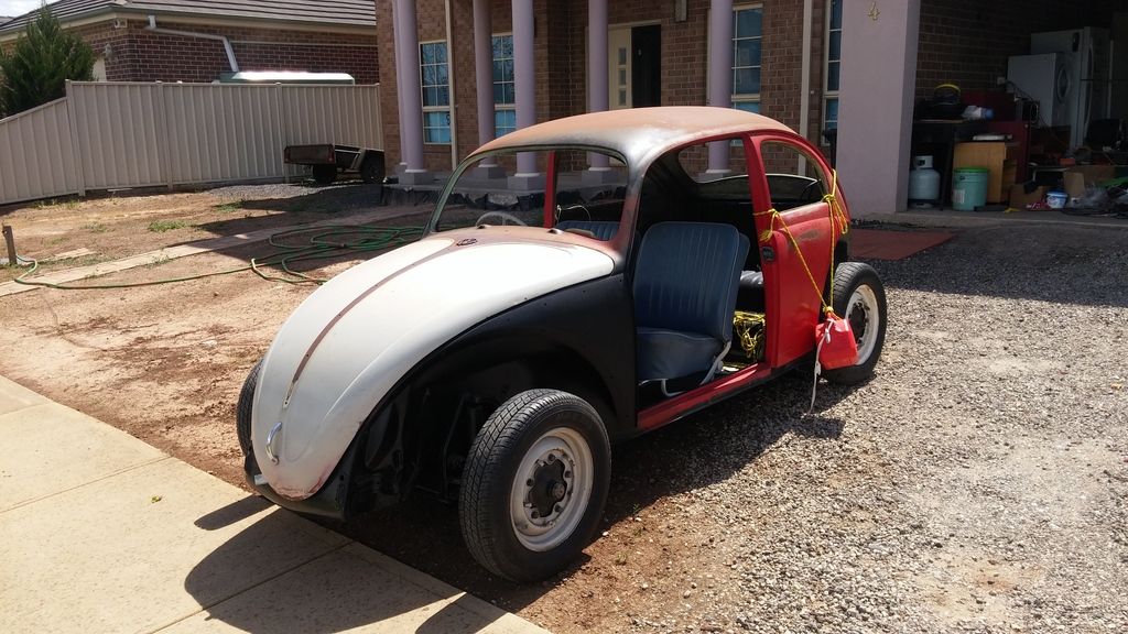

Progress

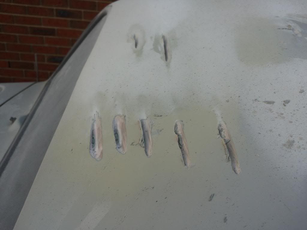

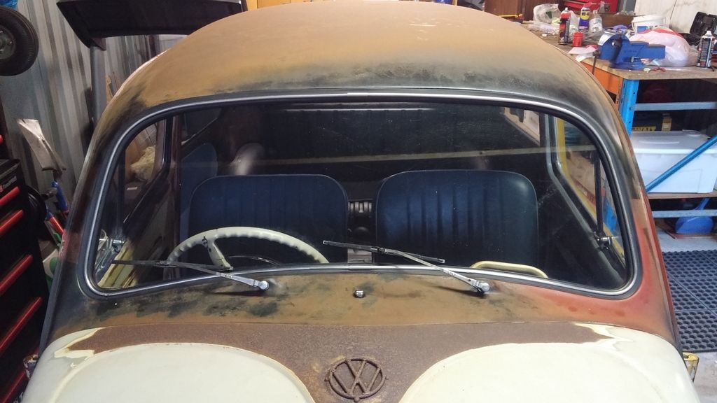

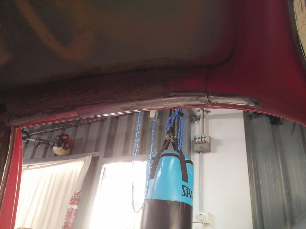

Started removing these teeth that hold the interior, I don't like them and I wont be installing a full interior
Really didn't want to mess with the shape of the windscreen area with making a patch so I just filled in the hole with epoxy putty

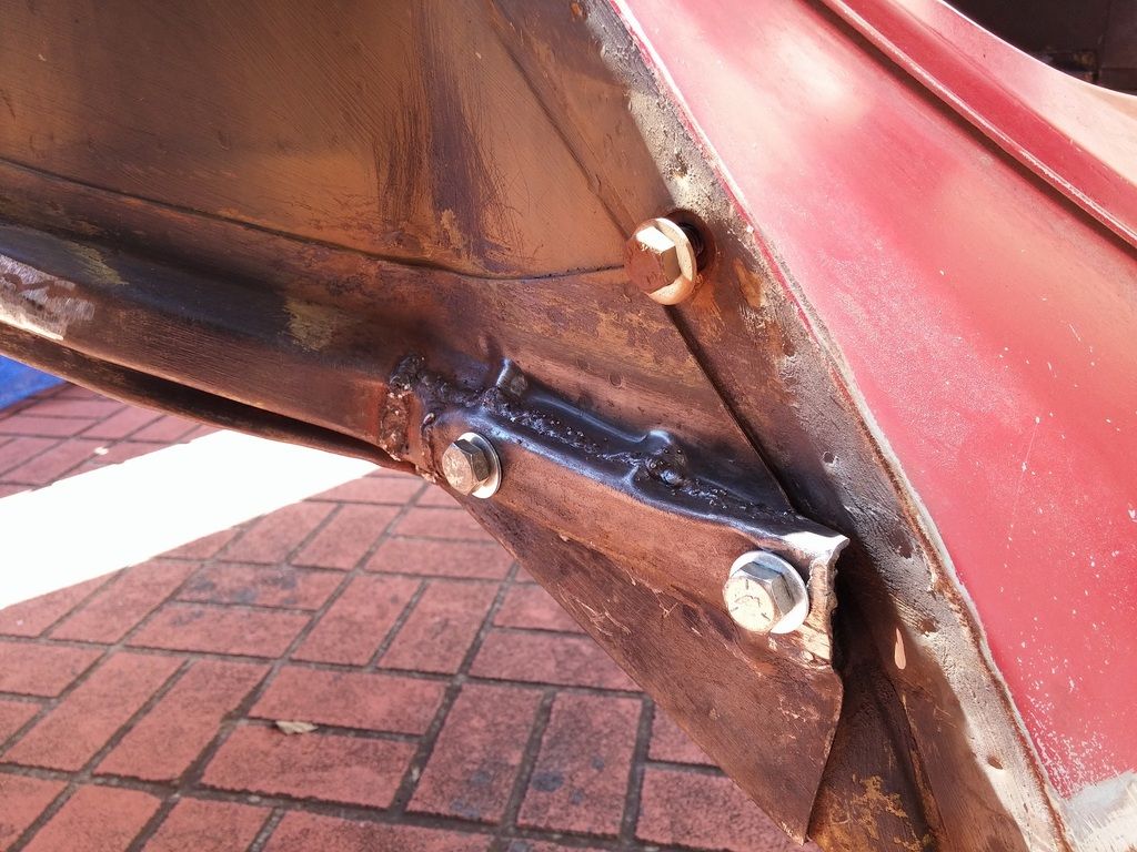

Fitted the front lid and to fix the front apron

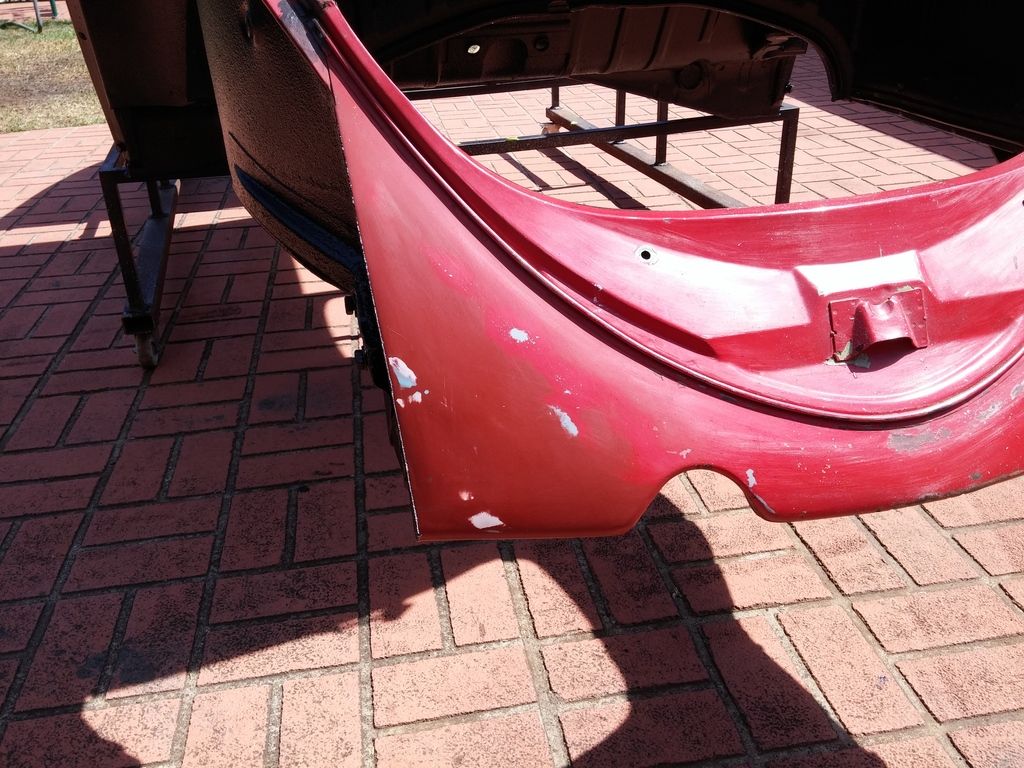

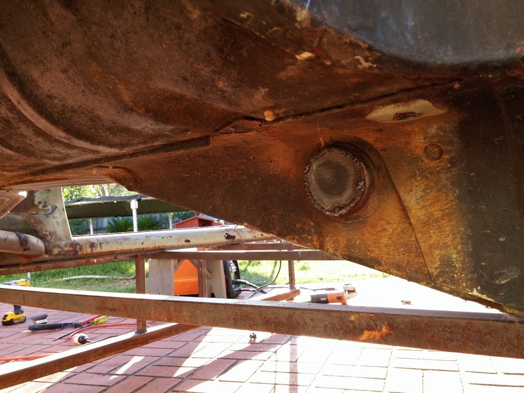

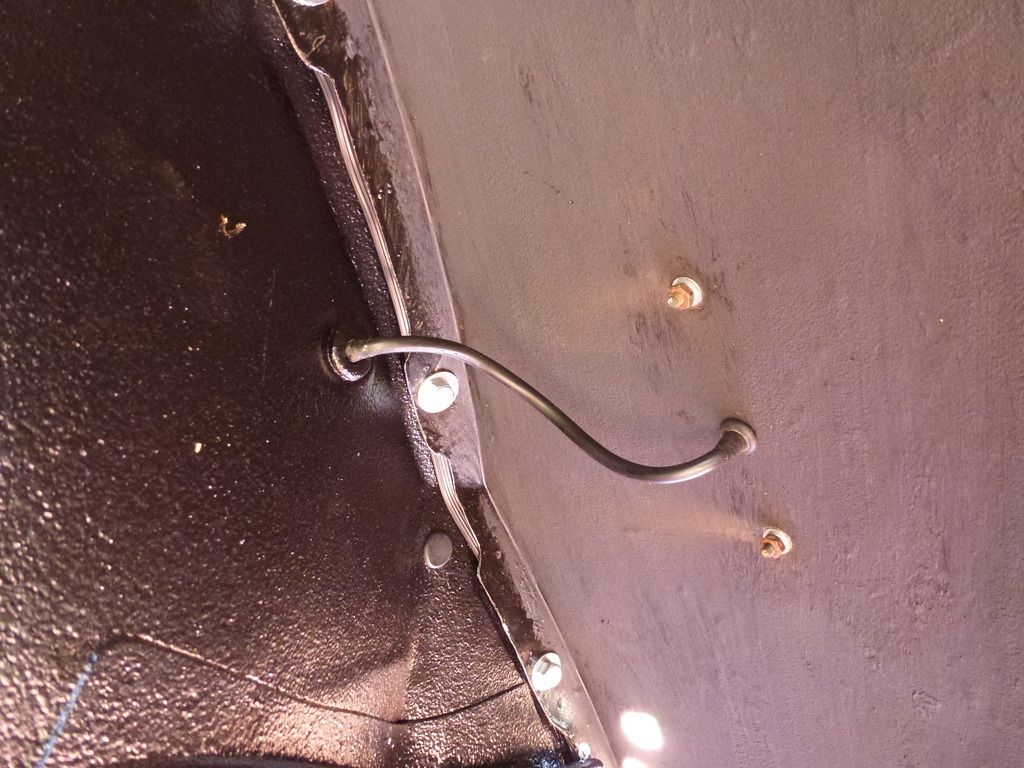

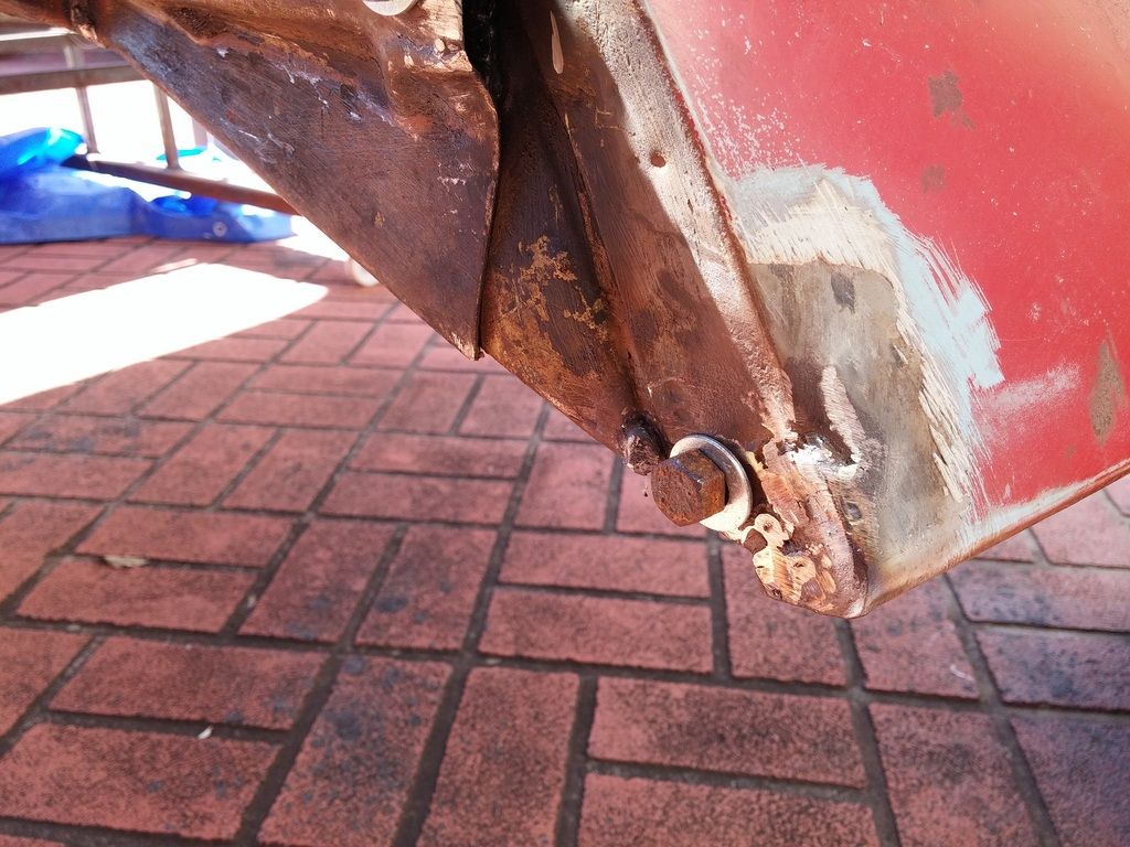

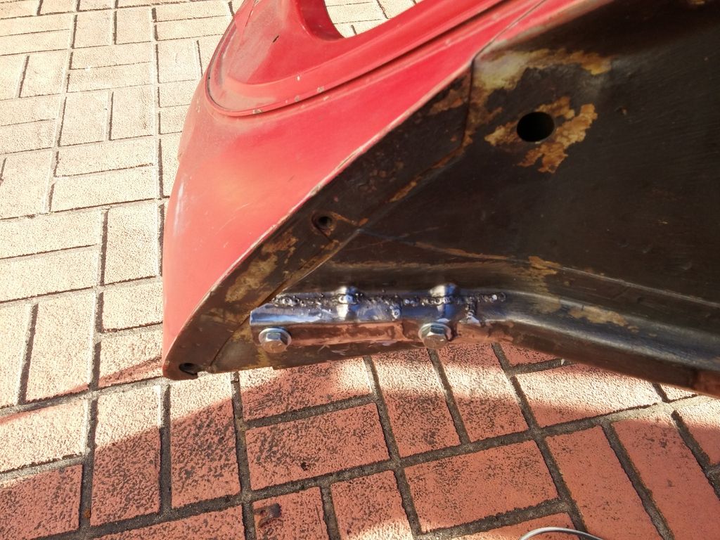

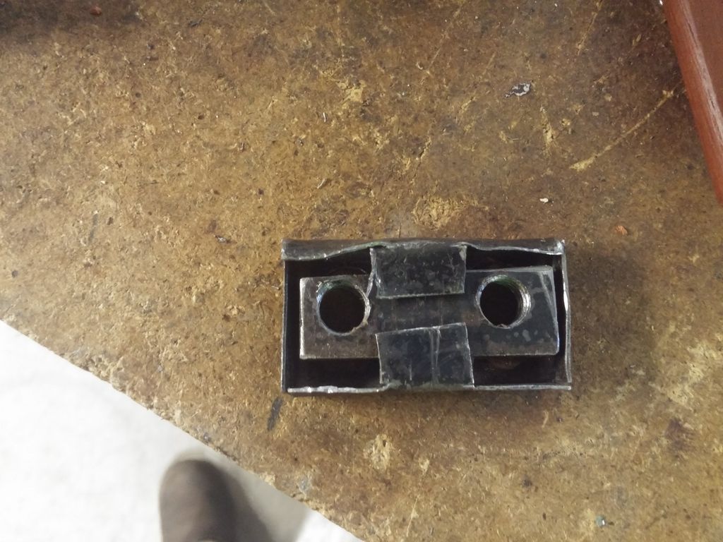

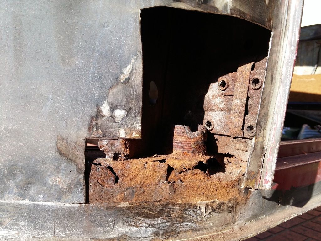

Fixed the rear bumper bracket as the nuts had rusted out, I just cut it at the top and down the side. Once it was cut I just pulled it down, welded some nuts on it and welded it back closed. Need to to the same on the other side as well
The rear apron had a split so I welded it up, ready for some filler.

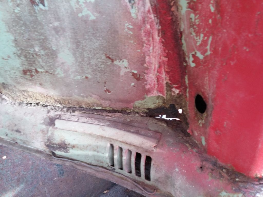

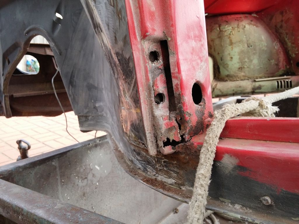

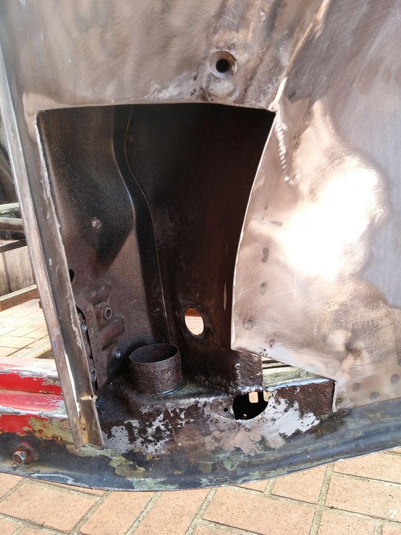

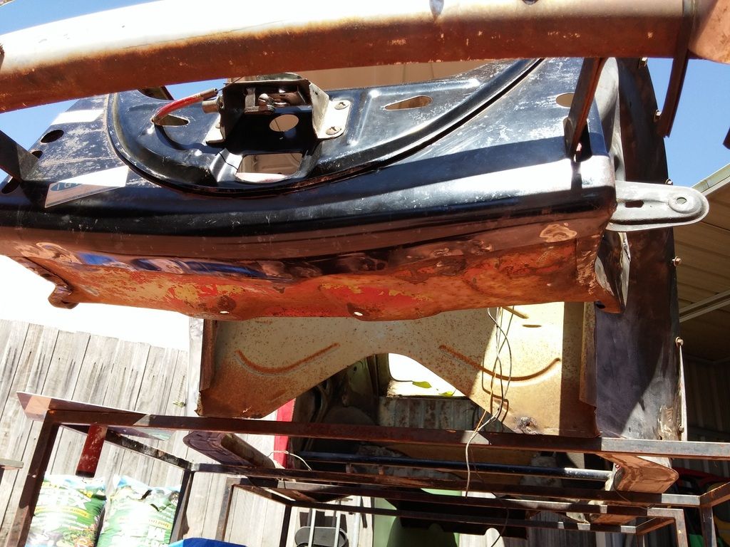

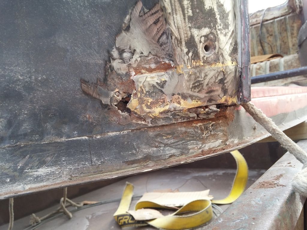

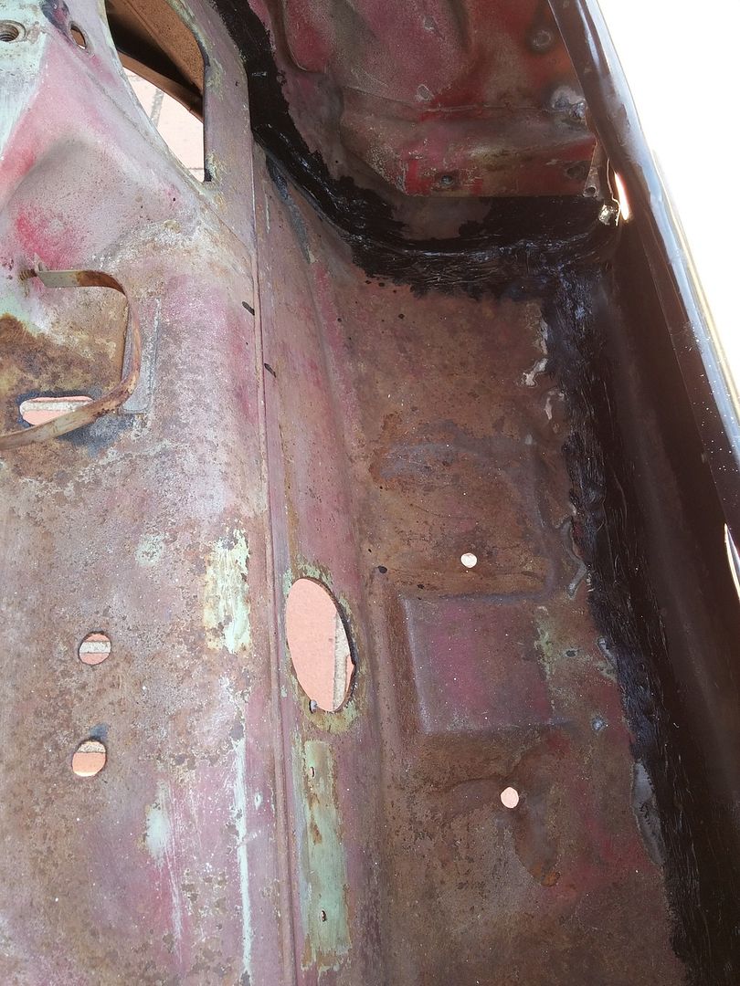

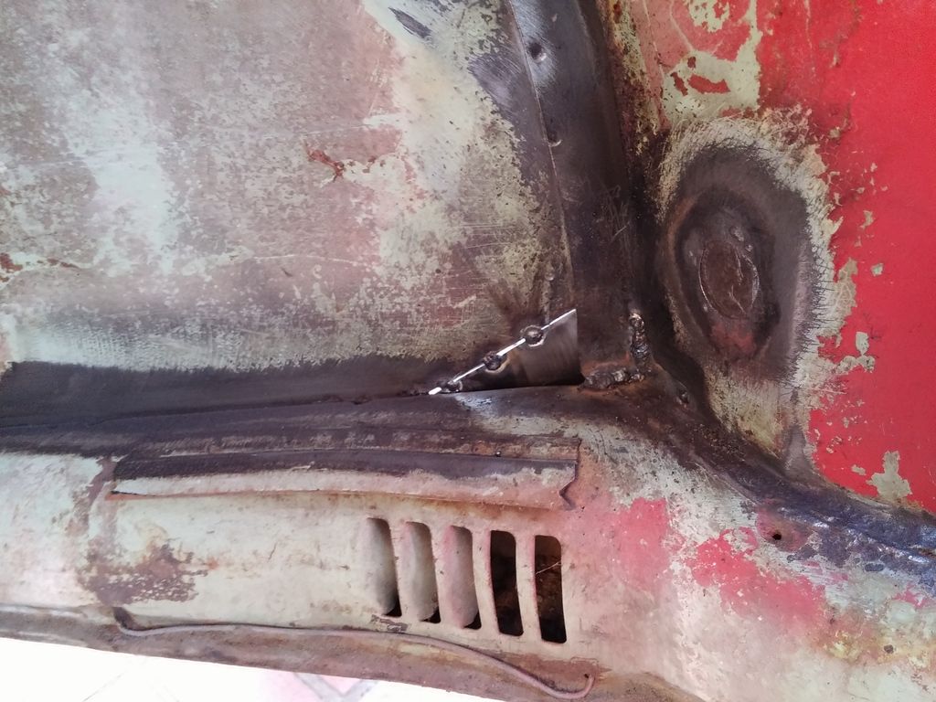

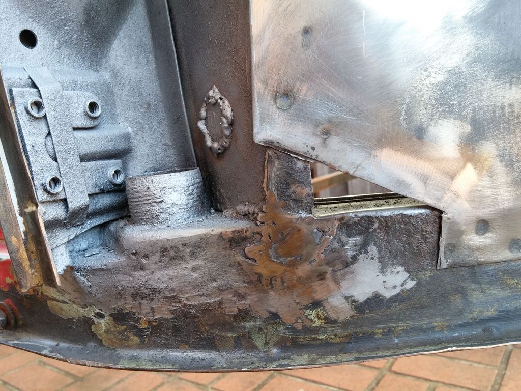

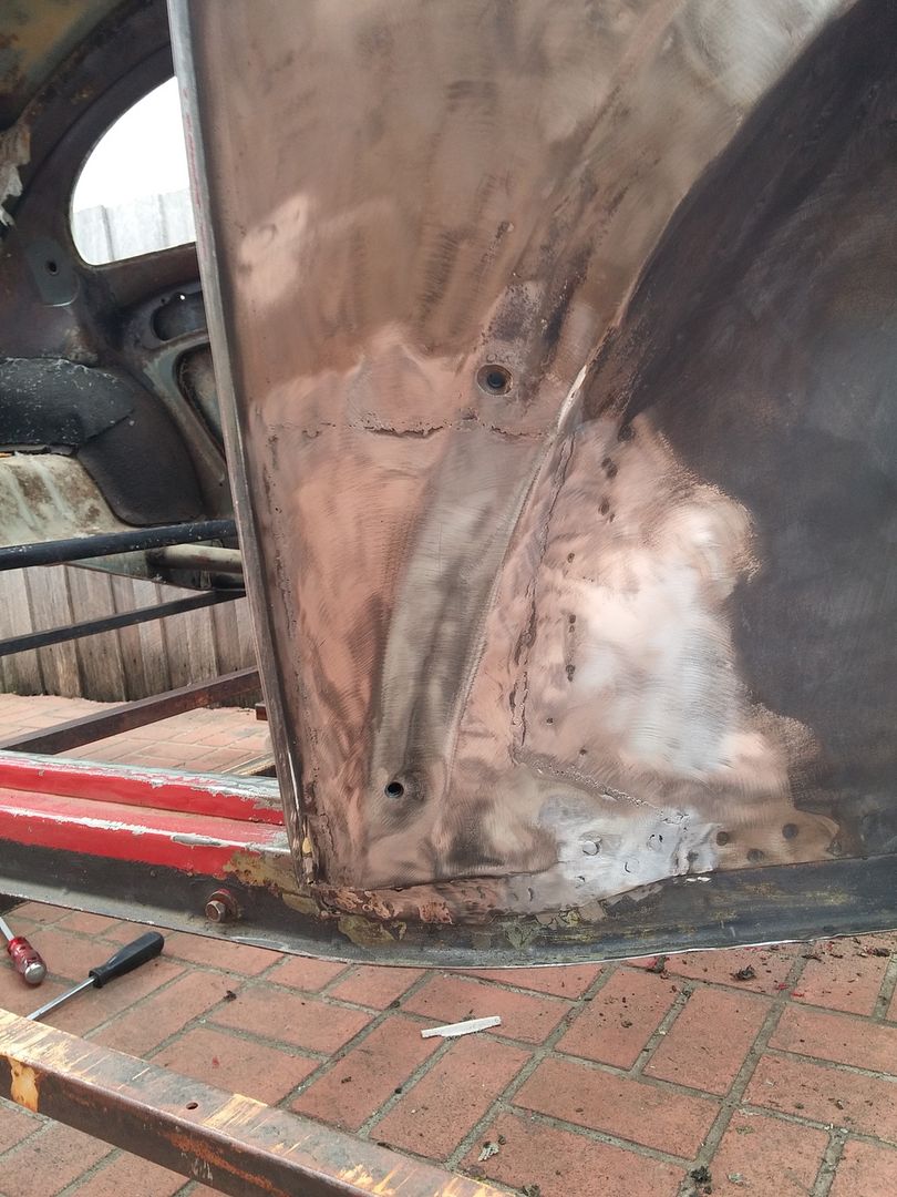

Finally cut open the passenger side rust area. A lot worse than the drivers side but I will fix it

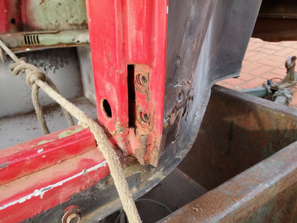

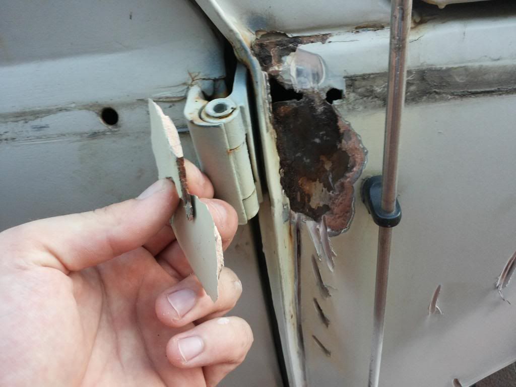

roofchop Seriously Crusin Dubber
177 posts · joined Jan 2011 ·
#1023349

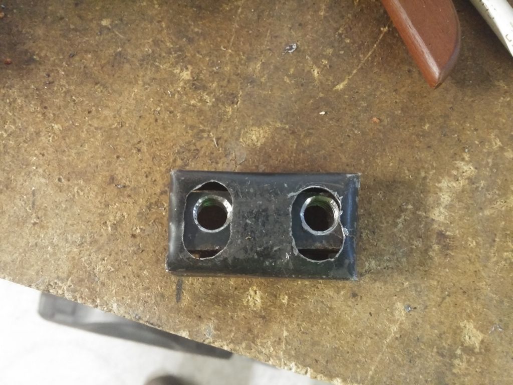

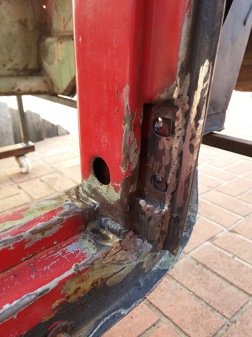

Nice work!

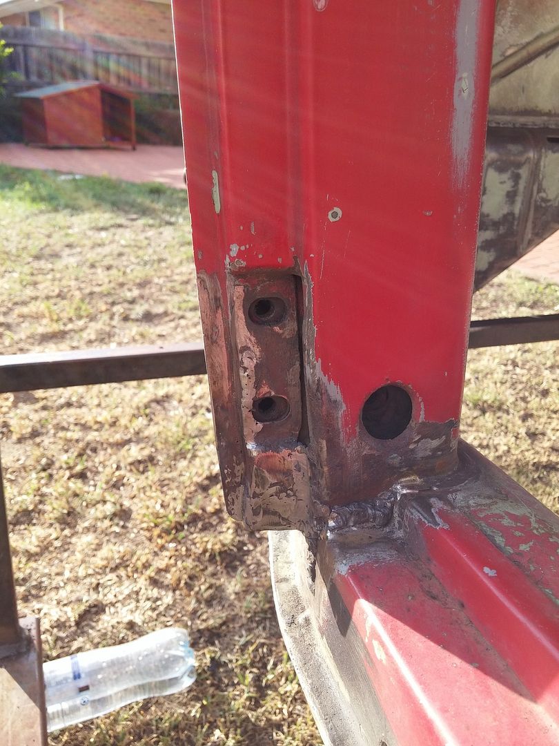

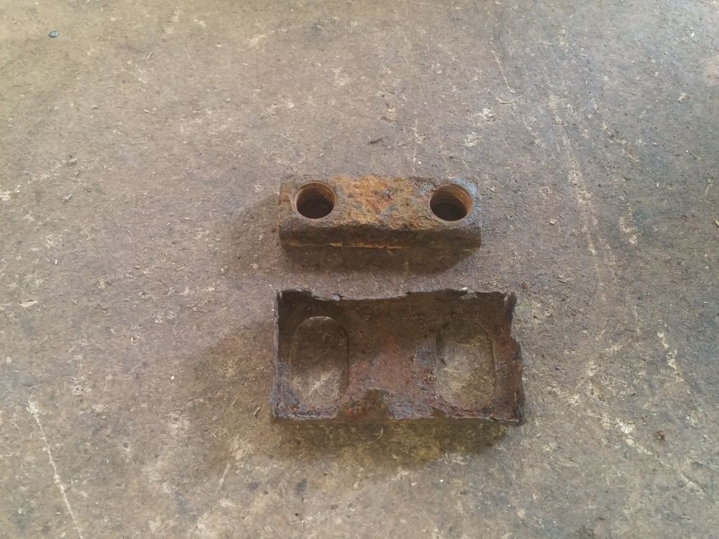

In that last pic, see the strap (just) holding the hinge plate on? Weld in a new one now...
Just had one break on me had to cut a hole to get it back in place!
Also run a tap through the threads, then you won't break the strap in the first place (like I didn't do!)

roofchop wrote:Nice work!
Thanks 👍 I made and welded a new strap as you said, the old strap pretty much peeled off with little force.

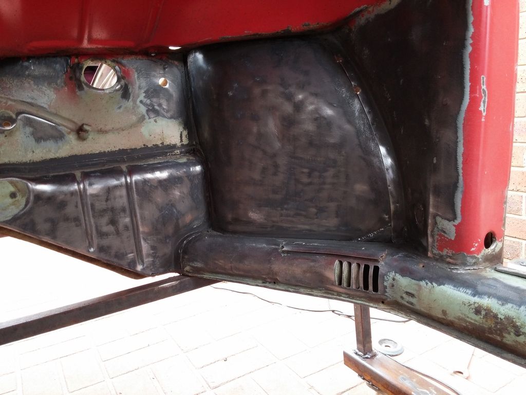

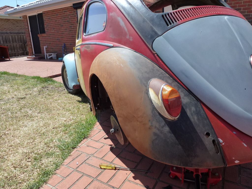

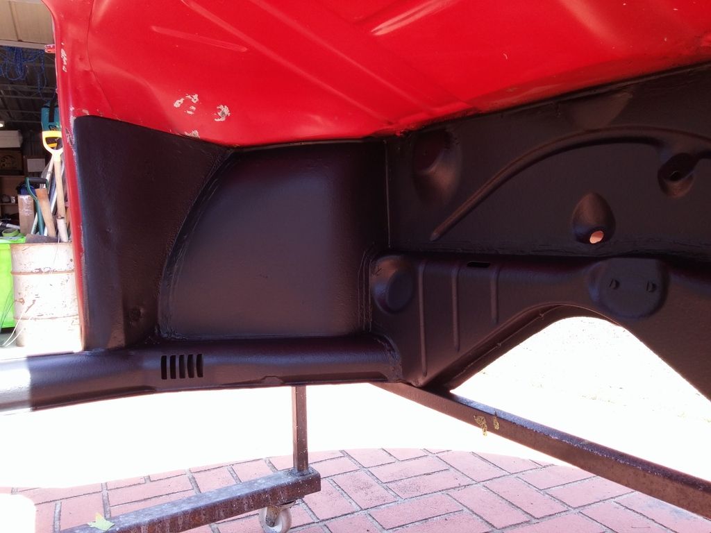

I have done a bit more work lately
Finished off the drivers side
Fixed the other rear bumper mount
Made an executive decision that the car will never have heating again
Filled the holes
The patch came out nicely

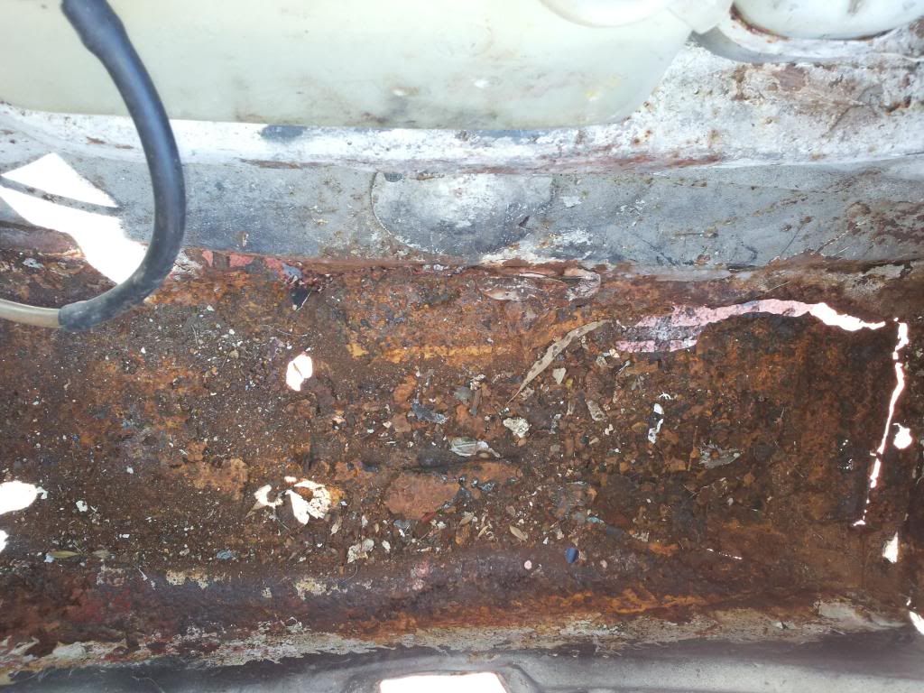

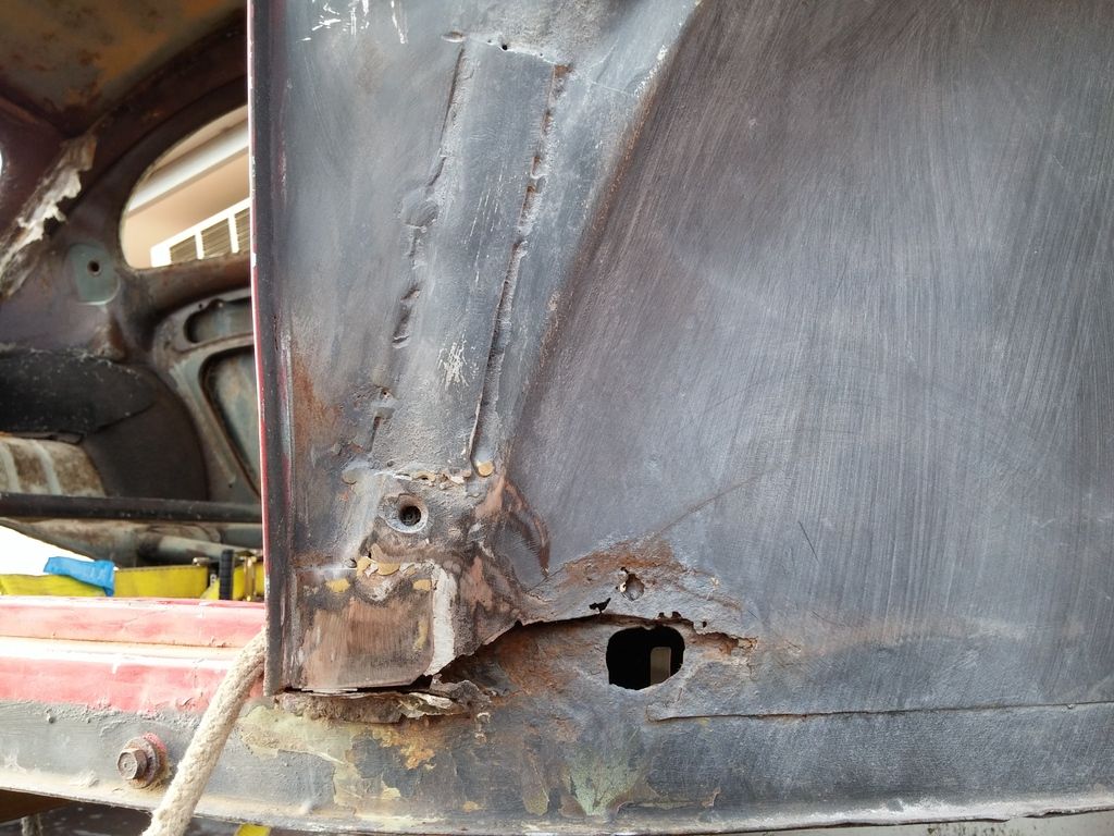

Just when I thought that I had taken care of all the rust on the car I started to clean up the bottom of the heater channels from old silicone and found that there were no front four body to chassis nuts. Cut it open and found some more rust. Had a go at making something up, hopefully it will work.
This was on the drivers side, there was nothing on the passenger side ❓

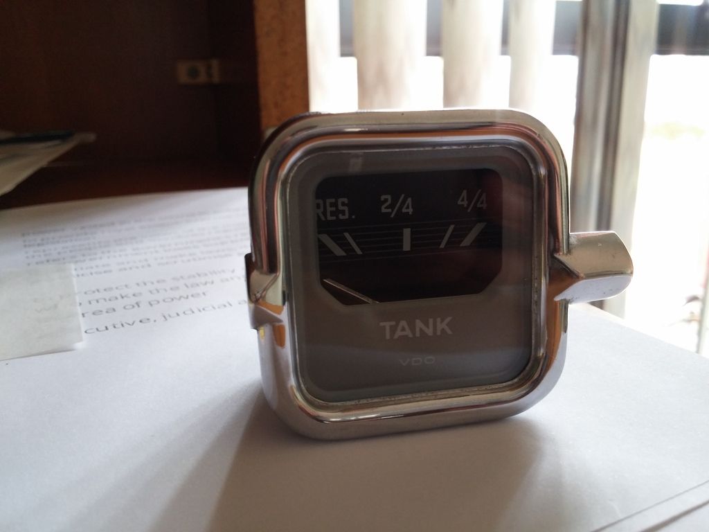

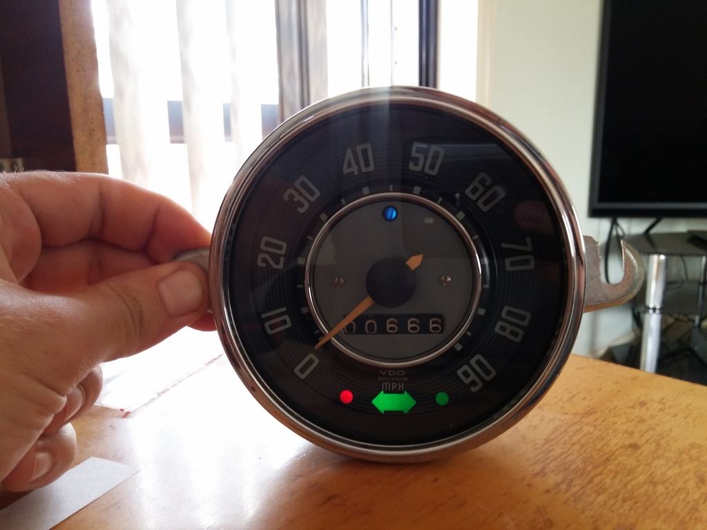

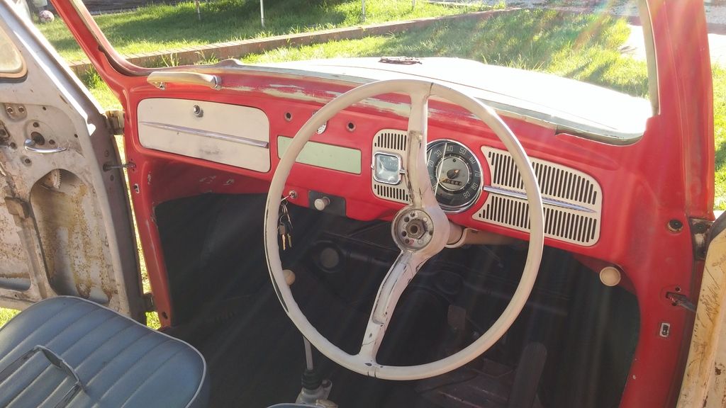

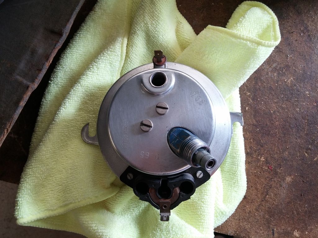

Cleaned up the speedo and fuel gauge, put in new gels and bought some new globes. I was surprised that Repco actually had them. I think that the speedo is evil...

Speedo looks sweet as! 👍

Last time I saw Bog like that was the C pillar of my Munro and in front of the windscreen on my tonner where they made the HQ shape into the HZ shape!

It had quite a bit. Personally I hate working with bog, it's a pain to get into shape and is a bit messy. My idea for the heater channels was that if I seal them up and prevent any moisture from entering them then they should last a lot longer, and since I have j-tubes I won't have heat anyway.

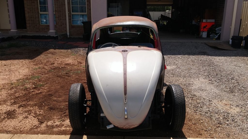

I managed to get some more work done to it:

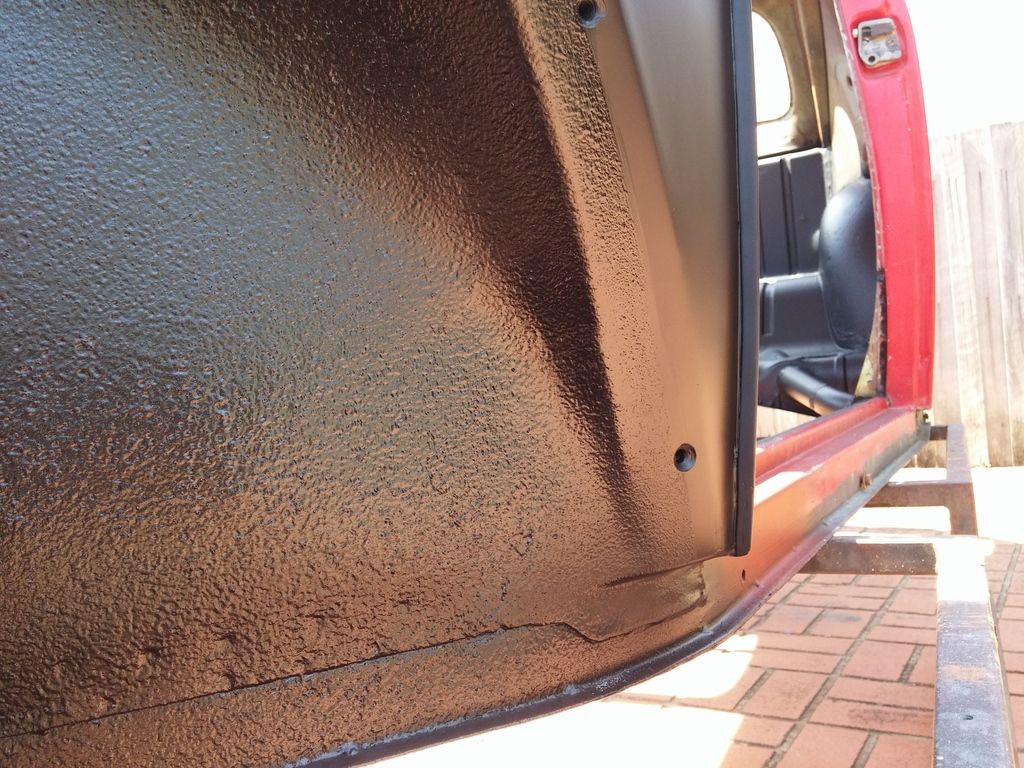

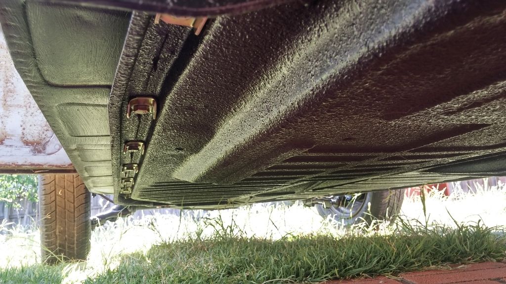

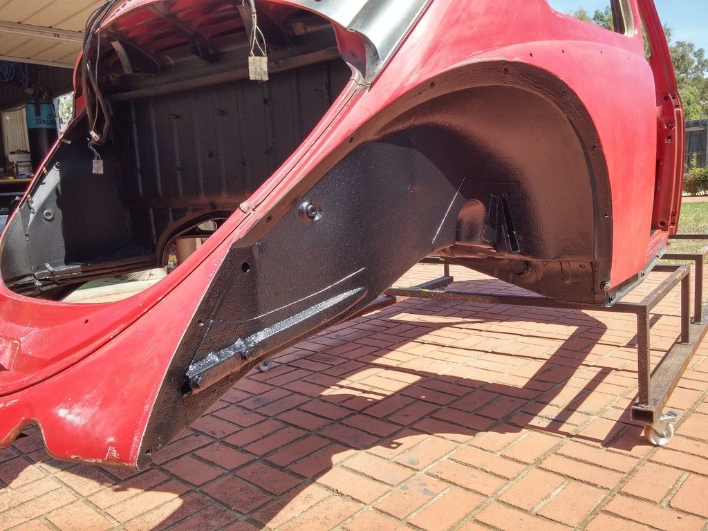

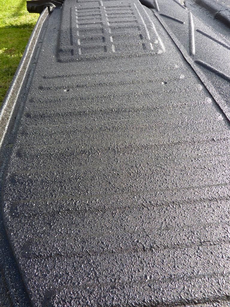

Finished up the rust repair and went to town with the stone guard
Sealed the front apron
Put some filler and paint on the rear apron

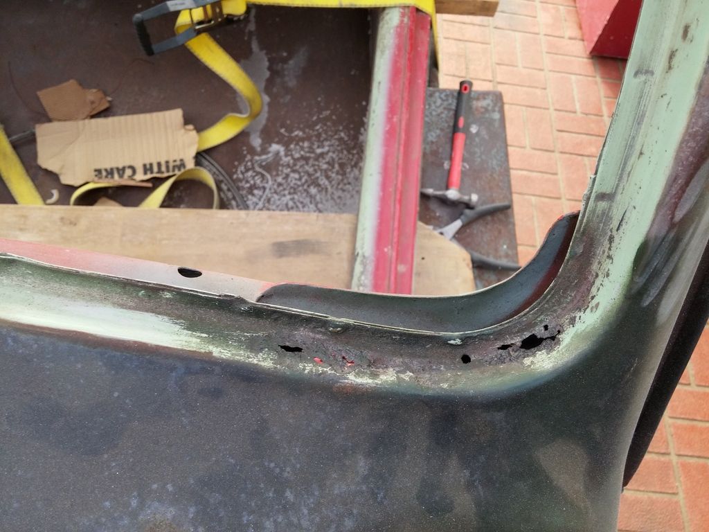

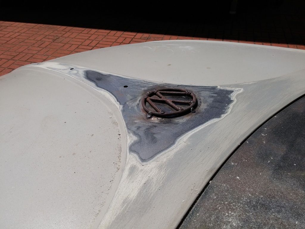

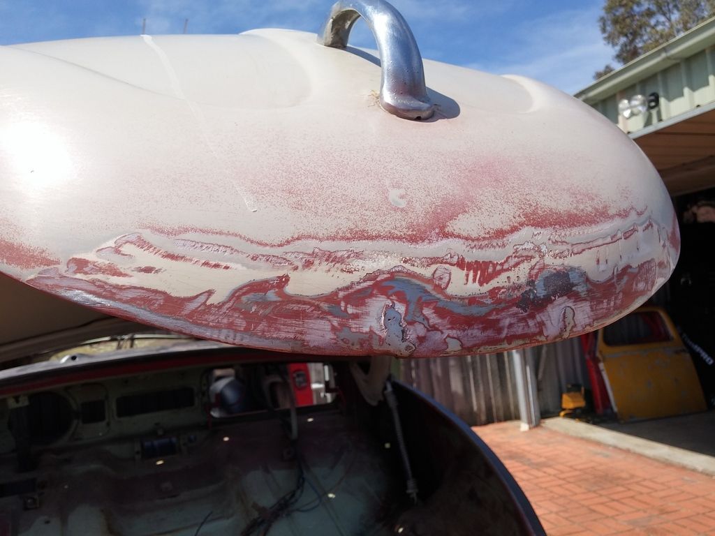

Also fixed the front lid, had a few rust cracks I welded up. This is the lid from the original white Beetle, funny seeing the different layers of paint it had through the years.

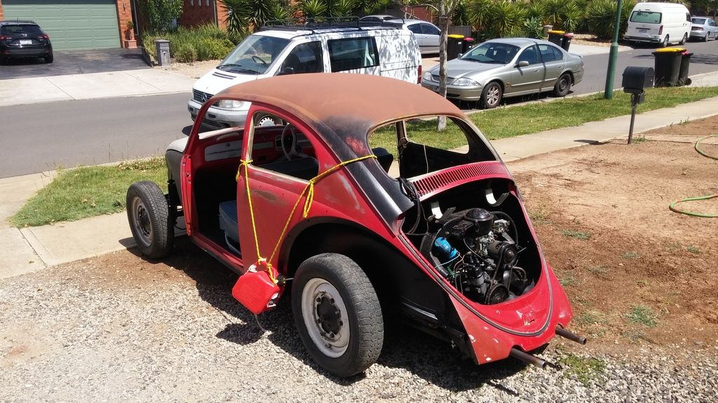

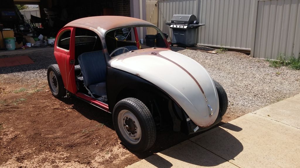

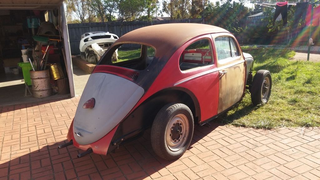

Done with uni and the weather is looking up, finally getting some motivation to finish the bug. Got around to putting the body on the chassis.

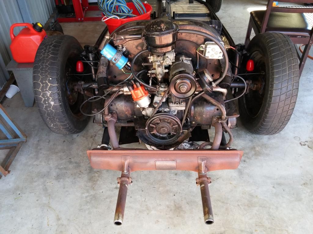

First time this body has been on this chassis.
Changed to oil in the engine, primed the carby and is started right up 😁

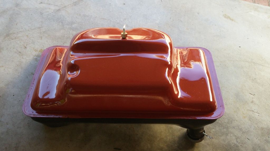

Got a few more things done.

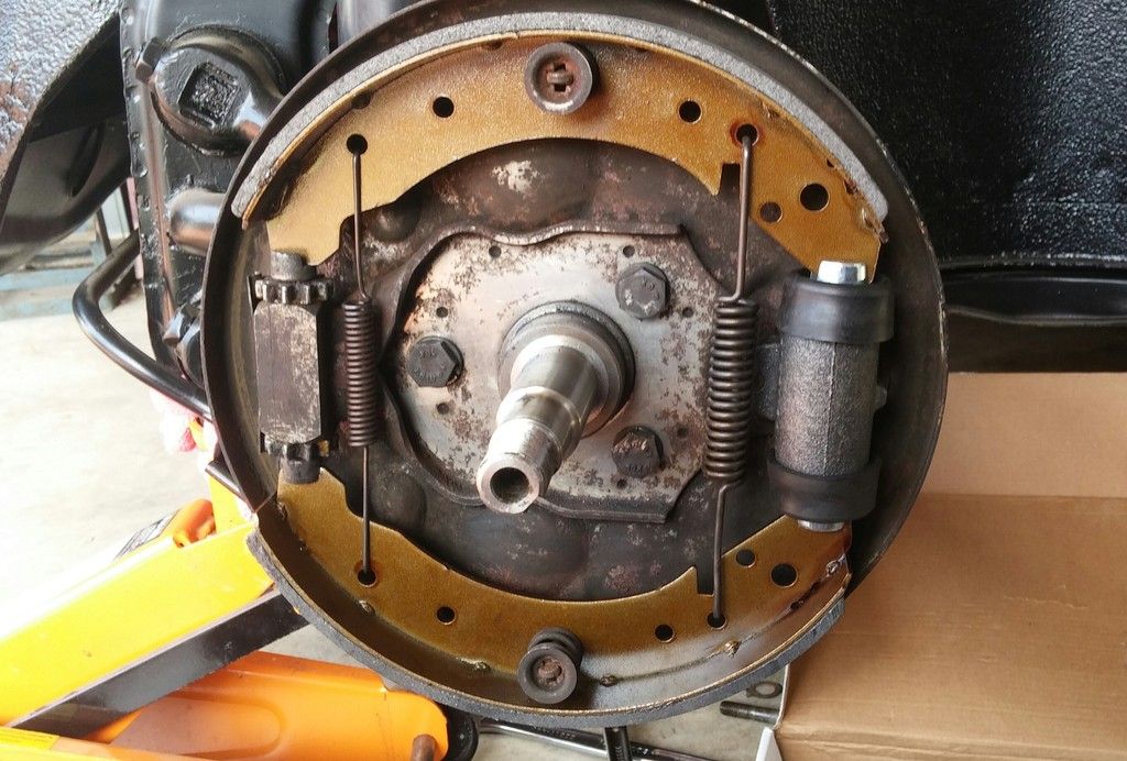

New front brake shoes and slave cylinders, as well as new bearings and seals

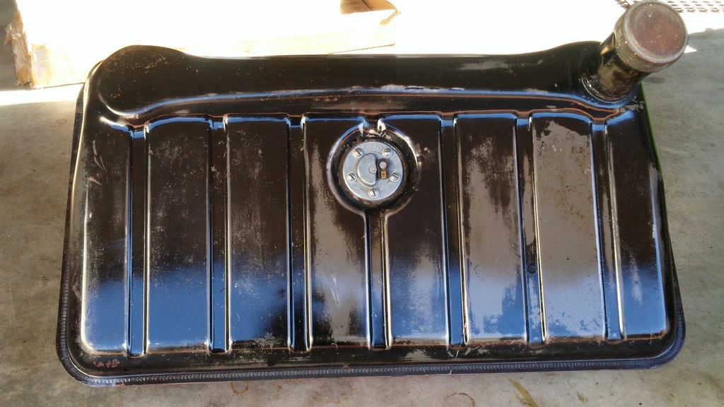

Gave the fuel tank a coat of paint and a new filter. I scuffed back the top and just gave it a clear coat.

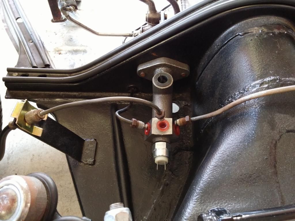

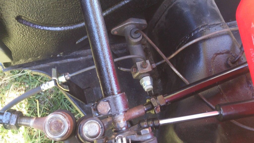

New master cylinder

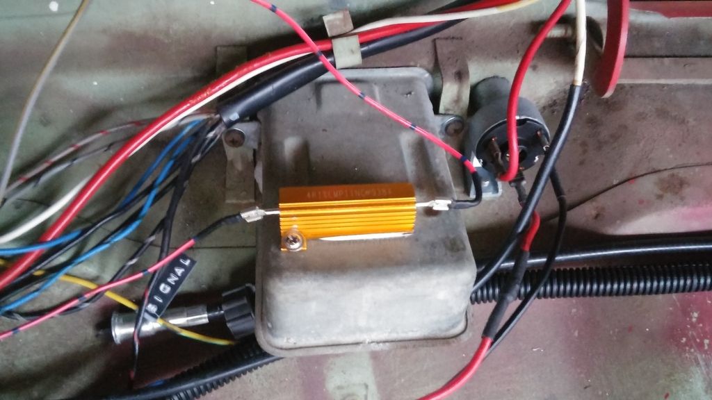

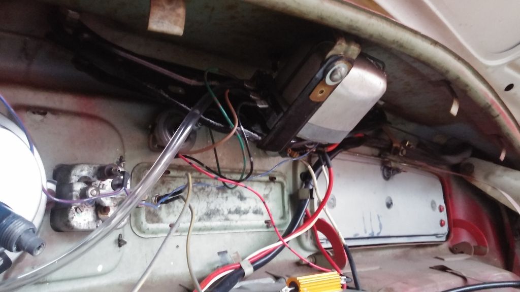

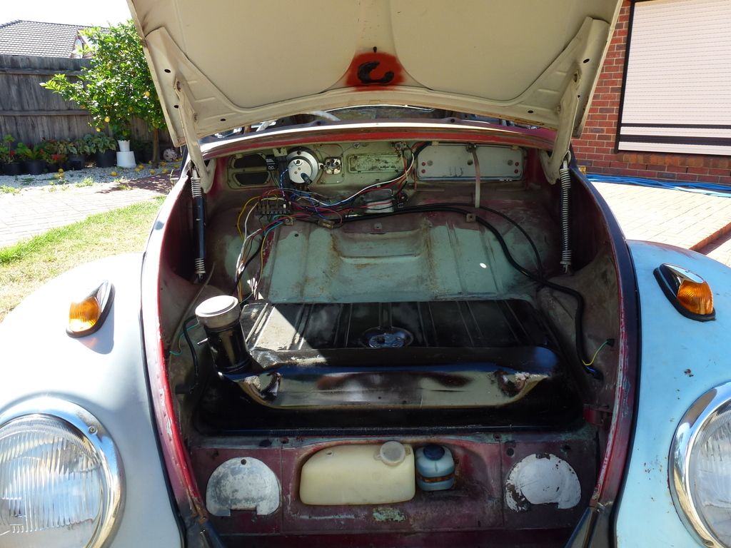

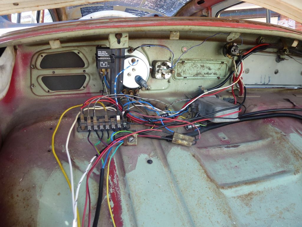

Wired up the ignition and cleaned up the wiring
Put new rubber seal kits on the doors and also installed the decklid

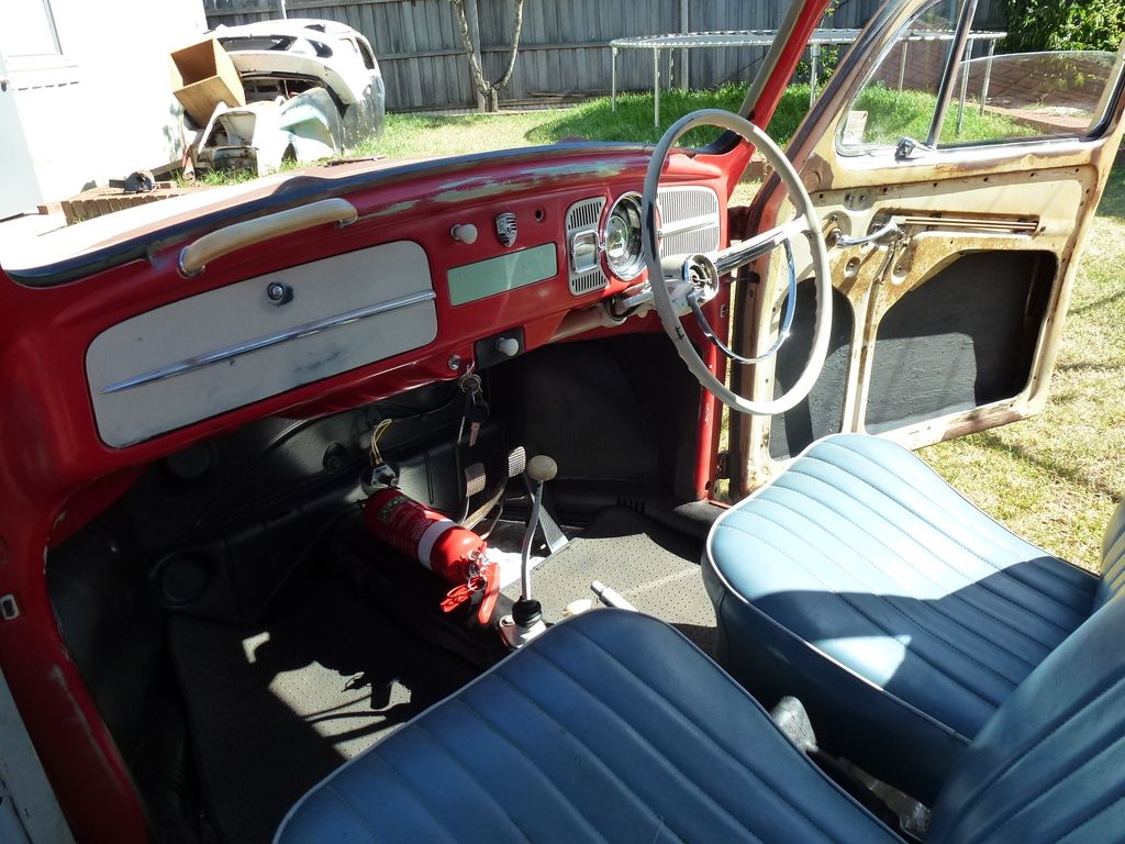

Dash bits installed

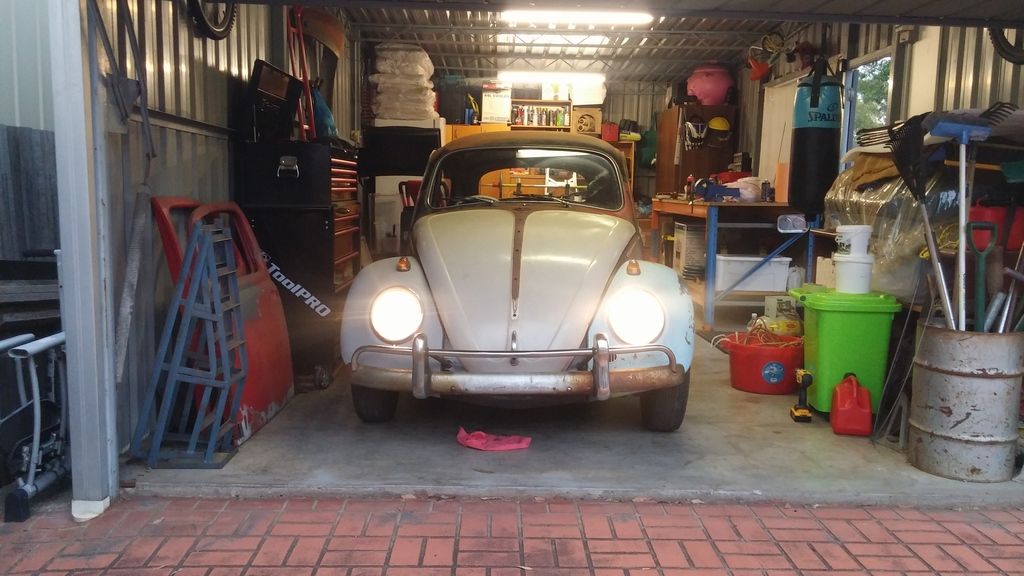

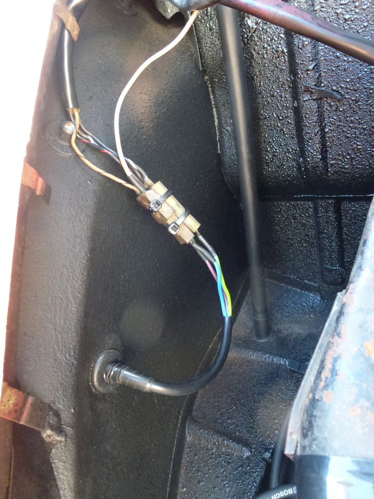

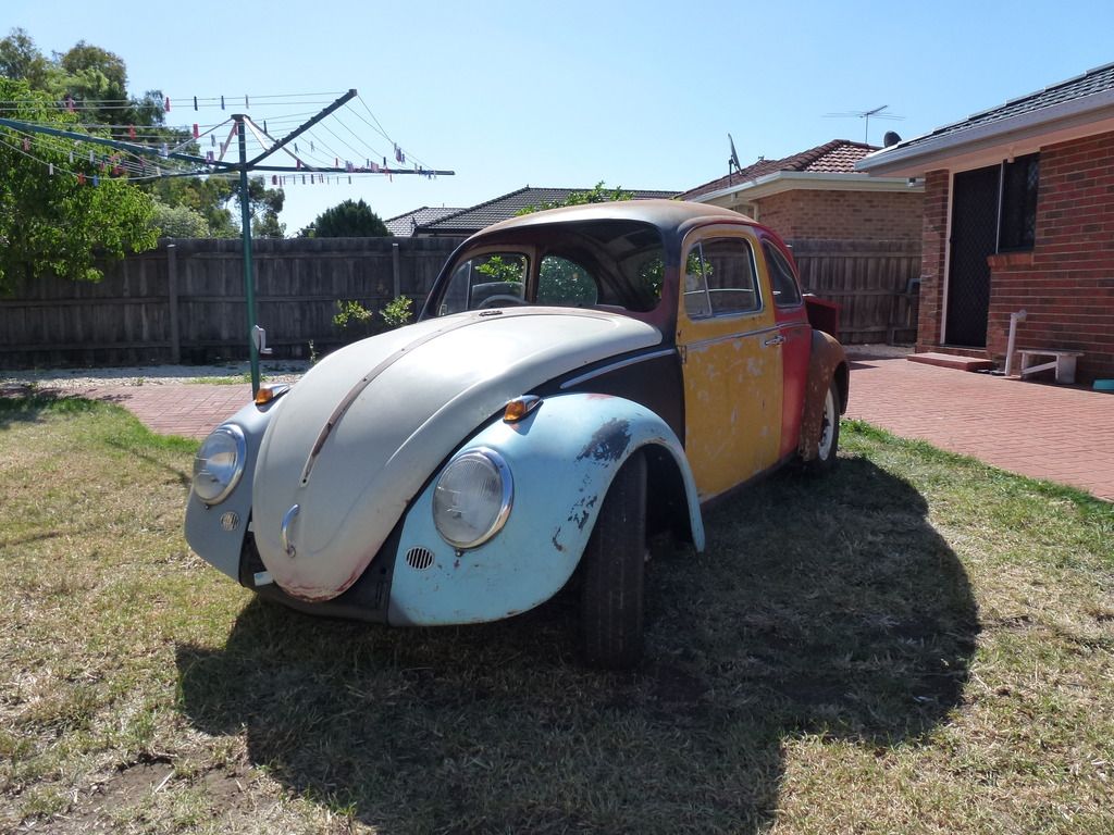

It's starting to look like a Beetle again! 😀

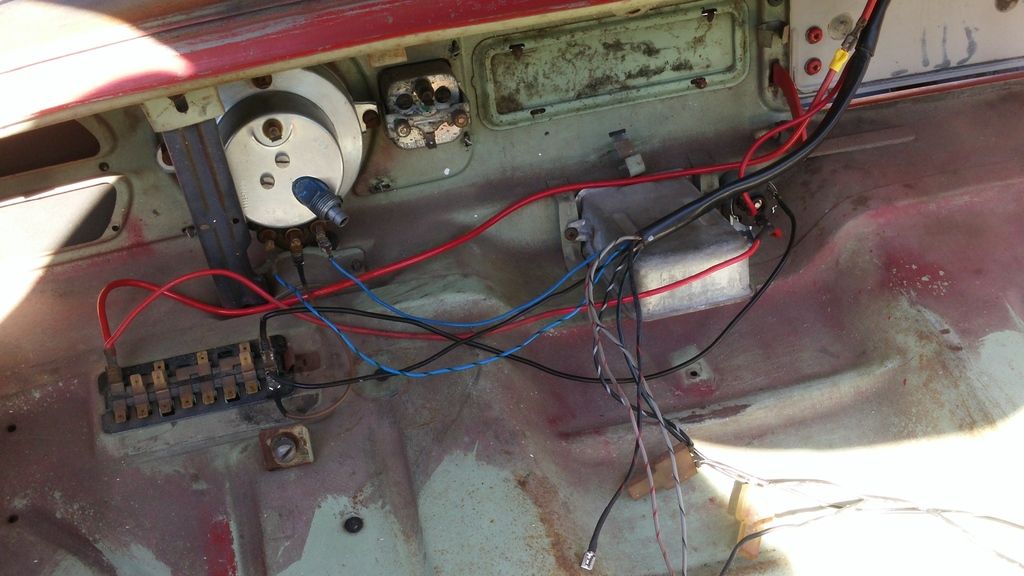

Wiring took some time, I found the easiest to use was extension cord. Has three wires in it so its perfect for headlights and tail lights. Cut, strip, crimp, solder, heat shrink and repeat 🤪

Looking Good. I agree with Rob on the colour scheme.
Someone is bound to tell you off for using extension cord. Don't worry too much, my spotlights on my last 3 utes have been wired with it. The in tray plug in the last 2 have been too.
If it works why worry. Its cheap coz there's always an old one laying around and the outer casing is pretty damage resistant.
Really? What is the reason not to use it? It is pretty much the same gauge as the original wiring and I just presumed that if it is good enough to be used in a house it is good enough to carry 12v in my Beetle 😵‍💫
Yeah I have an abundance of spare extension cord so will be easy to rewire in the future hahah

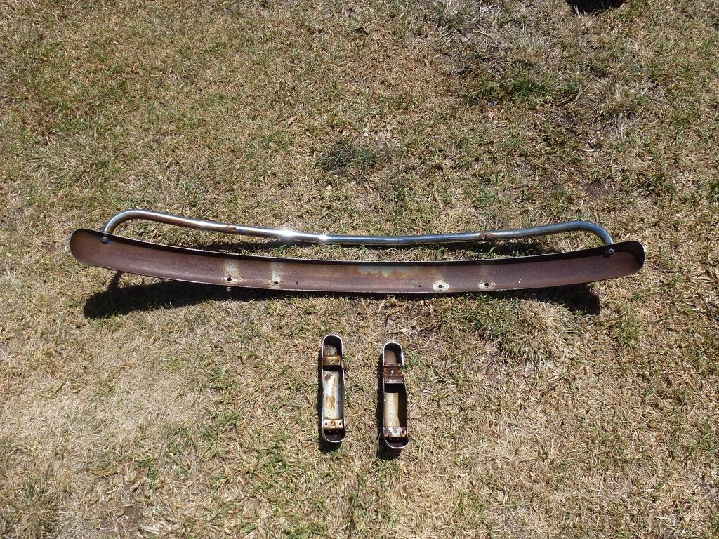

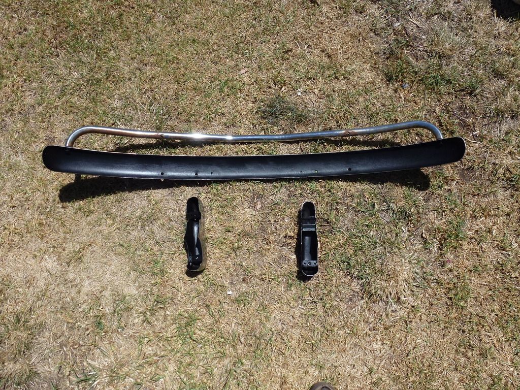

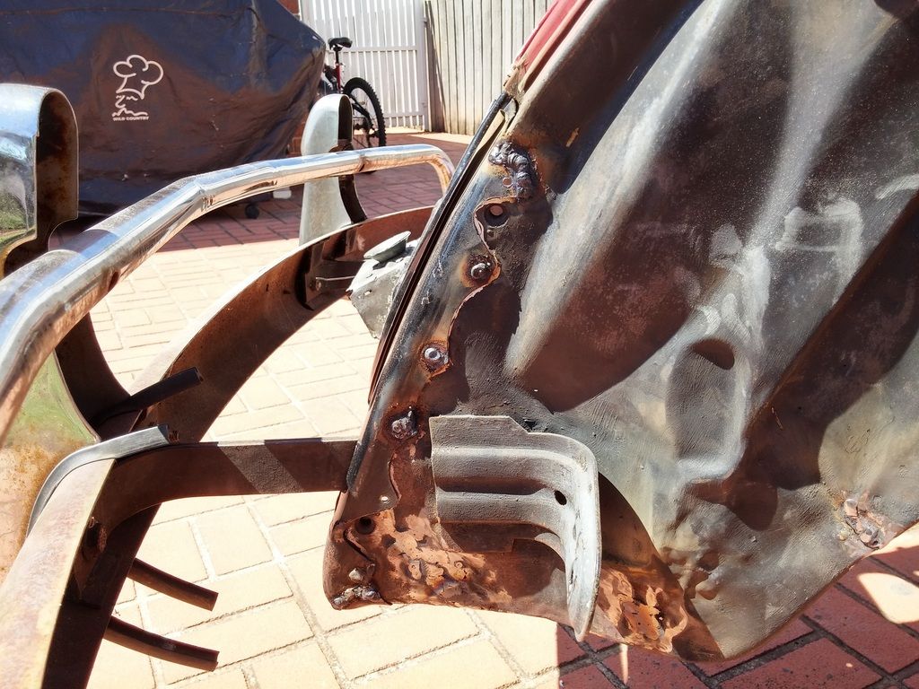

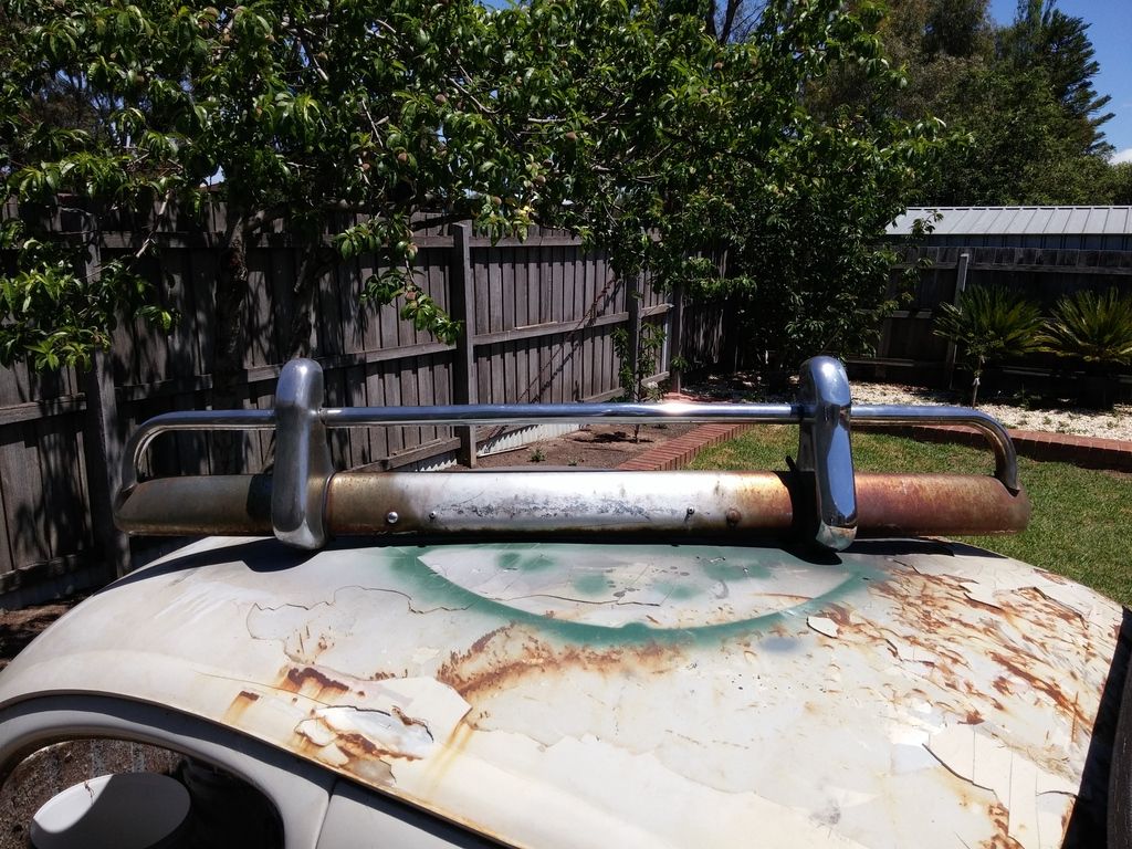

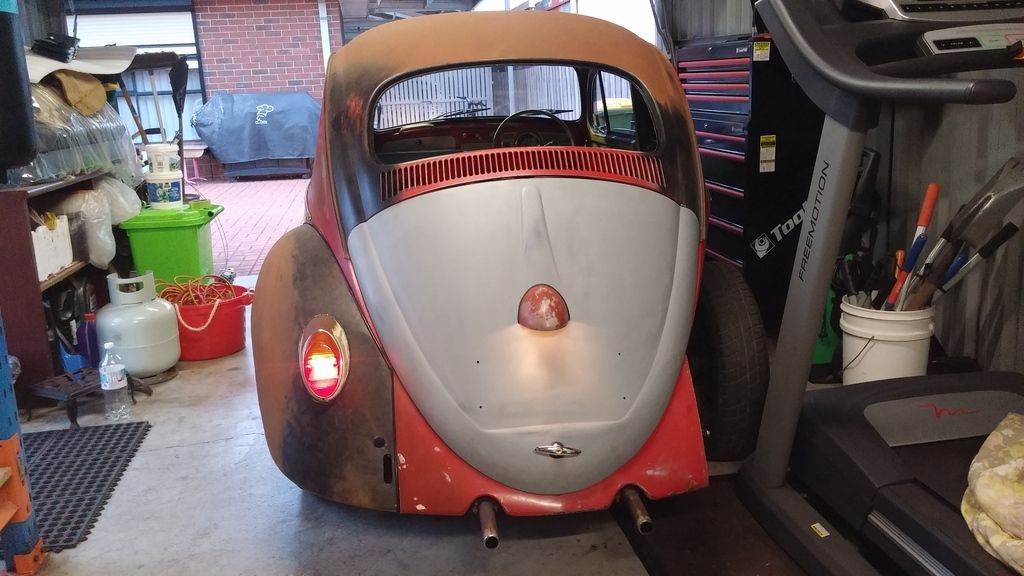

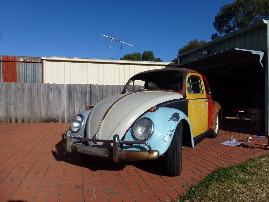

Today I worked on the front bumper. It has rust on the inside which I didn't want to get worse so I just cleaned it up and gave it a coat of Rust guard.
Wired up the lh rear
And installed the lh running board. I bought new genuine VW running boards. It took longer than it needed to install since all 4 bolts broke off from the original running board. So had to drill and tap new holes. The boards came with late trim so I will need to buy some early trim clips later on.
Front bumper installed

Installed the windshield, wipers, and washer pump. I had to use a voltage dropper for the wiper motor as it is a 6v unit. I tried it with 12v straight but is was running really fast and would probably burn out the motor pretty quickly.
All the wiring is nearly done, just the dome light and rear right brake light and signal.
