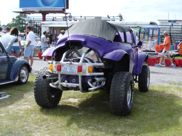

So are you guys saying that this might not pass??
http://www.thesamba.com/vw/gallery/pix/174070.jpg
:thumb

posted on October 2nd, 2004 at 09:51 PM
Now that is how they should be :thumb
